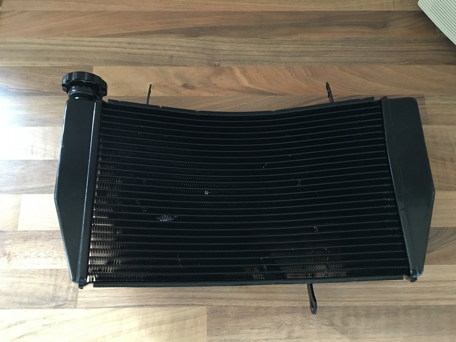

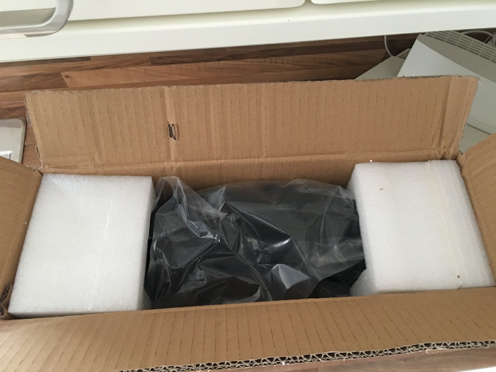

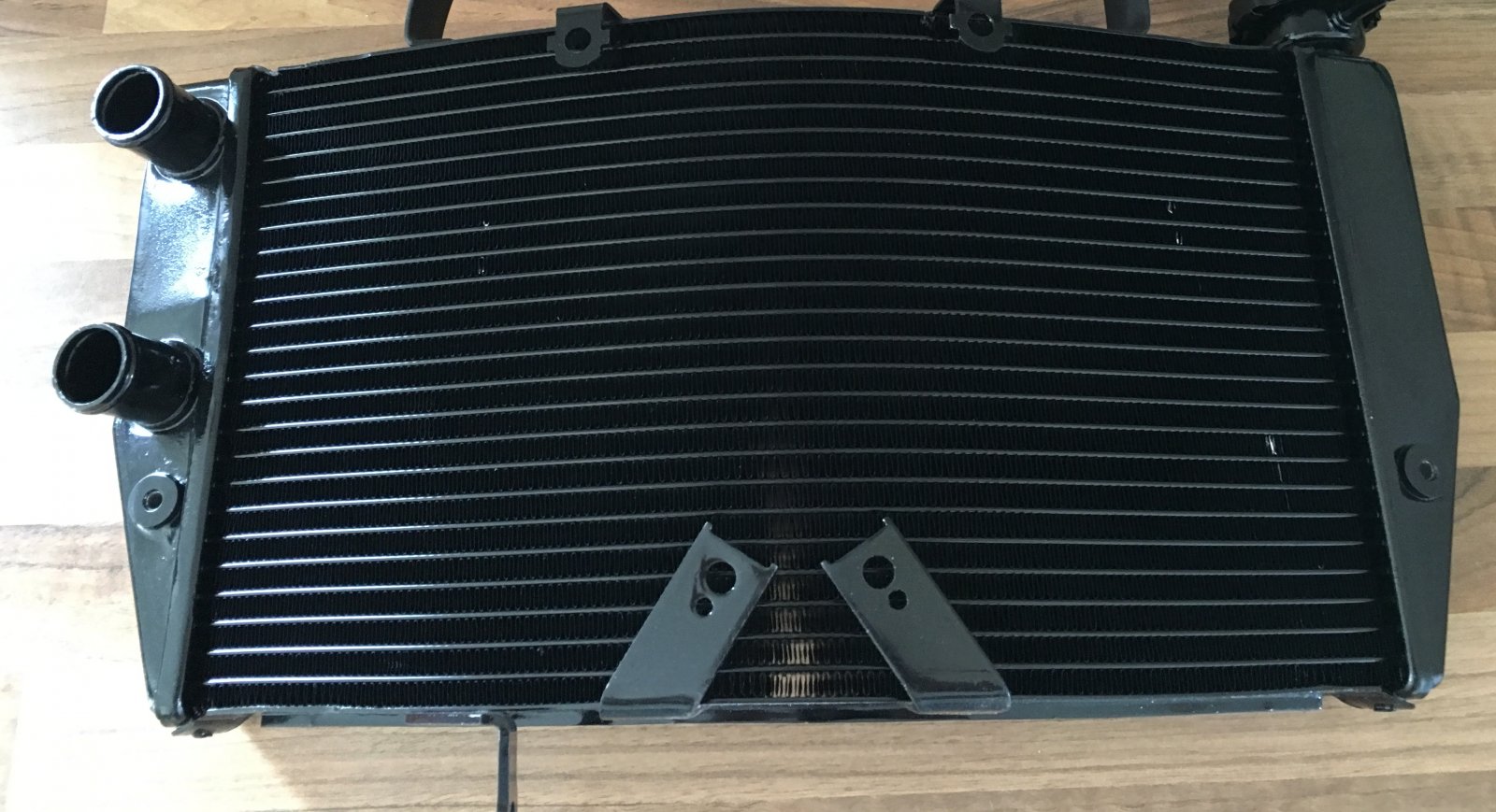

  10. Well for £56, it's not bad. Time will tell if it leaks like a collander. I'm interested to see how it all lines up.
    Packaged OK. There is some slight damage to the fins on the front in a few places, but nothing that won't straighten out and flash over with a black aerosol. If it had been from a Ducati dealer, I'd have thrown it back at them and insisted on a perfect one, but you pay your money and takes your chances.
    I'll try to get some pictures side by side of the original that I remove this week.

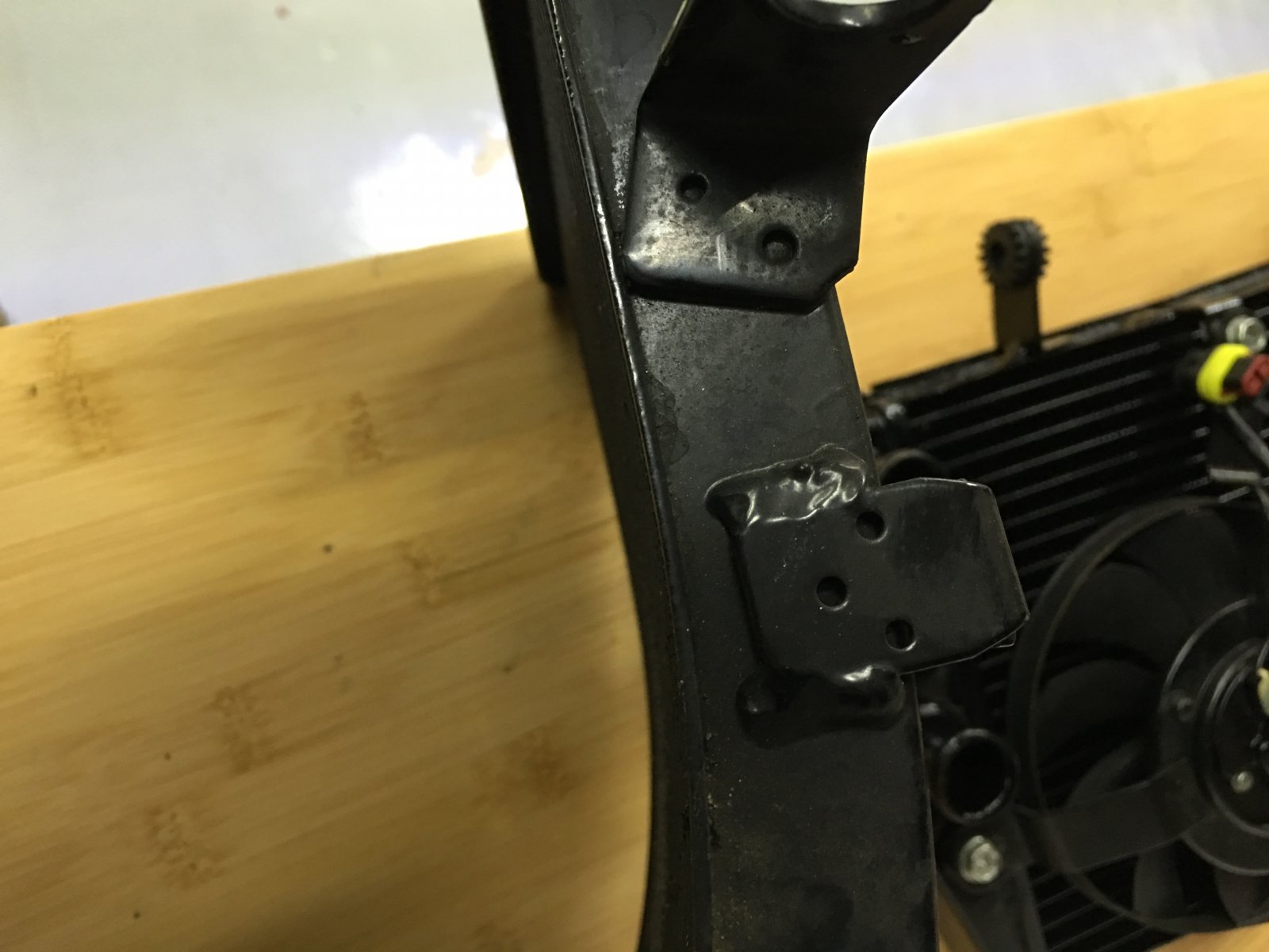

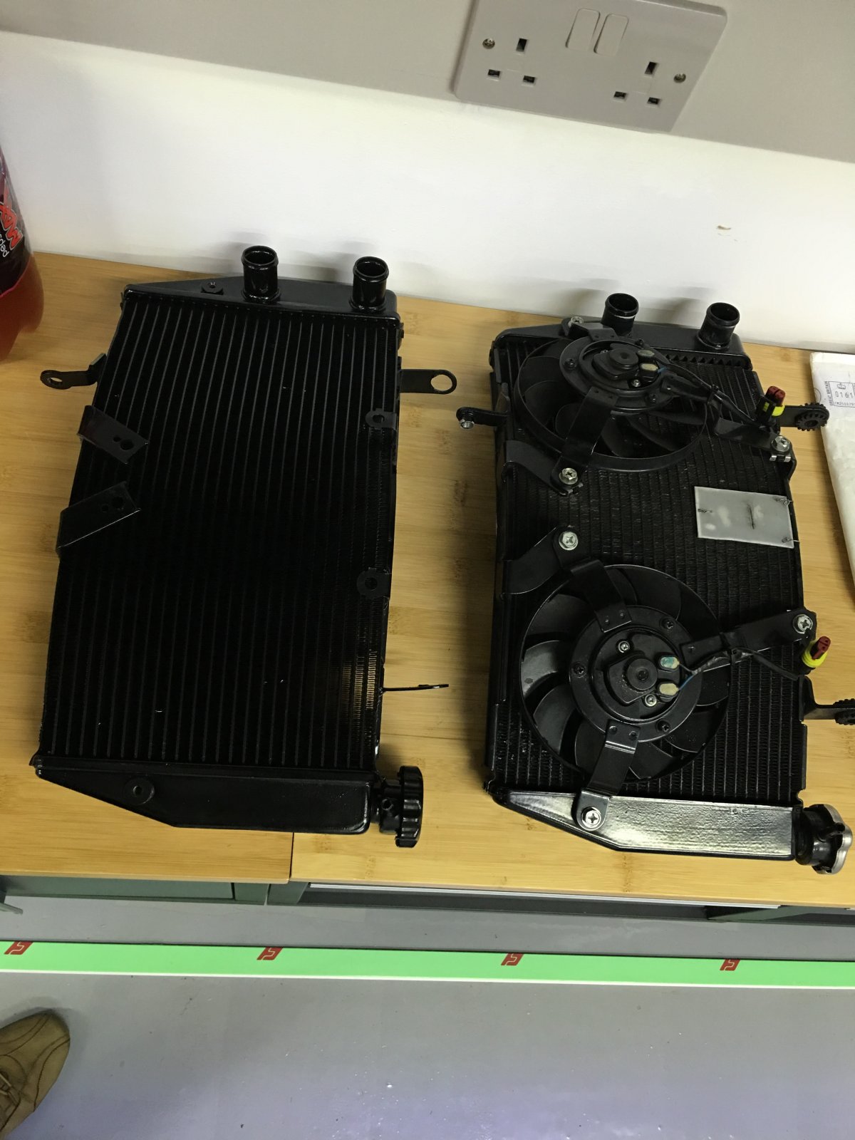

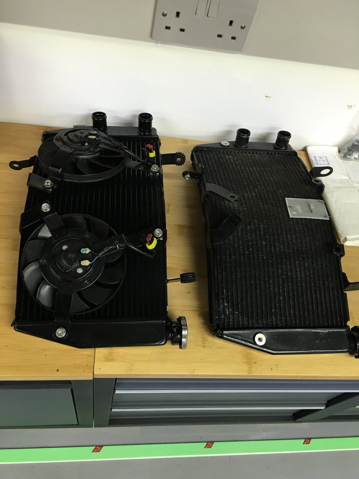

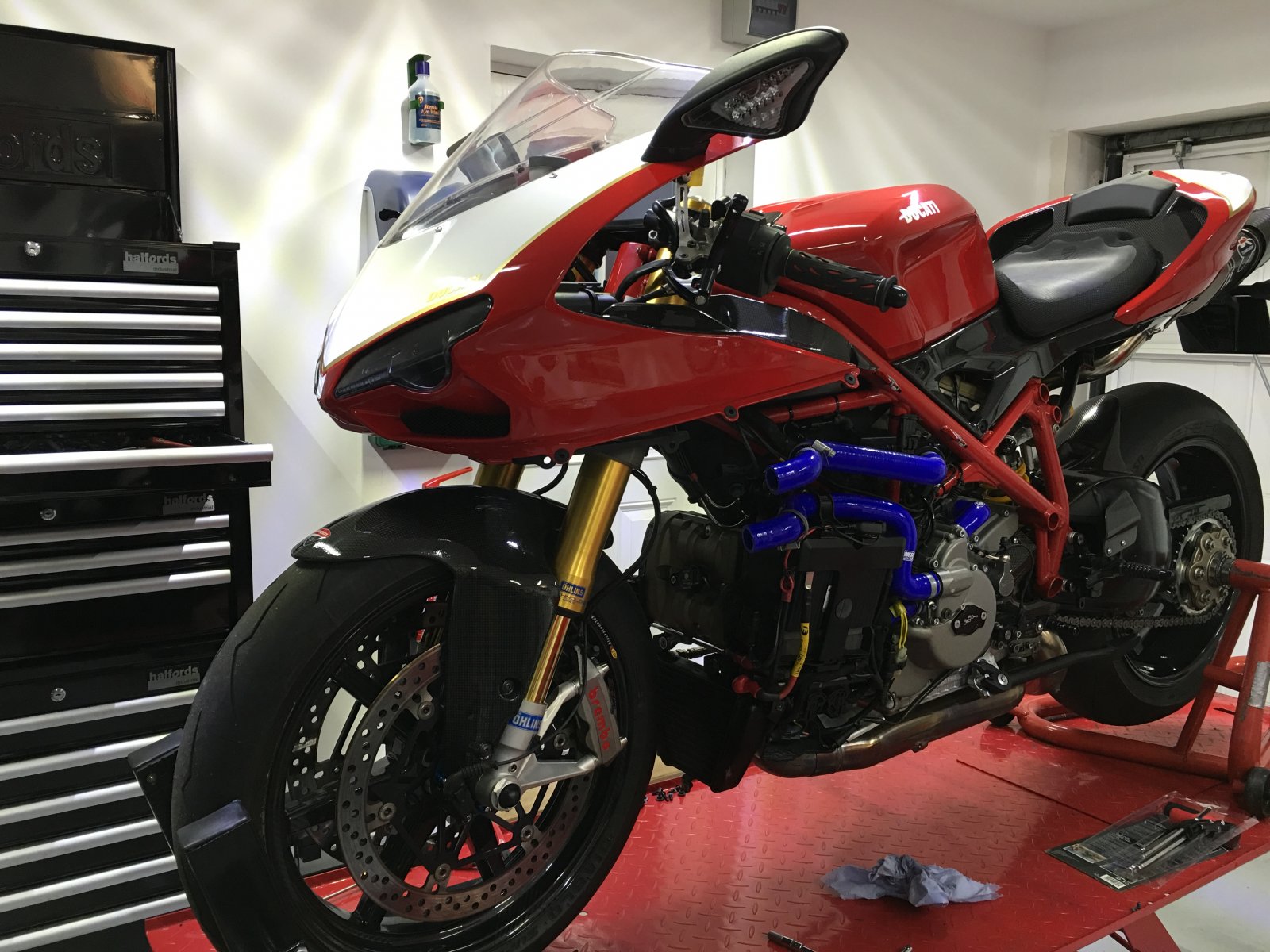

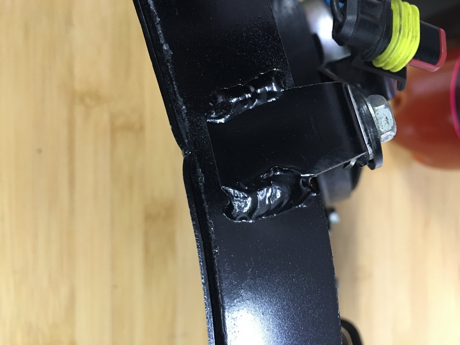

  18. Well, it kind of got the better of me and I thought I'd at least get the old rad off this evening.
    The Chinky rad is definately little rougher around the edges (but not much), but hey, I couldn't knock one up and post it for £56.
    All of the accoutrements are fitting to it without any issues. I'll stick it in tomorrow and see how it goes.
