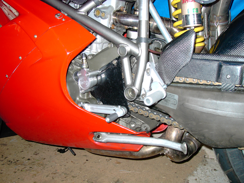

  4. Remove the short lever attached to the gear change output shaft, turn it through 180 degrees and refit the linkage to the lever.
    Like this;
    [​IMG][​IMG]

  6. Should all fit, you may have to adjust the linkage lengths and maybe experiment with the spline position of the lever to get the correct lever position and smooth operation.
    Alternatively fit a direct lever which eliminates the linkages, like this;
  7. I'd put a direct gear lever on as the pic above, but note that it will foul the bellypan on an 848 so you may have to mess about a bit. But if you just want to try it first, spin it upside down like the first pic
