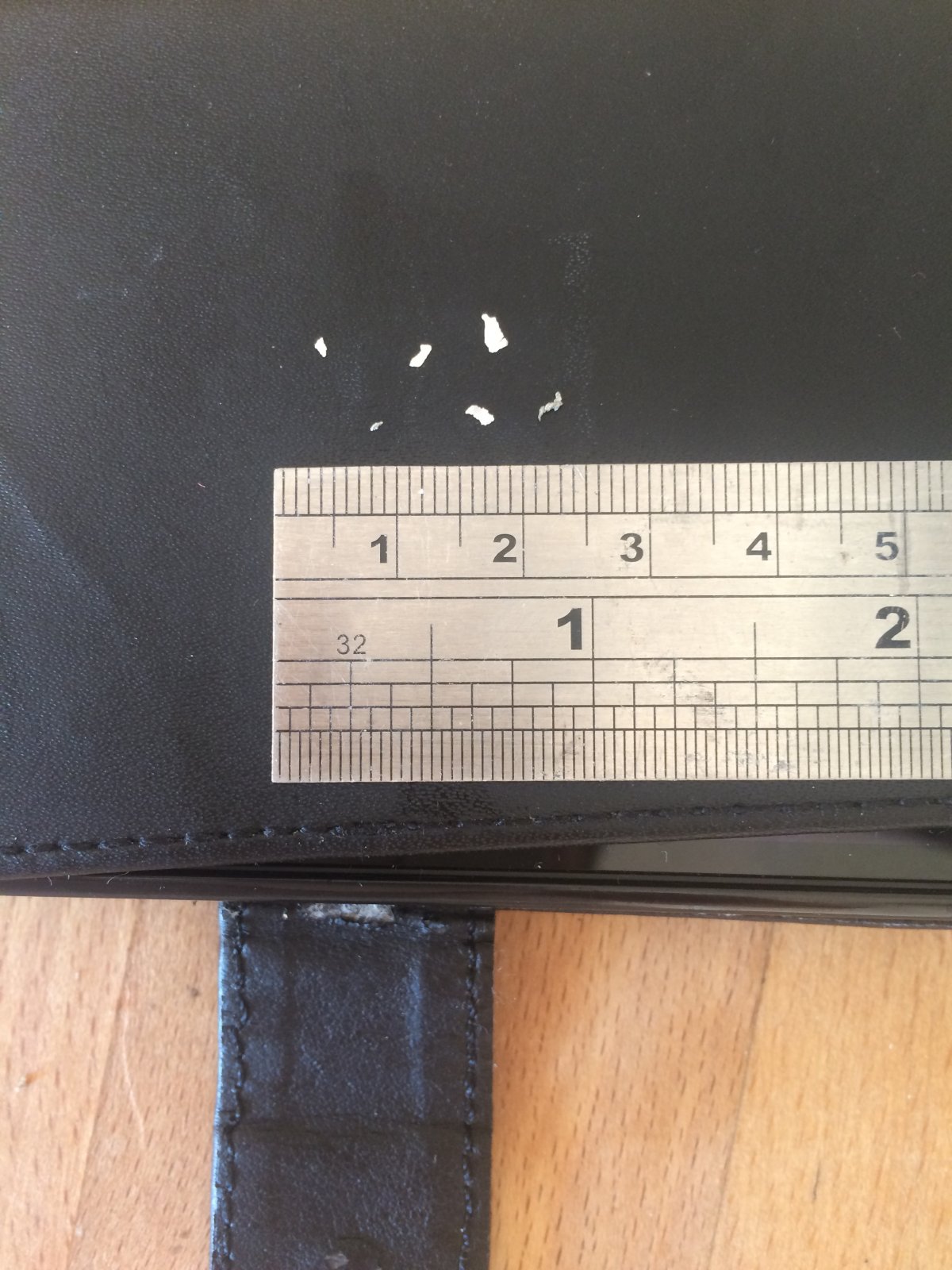

  1. Got the oil filter off after a bit of a struggle and did my service but oh bugger found some small flakes. Reckon there was prob double the amount in picture, just had top end service and rockers checked and was told that one was a tad marked but not on the working area...can you take the mesh filter out without a complete drain of the oil, if so I could at least keep an eye on things image.jpeg

  5. They've just been checked though so maybe it's from something else? image.png

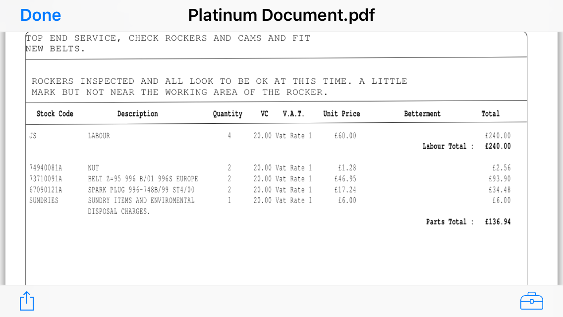

  10. Yep he checked valves and said all ok, mileage is 11,300 had a bit of service history, the 6k done at Baines (had a rocker then) that was 2005 though.
  11. How many did you need and how did you discover you needed them ?
  12. I discovered I needed them by Geoff at Baines calling me up.
    I had flakes like yours in my previous oil change though on the strainer.

  16. i dont believe the OP had it checked recently?
  17. No I did not get a chart, just the invoice, reason I took it to St.Neots Motorcycles is because I had heard on here they were very good. I don't (obviously) want to shell out again and have it rechecked but I suppose I'll have to. I could take it to Baines but bit of a hike for me, plus should I ride it after this discovery?
