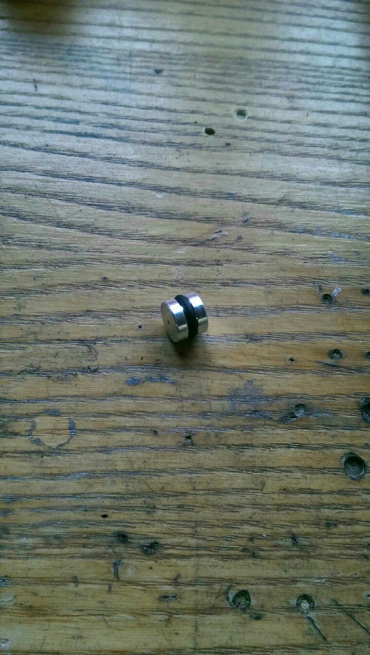

  9. [​IMG]
    That's the spacer. If I put that in it would push the plate away causing constant slip wouldn't it?
    New clutch fluid.
    It's a "factory racing" unit.
