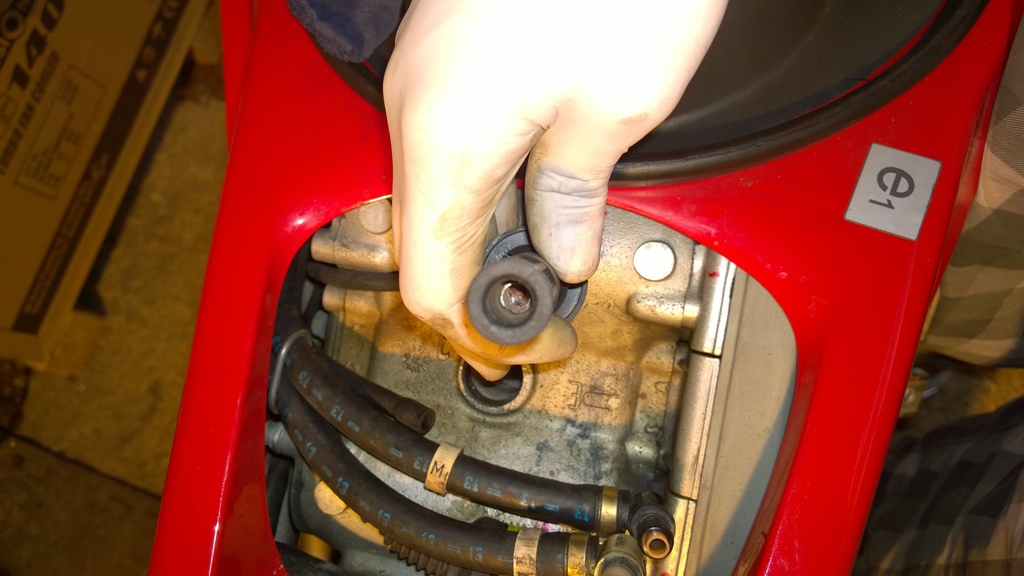

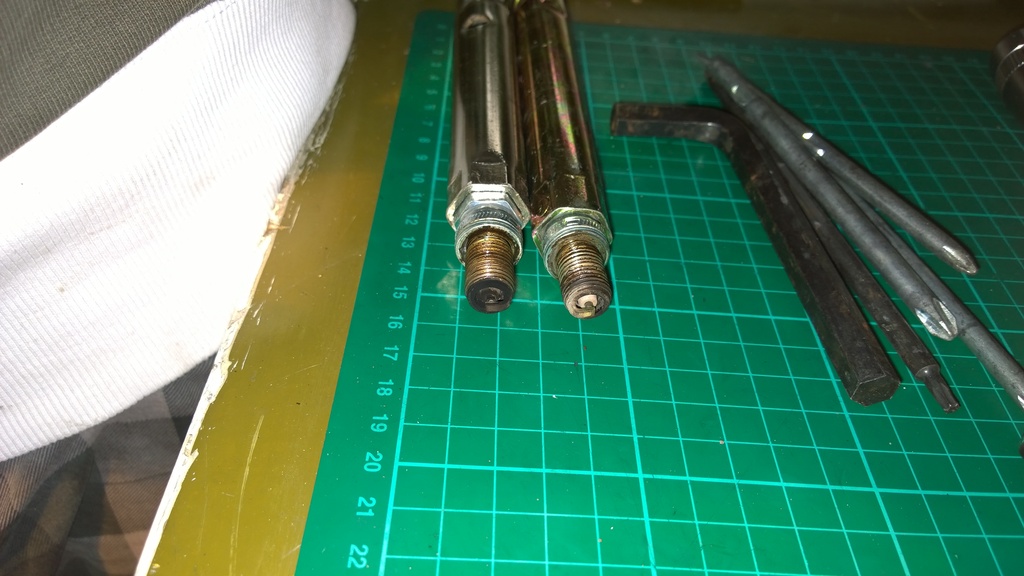

    today I decided to take a look at the plugs, and did not really like what I found:
    I headed on to checking the throttle bodies, especially on the vertical cylinder (the one where the dark plug comes from) and here's what I saw:

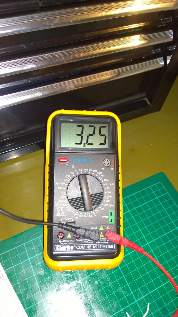

  2. As I wanted to make sure there was no problem with the coils I went on and checked the primary winding resistance, the manual states 495 to 606 ohms at 20 degrees, I had 1,5 (200) on both coils, but again I am not sure of the settings on my multimeter (see below)
    as well as the secondary winding resistance, for which the specs are 6-66 to 8.14 k-ohms at 20 degrees, and my tester showed 3.25 on both coils (see below)
    ...what am I doing wrong? why everytime I have to use the multimeter I always have weird results?

  4. looks like you have it on the wrong setting for the primary. put it up to 2k. always check you leads before you start also. touch em together. make sure getting pretty much zero.

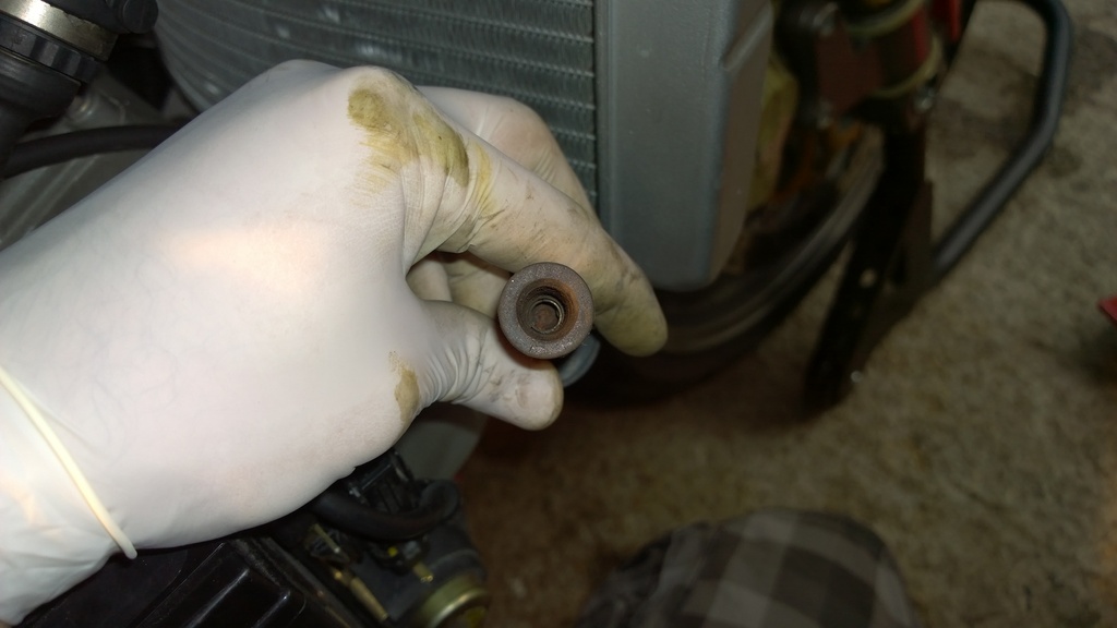

  5. If that's corrosion on the HT terminal inside the plug leads throw them away. You can clean them up but personally I like ht leads and coils to be pristine.

    Touched the leads, all good. If you set it on 2k you'll have a lower result, but it won't get nearer the specs.. confused
  8. I would probably replace them myself .. I was actually about to order them yesterday night but then I thought I'd wait for you guys.
    Any recommendations as to where to get a new pair?
  9. There are so many aftermarket leads that I wouldn't know where to start. Magnecor comes to mind? I think the original leads are still available the std leads were lifted straight from a Lancia Integrale if it helps you track (npi) them down but obviously they have to be the right length.

  12. from your first two answers, things are looking up :upyeah: even 'modern technology' valve stem seals tend to dry out after a while and particularly exhaust items and if not used regularly. The bike could also benefit from a throttle body balance, air bleed/TPI check to see if you can improve plug colour on vertical cylinder although it's possible that that is purely down to valve stem seal(s).

  13. you will deffo need top check on 2kohms if your checking a components with a higher resistance 200ohms but less than two thousand. try it on the tone setting

  15. Ok, will check again with that setting.
    I did do the "tone" chevk, all good!

  17. all for that, gws but nice to try and save time looking at the usual suspects plus bearing in mind that a black/rich running spark plug replaced with a new one has a 99.99% chance of doing exactly the same ;)
