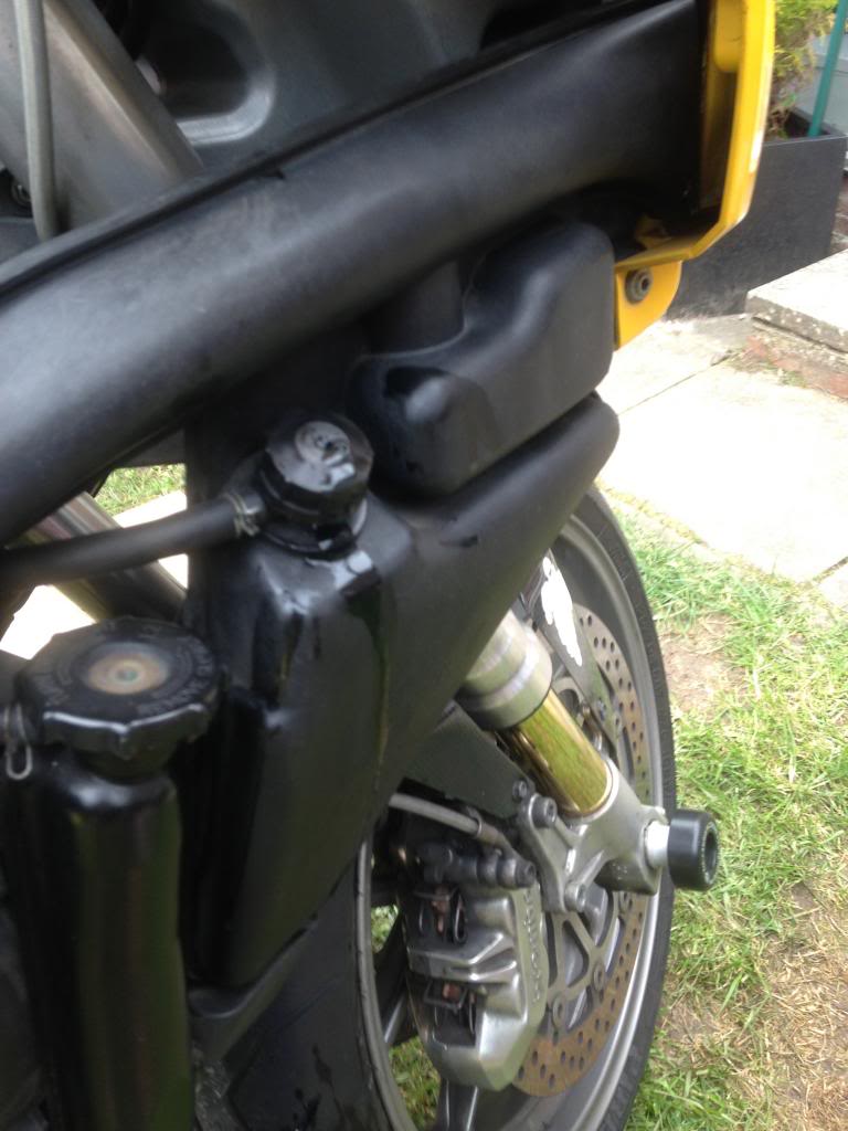

  5. Could you please check this photo and video?
    I think I overfilled the coolant bottle and fluid is continuously being pumped out of the overflow screw top.
    I don't know if this is normal because I have over-filled it or if this is the source of the leak.
    I wasn't able to source any other leaks today although I didn't do the toilet paper test.

  6. If you can find no other leak, is it possible that there is a blockage in the system, causing it to vent out of the overflow when up to pressure?
  7. How would I check that?
    I'd have to strip out the whole system? Strange thing is the bike doesn't over heat. When ridden previously it never went higher than 74ish degrees.
    Although that would make sense. The leaking fluid is very green but the fluid in the coolant bottle is blue.

  11. I'm betting the leak will be the 8mm hose to the top of the rad on left side, the hose clip is pants.a jubilee clip will cure it as for overfill look on the inside of the coolant tank on the right, look from the ground by the front wheel your coolant level should be between the two marks.
