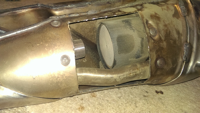

  1. Hi i have seen a guy in the USA coring 1199 standard exhausts.. Just wondering how hard this would be.. Or if anyone knew somebody in the UK thats is doing this.. Seems as though it does not require a map and is f loud.
    so far ...
    Remove sleeves from exhaust - easy enough
    Cut a square hole in the exhaust - easy enough ..
    remove the catalaytic piece and cut some pipes in the exhaust cans??? this bit whats the best way.
  2. I did it the other week and its as straight forward as you have just mentioned. You do have to use brute force and ignorance to remove the Cat itself
    I did tidy this up with once the cat was out but I have no pics
    Took the chance to wire these bolts up whilst it was off
    You do gain a little bit more noise and the tone has a tad more bass. I would say there does seem to be a tiny bit more mid range and it feels like it spins up a little quicker. I can only quantify this by the seat of my pants rather than in scientific way.
    But mine even though it was on standard cans did have the upmap on the bike so I would like to think the slightly more opened up exhaust should match the map better
    I know the guy doing in the states have a couple of levels of coring available but I didn't want an offensively loud pipe or something that could have had a detrimental effect.

  4. MR C .... You are the man... Thanks matey.. Did you have to take the actuator thing off for the exhaust at all whilst fitting your cans back on.. to open the flap like i have seen in the termignoni installation videos by any chance ? ...
  5. Because mine has the upmap I removed the servo and cable ages ago as the upmap blanks out the servo. You may have to get servo eliminator to stop a fault showing on the dash. I did leave the flap in place, once you remove the servo and cable the flap defaults to open.
    I used a dremel to cut the square as its 1mm stainless I wanted to keep the cuts a small as possible as welding thinner steal can deform the metal.

  7. Smashed those cats out .. Boy they were hard work .. Just waiting for my welder to stitch them back up £20 quid .. ;) . I used a plasma cutter to cut them open took about 15 minutes ..
    Do you require a map .. Did the same as you in pics smashed out cats and cut the tube like in pic.. Map apart from up map that is ?
