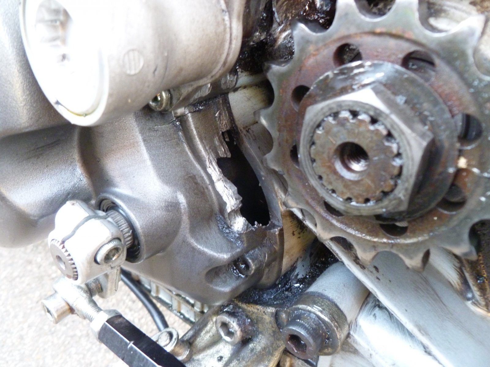

  1. On Sunday my chain came off and ground a hole in my crankcase (see Gallery). My Hyper is 7 years old and I gather a new crankcase could cost nearly £2000. This is nearly half the value of the bike.
    Has anyone had a similar experience and were you able to get it repaired by TIG Welding?

  9. Hard to see the damage to the case on the blurry pic but it doesn't look too bad.
    I'd pull the side cover off and see exactly how much is missing from the crankcase, if not too much and not cracked then look at some kind of repair; epoxy or weld, personally unless very minor I'd be welding it but you'll really need the engine out to do that.
    As and when it is repaired, get a case saver to prevent any further mishaps...
  10. Deleted previous photo as it was taken on my phone and hence poor quality.
    This is the hole:
  11. I think if you replace the cover your good to go....you were lucky I guess.

  12. I'm no expert but would imagine that could just be welded with a patch - like a battle scar.

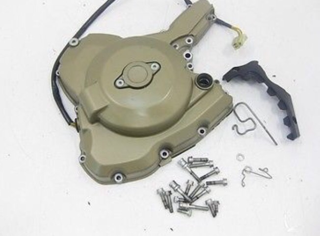

  13. Looks like it only damaged the alternator case. This can be removed and replaced with the engine in the frame.
    I recommend that you buy a lottery ticket tonight!

  18. Indeed, you appear to have been lucky as it seems the crankcase is OK.
    The cover is easily replaceable and could still be welded but you may be able to find one from a breaker/ebay etc. for not too much money.
