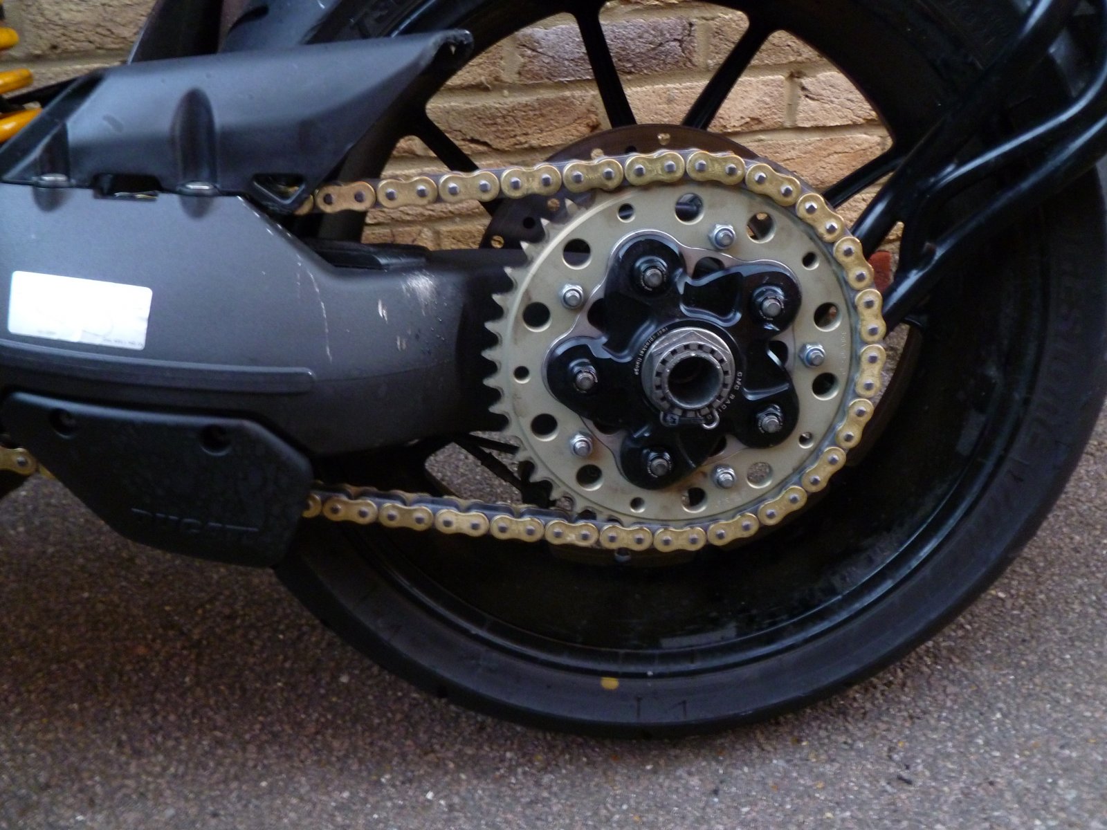

  7. Quick update.
    Hyper fixed: New Renthal sprockets and Tsubaki Chain (£166), Generator cover (£169), work done by BikersRealm (£220).
    Very impressed with the service from BikersRealm Ltd. Thanks to Pavey for the recommendation and thanks to the others who posted constructive advice.
    Cheers,
    Moses.

  11. looks a lot more solid than my £7.99 jobbies off e-bay.

  16. It's 1.2mm thick (I have one) - chain will never go through it. £26 for a piece of folded stainless steel is hardly a bargain ;)
