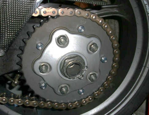

  4. You may also want to consider the Talon rear quick change sprocket carrier, a little neater than the Renthall in my opinion and I picked up several spare sprockets for them via eBay, some being brand new for less than half price. I use them on all my three Ducati's
    It also has the thin flange for preventing the cush drive hitting the bearing\adjuster carrier.
    If you are stripping that area then a close check should reveal the condition of the cush drive rubbers and any abnormal cracking or softness should see them replaced.
    It is a wise precaution to use new sprocket nuts when refitting, especially if considering track use.

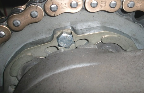

  5. Another option is AFAM which also have the small boss to retain the cush drive bushes shown here
