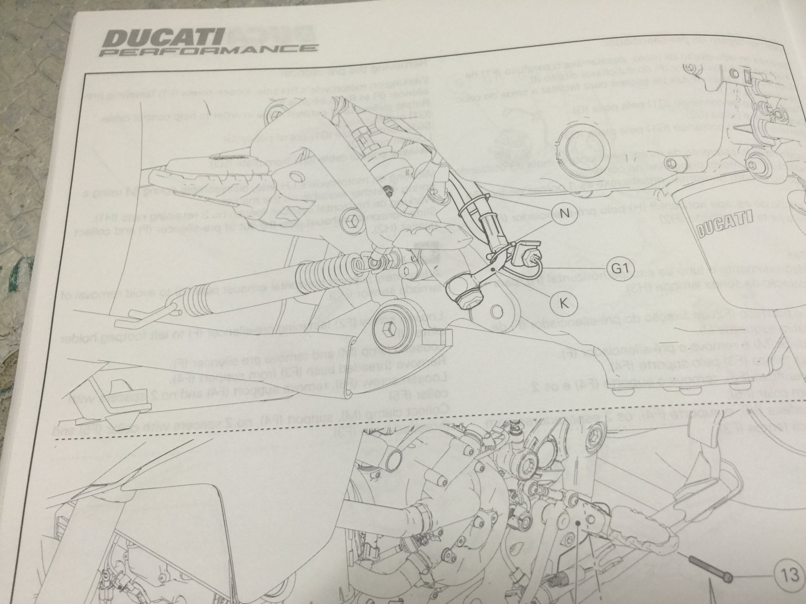

  7. NKibble, Did you use an exhaust valve eliminator as well or did you just fit as supplied?
  8. I already had the exhaust valve eliminator in place so, yes, I've used one.
    The system comes with a steel sleeve you place over the cable to provide resistance. The theory being you squeeze it closed with pliers. God knows how they've treated that sleeve but I reckon King Kong would struggle to squeeze that bastard closed. I certainly struggled!

  10. It seems to be a lucky dip as to wether the engine management light comes on or not
    As I've said I rode mine with the baffle in for a good few miles without the light coming on, came back to the house, took the baffle out, revved the engine & the light came on, fitted one of those exhaust valve iliminator gizmos,but the light still staid on, took the bike out of the garage a day or so later, started the engine ....no light !..it hasn't come on since, which I can tell you was & is a big relief !!
    Personally, I wouldn't order the gizmo yet, wait & see if the light comes on, it only takes 5-7 days to arrive from the USA
    Steve
  11. Cable tie fellas. Seriosuly thats all you need! Tuck away behind swingarm

    I bought the healtech ESE, from Bike HPS, thirty something quid seems pretty good value to stop the risk of the engine management light coming on, especially if you want to take the baffle out, took 5 mins to fit, and got some stickers to add a few extra BHP :innocent:
