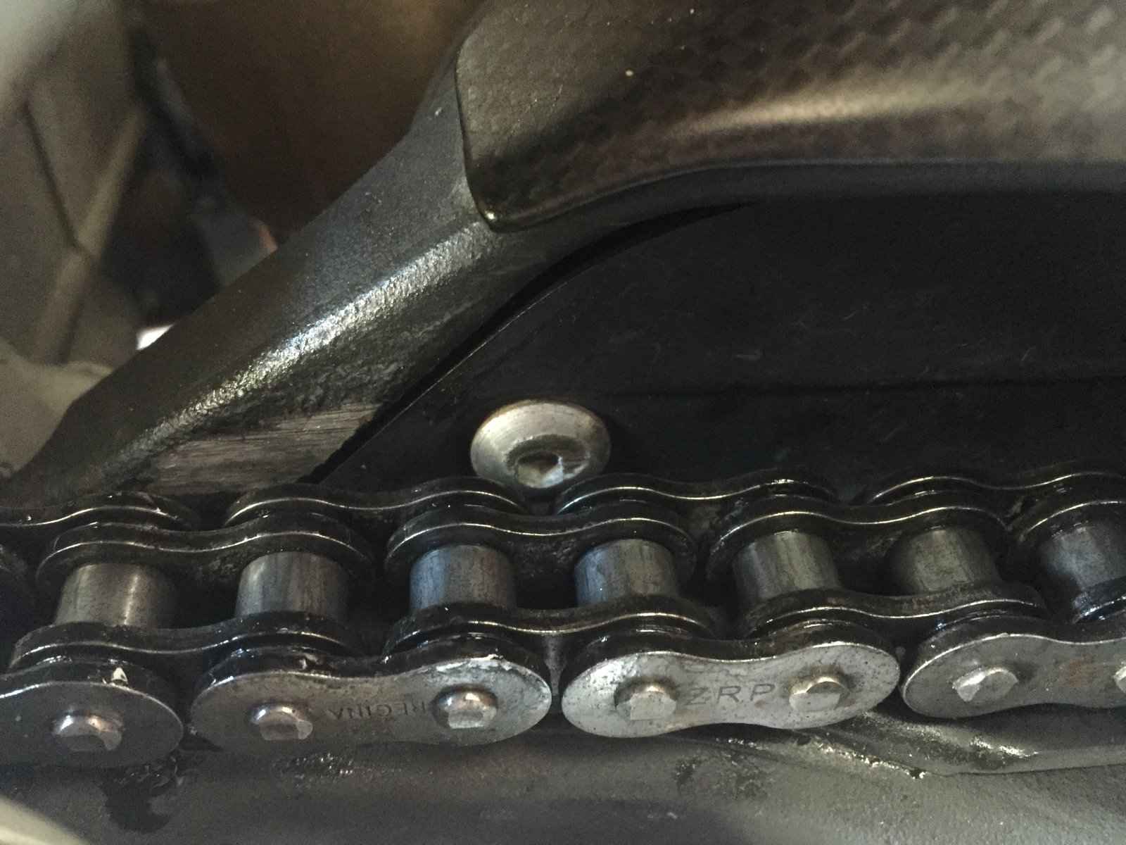

  1. The chain on my 1199r has rubbed a small patch of paint off my swing arm and started rubbing the head off of a bolt that holds a plastic cover on to the swing arm.
    Has anyone else experienced this or know of anyone with similar issue?

  2. I seem to remember that some who carried out the chain and sprocket change had issues with this happening, have you done this mod?
  3. I read about this on the USA forum last year. From memory there were lots owners complaining of the issue and most, if not all were owners of the "R". I can't remember what the issue was but there were several mentions of sprocket reversal and the swingarm being out of alignment.

  8. My R chain rubbed off the swing arm until I went to 520 (UK)

  11. I've the same issue on my 1199S, all came from the standard chain and sprockets. Hasn't gotten any worse since fitting a new chain and sprockets (the R kit)

  13. My dealer submitted a warranty claim and Ducati have agreed to pay for a repair. Before that happens the dealer is checking swing arm and wheel alignment, there's no point in the repair if it does it again... Unless there is a chain guide that can be fitted, I can't seem to find one? I'm sure I remember my other bikes having this sort of thing.
  14. swing arms have left and right adjustment on engine mounting as far as I know. A few mill would cause rubbing.
