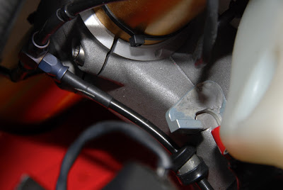

  8. Another possible advantage, which others have mentioned in similar threads is that it may be easier to bleed the twin-line set-up, because there can be a tendency for air bubbles to lurk in the "up and over" line over the mudguard. This wouldn't apply to the set-up with a single line splitting into two at the bottom yoke, but even that set up is "simplified" if you switch to two lines direct from master cylinder (it also reduces the number of connections in that case and eliminates a T-piece).
  9. The hassle with dual Lines, are they need longer banjo bolts and/or adaptors at the M/cyl. These have a tendency to restrict adjustment, as they can hit the fork leg.
