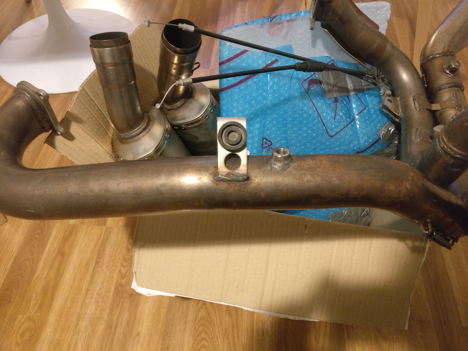

  1. Just a quick question as I prepare my bike for MOT. The technical inspection here is mostly just trying to spot aftermarket stuff that doesn't have the E-cerfitication, so they can fail you and make you pay twice. Thus, I need to remove the lovely Termignoni system and replace it with the less exciting stock pipe before even trying to pass the MOT.

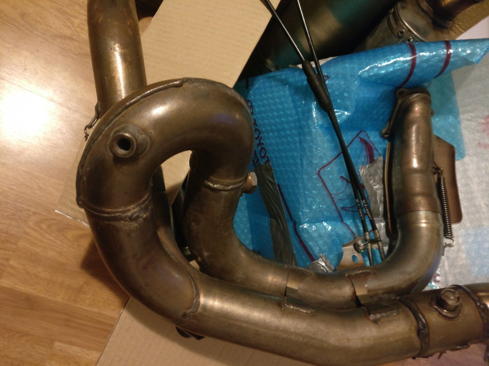

    However, when I finally got the stock exhaust from the previous owner I noticed there are holes in the exhaust. Two of these, which have the bigger diameter, are for Lambdas(?) But I have no idea about the two smaller ones. Does somebody what these are and what kind of a thread they have? Does somebody sell plugs for these?
  2. Exhaust gas take off points for diagnostics. Should have bungs in.
  3. Thanks! I figured it had something to do with engine tuning.
    Don't have the bungs, they were removed from the pipe. Any idea on the threads?
  4. A 1/4" BSP blanking plug should fit
  5. There should be two in the Termi pipe work.
  6. Huh, that would be pretty convinient! I'll definitely check that. I just assumed that since the Termis don't even have an O2-sensor, that it wouldn't have any. If it doesn't, I'll probably get a couple of 1/4'' BSP plugs and go from there.
  7. I ordered two for my 996 /1098 mongrel as they are a very odd thread to match up with the tons of screws I have in boxes. Turned out they are M10x0.75.
  8. Thank you! This is exactly what I was looking for. Saves me a ton of work buying millions of nuts and bolt and seeing what fits.
  9. Only a few quid each, plus a 10mm copper washer on each.
  10. Bung part number is
    78010071A
  11. Excellent! Seems like it is easier to find a generic plug than the geniuine part:astonished:
