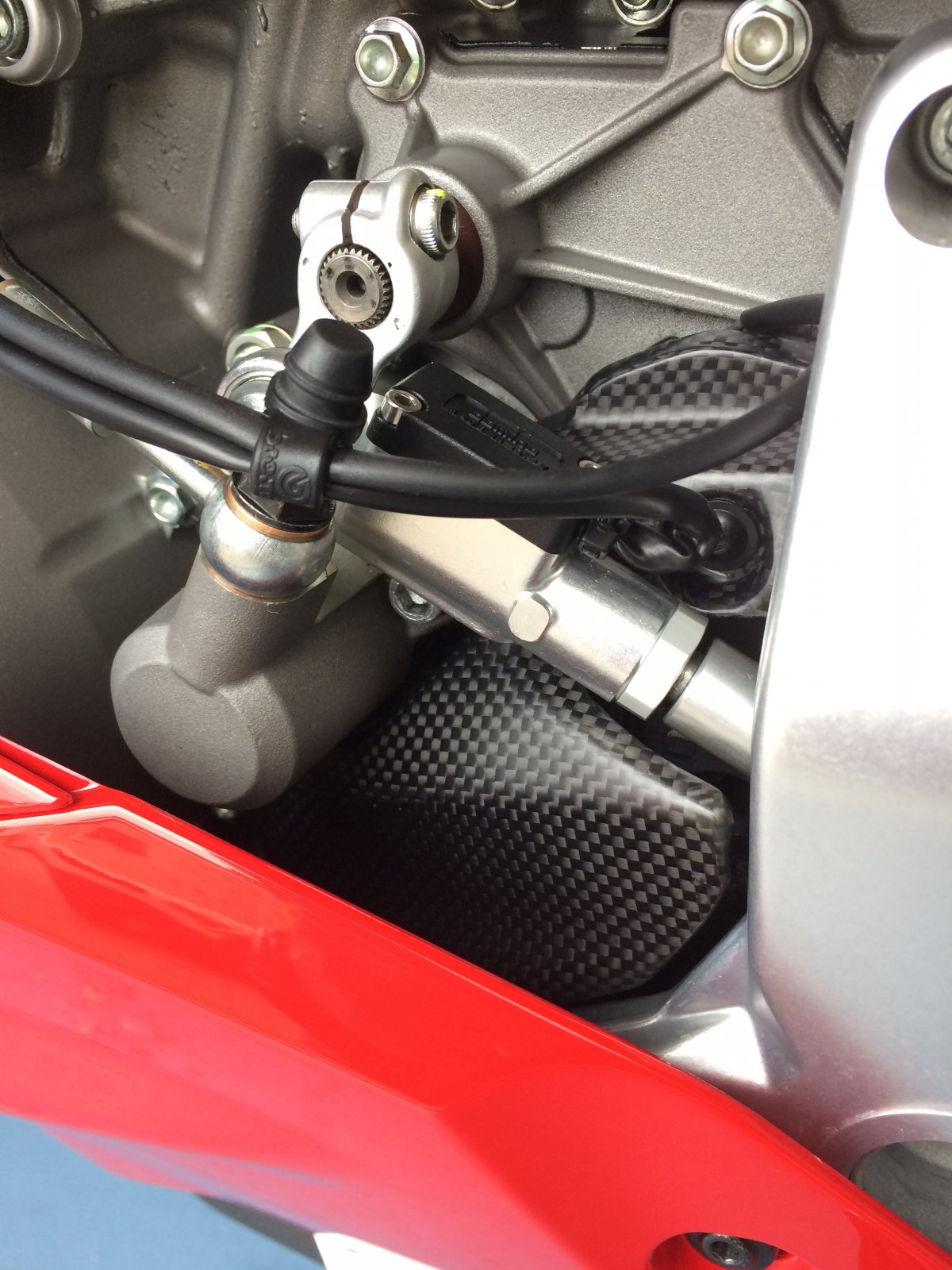

  5. Fitted this carbon sprocket cover last night
    What a pain! In the video it's just a case of unbolt the shifter from the arm and push out the way... well on the 959 and assume the 1299 the slave clynider/bleed nipple is blocking the bolt so had to disconnect the clutch hose and re-bleed it.
    While I was on I took the time to lower the shifter lever half a turn as I found it slightly too high. That's a pain in the arse of a job too as you can't access the bolt head withou removing the foot rest...

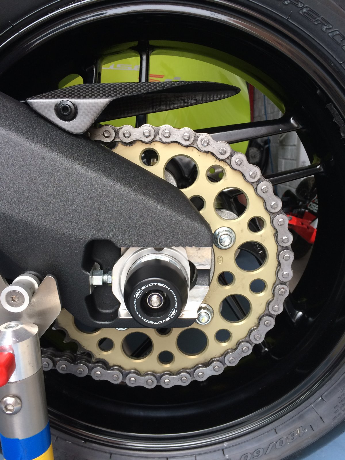

  6. Fitted a comfort seat, new chain and sprockets, a new SC2 rear tyre and put the standard can back on......
    To go with the SC1 front, DP bodywork, RCS master cylinder, GB engine covers, fork and swing arm sliders.
    Just need some decent weather and hopefully the standard can will allow some more track time.

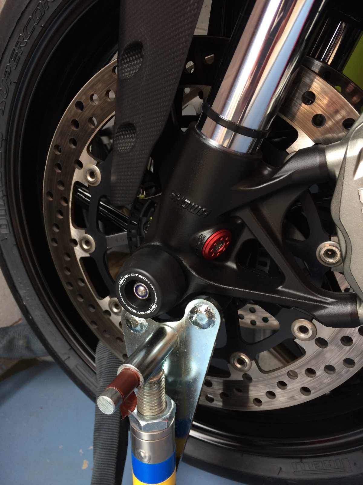

  7. Got some evotech spindle bobbins
    Just need to ride the damn thing now...
  8. You needn't have done that. Just undo the three bolts holding the slave cylinder to the engine and pull it clear with the clutch hydraulic line still attached . No bleeding required. It's also much easier to fit the sprocket cover with it out the way
    Sent from my SM-G935F using Tapatalk
  9. Cheers for that. Wasn't sure what would happen if I removed the slave cylinder or what is inside it so just did the line and bled system again. Wasn't the end of the world.

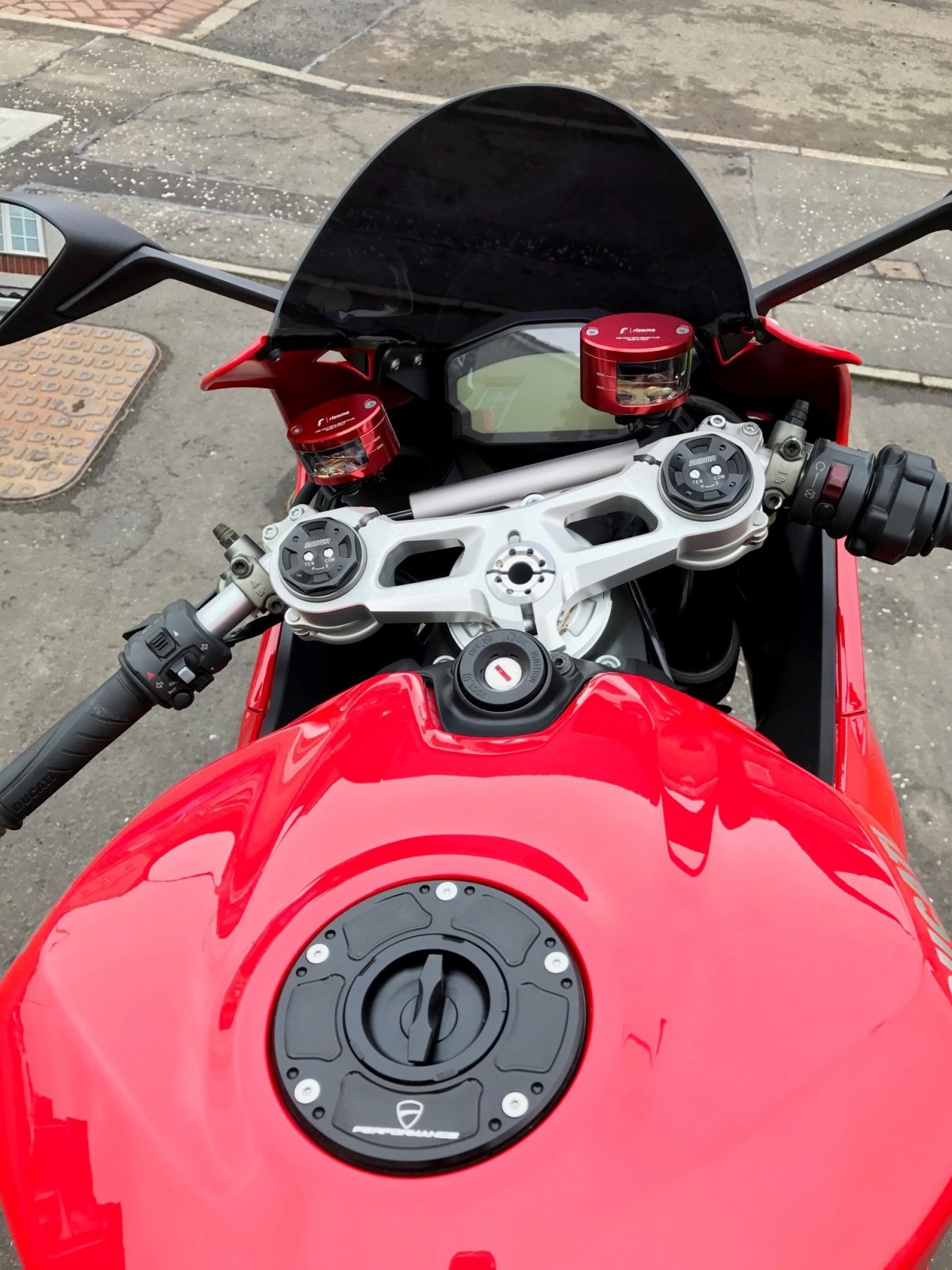

  10. Having only owned this beautiful machine for 4/5 weeks, I have managed to get plenty of modifications done....with plenty more on the horizon!
    So far I've installed;
    Tail tidy
    Dark tint Puig screen
    Rear seat cowl
    R&G radiator covers
    R&G clutch slider
    Rizoma front brake and clutch reservoirs
    Ducati Performance fuel cap
    SC Project exhaust
    Ordered but still to be fitted;
    Evotech axle sliders (front and rear)
    Ducati Performance bar ends
    K&N air filter
    Integrated tail light
    Shopping/to do list;
    Custom mapping
    Full six carbon parts
    Rear set
    Magnesium & clear clutch cover
    Where does it stop... :)

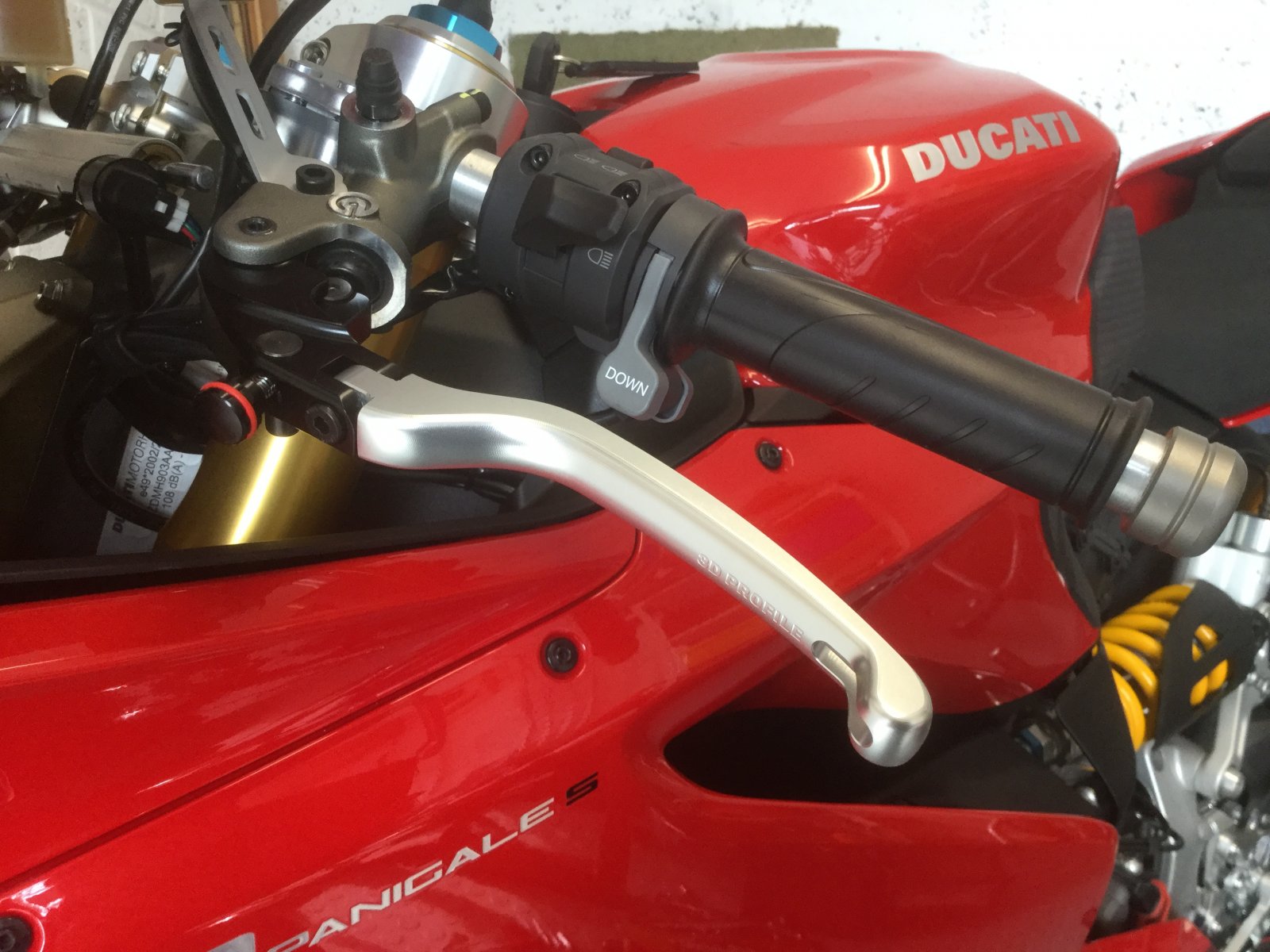

  11. You forgot the Rizoma folding brake and clutch levers!
  12. Just had a look there.... they are nice but pricey! Have you got them installed? Worth the money?
