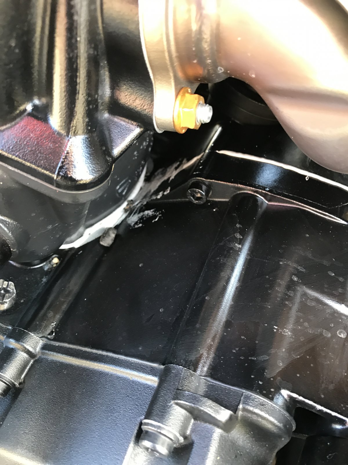

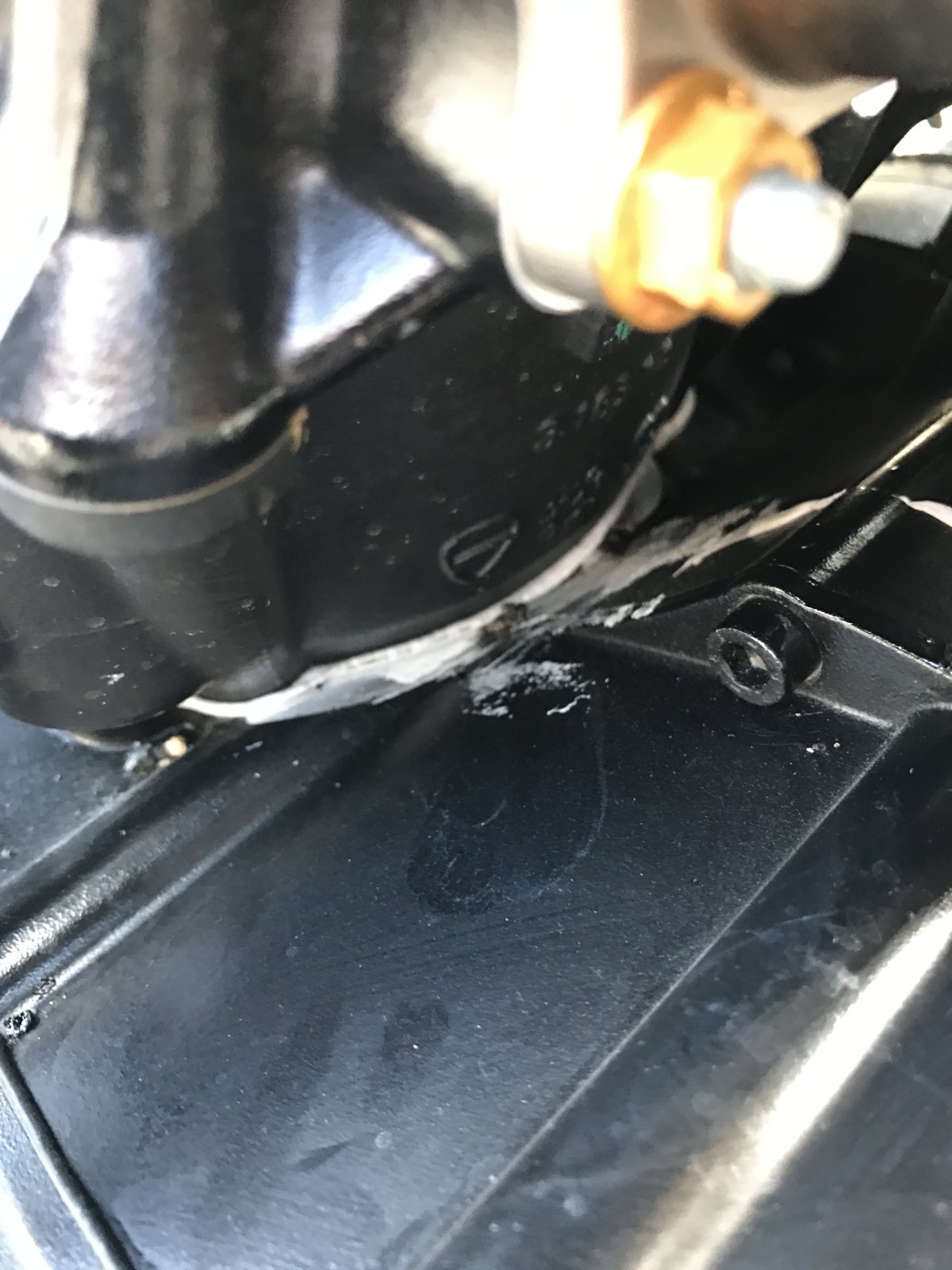

  1. hi all just had first ride , the bike is second hand bought from a main dealer, quite a few people noticed a load of cream coloured silicon around the engine, goes all the way around some said the motors been split in half , it is proper messy job, is anyones elses like this or is it a problem, also having trouble with 5th gear 4-5 5-6 6-5 all involving 5th, hitting neutrals any thoughts please as I'm calling the dealer in the morning, its got 2k miles on it thanks,
  2. Silicone is all round mine too and mine was on if the 1st in UK. So nothing to worry about there.

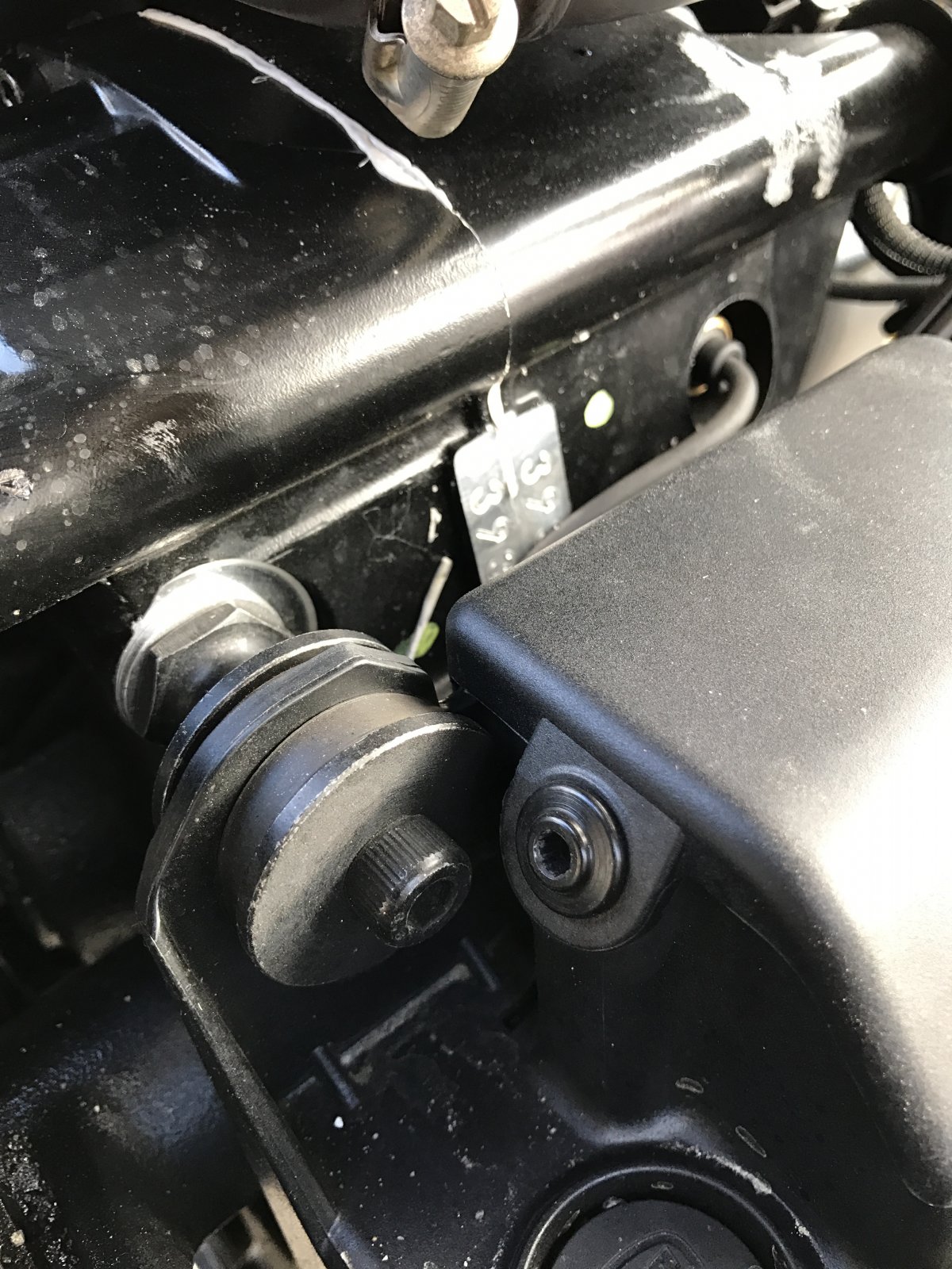

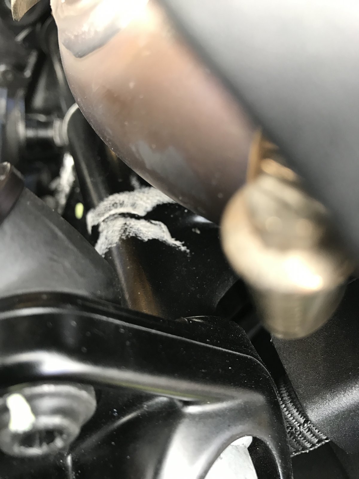

  3. Yep to 1 and 2 are like mine - not sure about 3 as it looks furry
  4. no3 Ian is smudged silicon with finger prints in it , didn't think it would come out the factory like that ?

  8. yeh cheers Ian a really liked the bike though, proper pull on it, and handles great hope its ok to keep it,
  9. Mine was similar with quite a lot of sealant showing but the pdi man at Moto Rapido tidied it up nicely. No false neutrals either unless I'm being cack handed (footed?), missed a couple of changes maybe

  11. That sealant looks nothing like my R, mine is greyer and much neater. I'll post pics when I'm back.

  16. That sealer looks really bad against the black cases. Yet Ducati used black sealer on my Scrambler which has dark gray cases. It is a lot less obvious.
