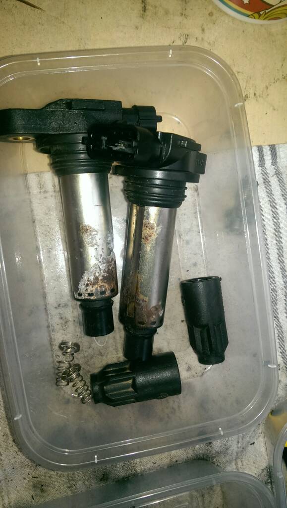

  9. Denzil Are you aware that you can remove the coil's tip?
    Worth doing as you could have some water trapped inside. Watch out as you pull the tip off as there is a tiny spring inside which inevitabley throws itself into an inaccessable place and hides.
    If you can't remove the spark plug, I found a coffee stirring stick purloined from a bikers cafe serves as an excellent 'drying out around the plug tool' with a small piece of rag wrapped around the end of the stick you can push it into the plug recess to dry around the plug.
  11. Crystaljohn, I wasn't and have now taken the tip, spring and seal off and put it back in the oven, this time for 30 mins at 100c. After the first cook it made no difference except I was able to check its resistance at running temperature. I think this one is a goner as the resistance is way out of spec even when it is hot, ecu will probably see it as out of range hence the fault code showing a short. Craig at Moto Rapido will be my first call of the day tomorrow morning
