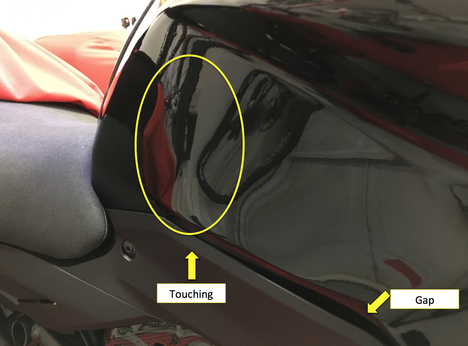

  5. I had issues with my SFS :( 2011 bike although bought new in 2013. This tank was changed in 2015 as it had swollen. Changed again at the back end of last year. Both tanks had swollen in different places.
    I'm not aware of any issues with the Superbike fuel tanks, although apparently some have had them.
