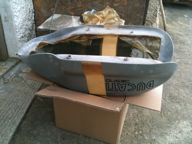

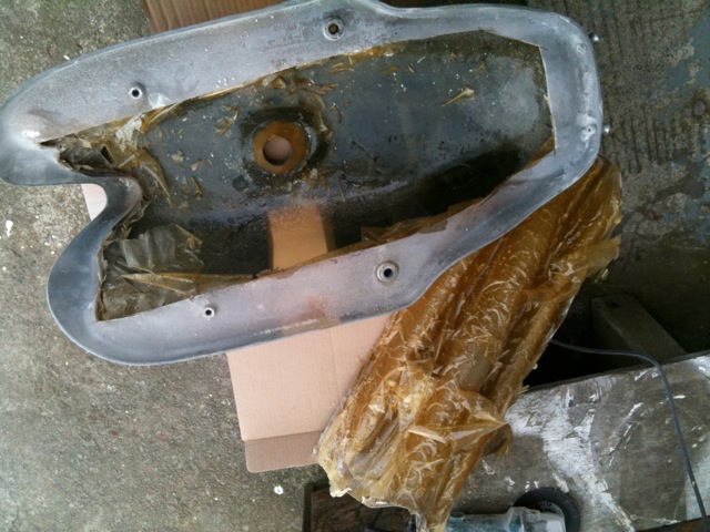

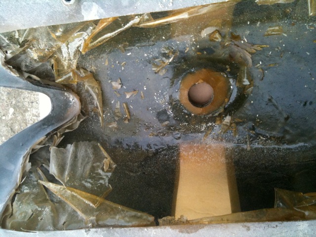

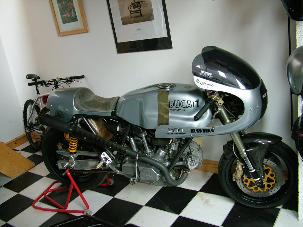

  4. DSCF1787.jpg Ethanol issues 1.jpg Ethanol issues 2.jpg Ethanol issues 3.jpg Ethanol issues 4.jpg Ethanol issues 5.jpg Ethanol issues 6.jpg Ethanol issues 7.jpg Ethanol issues 8.jpg Ethanol issues 9.jpg Ethanol issues 10.jpg

  5. not to get you alarmed skidoff but just to let you now that some plastics are also prone to deformation due in part to ethanol exposure. Acerbis manufactured my Cagiva Elefant tank (and my Supercity) from PA6 polyamide. This has the ability to absorb water which is more likely to be present when ethanol is used. This is still a 'luck of the draw' lottery and my bloated tank is a rarity in the UK and more likely due to external water saturation at some point. Deformed Motorcycle Fuel Tanks
  6. Not only does the vast majority of petrol available in the UK currently have a 5% ethanol content, it will be rising to 10% in the not-too-distant future...Apparently it's all to do with some EU ruling... There has been a lot of discussion about this subject in the classic bike press.Also - yes, ethanol will eat into GRP tanks..."Just because you're paranoid, it doesn't mean that they aren't out to get you !"
