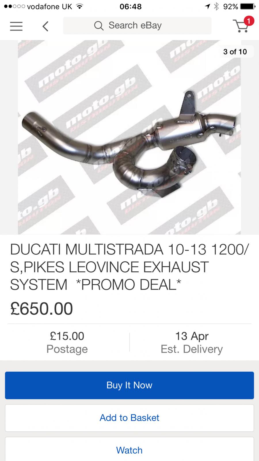

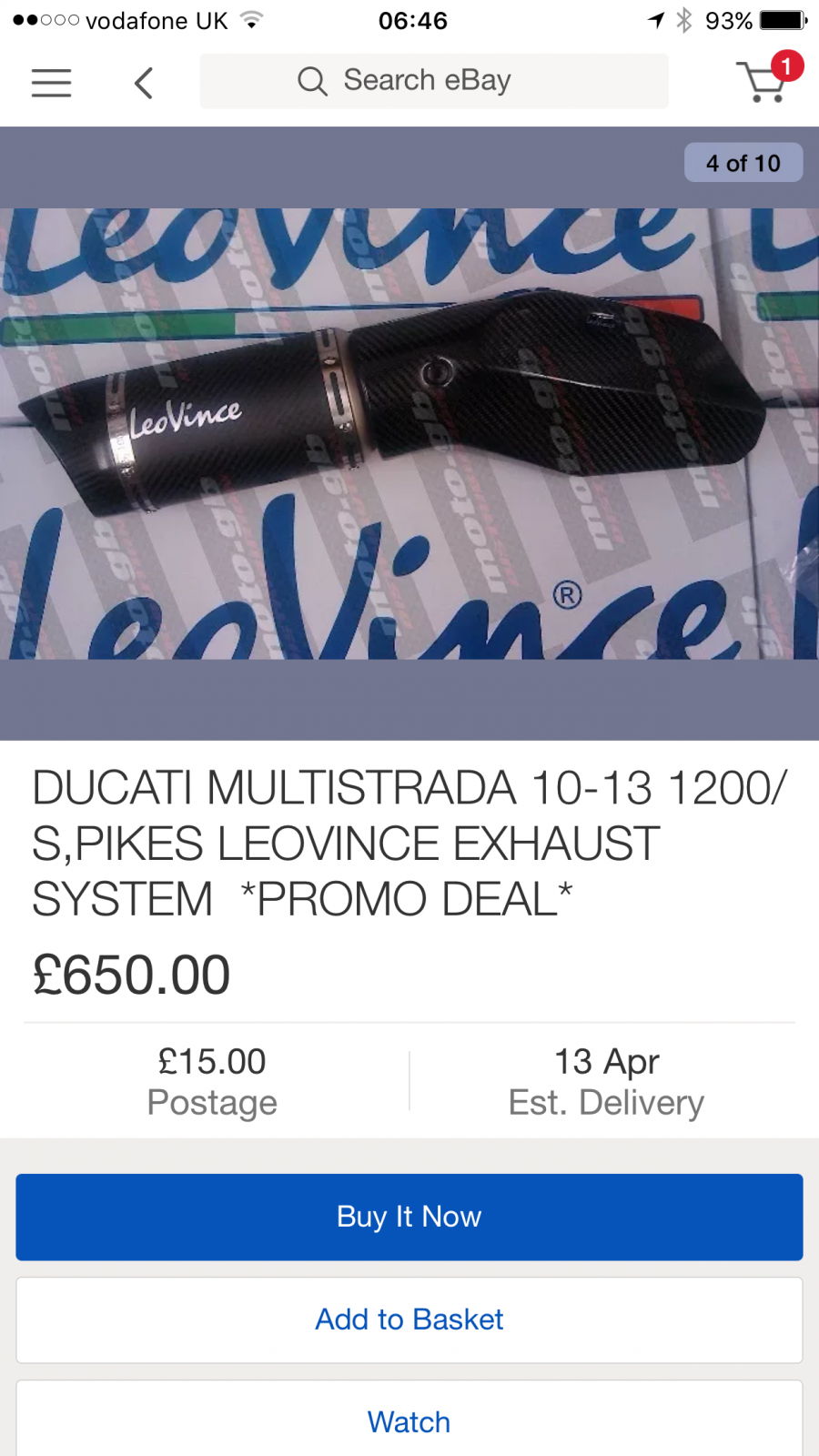

  8. There's loads of threads on here about the best mid pipe to fit, Leo Vince get very good reviews from the guys that have them and the chap at CJS reckons they're good to work on. The UK distributor has a deal on at the minute for a mid pipe and a sexy looking can for £650. You'd be able to sell the Termi system for a bit more than £650
  9. Hm. It seems the LV midpipe also has a catalyst?
  10. Full description is online, it doesn't mention a catalyst.
