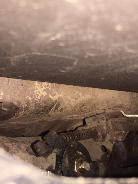

  4. Thanks, that does make sense, in fact I've just fitted a similar sized spring (from Halfords), and it's working fine. I agree, unless you are removing the Servo unit to save weight, why pay for a DUC.EE, as this job took about ten minutes, and costs pennies. Just requires removal of the exhaust heat shield(3 screws). Regarding the functionality of the servo, it's interesting that this has just one cable, my 848 had two cables, in a push me - pull me config if that makes any sense, so this one is probably easier to mechanically fool than the 848/1098 was. When the ignition is first switched ON, the servo cycles the flap fully closed to the end stop, then open. I think with the spring fix, we got lucky, as if you watch the cable, it gets pulled in until the spring is coil bound, which probably replicates the end stop on the flap actuator thing, maybe?

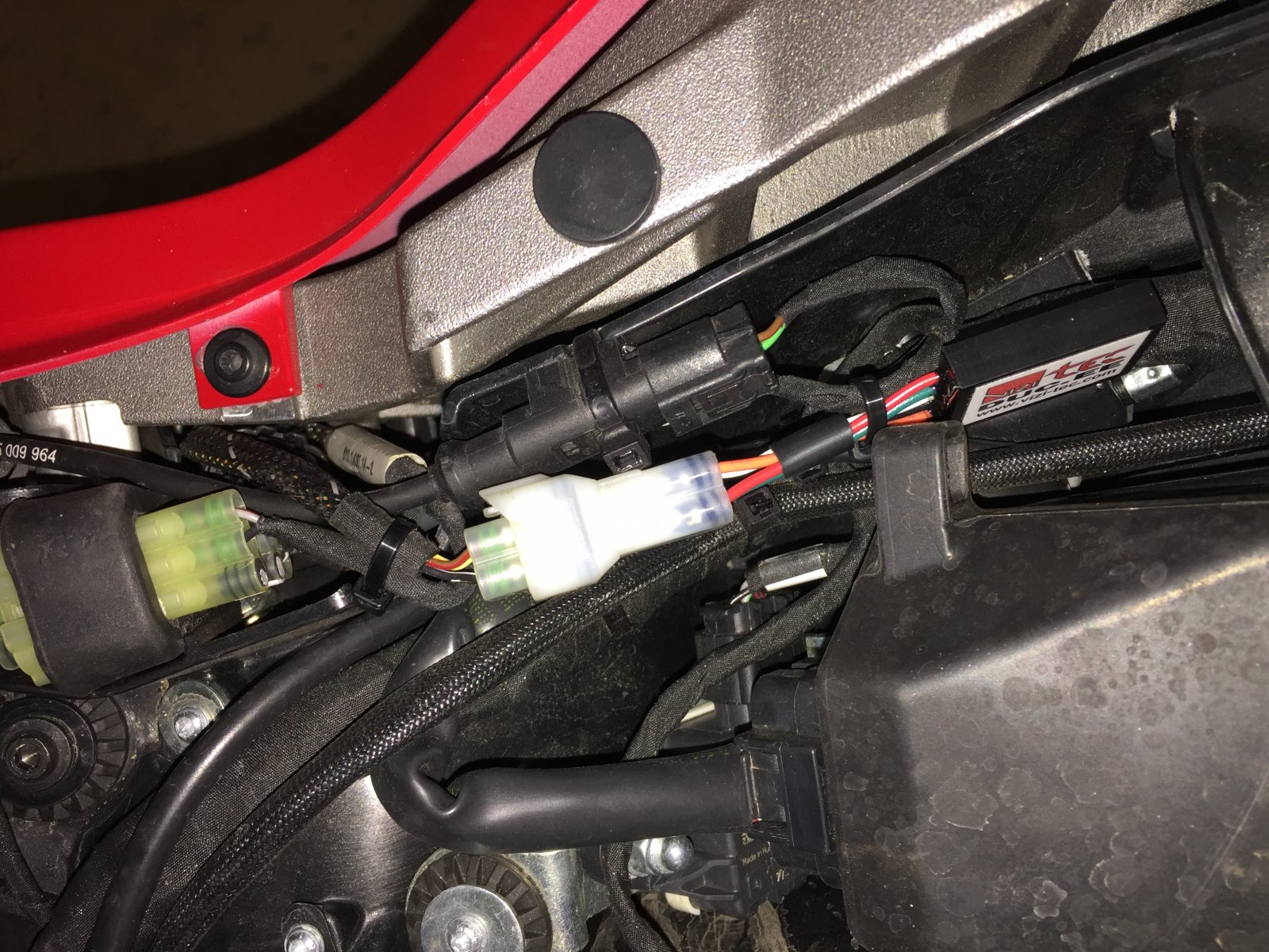

  9. Mine plugged in fine, and seems to be doing the job.
    The original plug is pretty awkward to get to, but I managed to unplug it without having to remove any fairing and have left the servo in place for now.
    Quick photo shows the DUC.EE in place.
  10. "pretty awkward to get to"! I gave up trying to fit mine, it is the vertical connector hidden under the two connectors to the left in your photo?, I could barely see it never mind disconnect it, well done.
  11. I couldn't extract it by hand, but used a screwdriver to unlatch the locking mechanism and pliers to pull the plug.
    Awkward bugger though. :)

  16. Gone the spring down the cable route cheap and cheerfull, bag of assorted springs from JTS wholesale for a few quid, took my pick and it works a treat can be reversed easily.

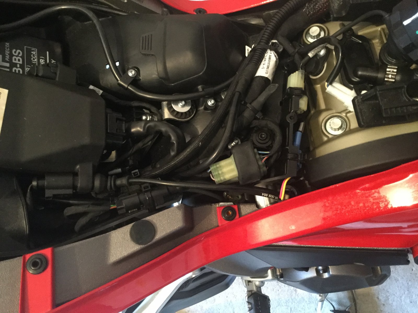

  18. DOes anyone know if you need to disconnect the battery before fitting the Duc.ee.
    And can anyone point out where it is in this pic? Is it under the connectors that are fixed in place with the rubber by the middle fairing fixing?
  19. No need to disconnect the battery at all. Can't help with the rest as I'm non DVT
  20. I've posted a pic earlier in this thread. Take a look to see if that helps.
