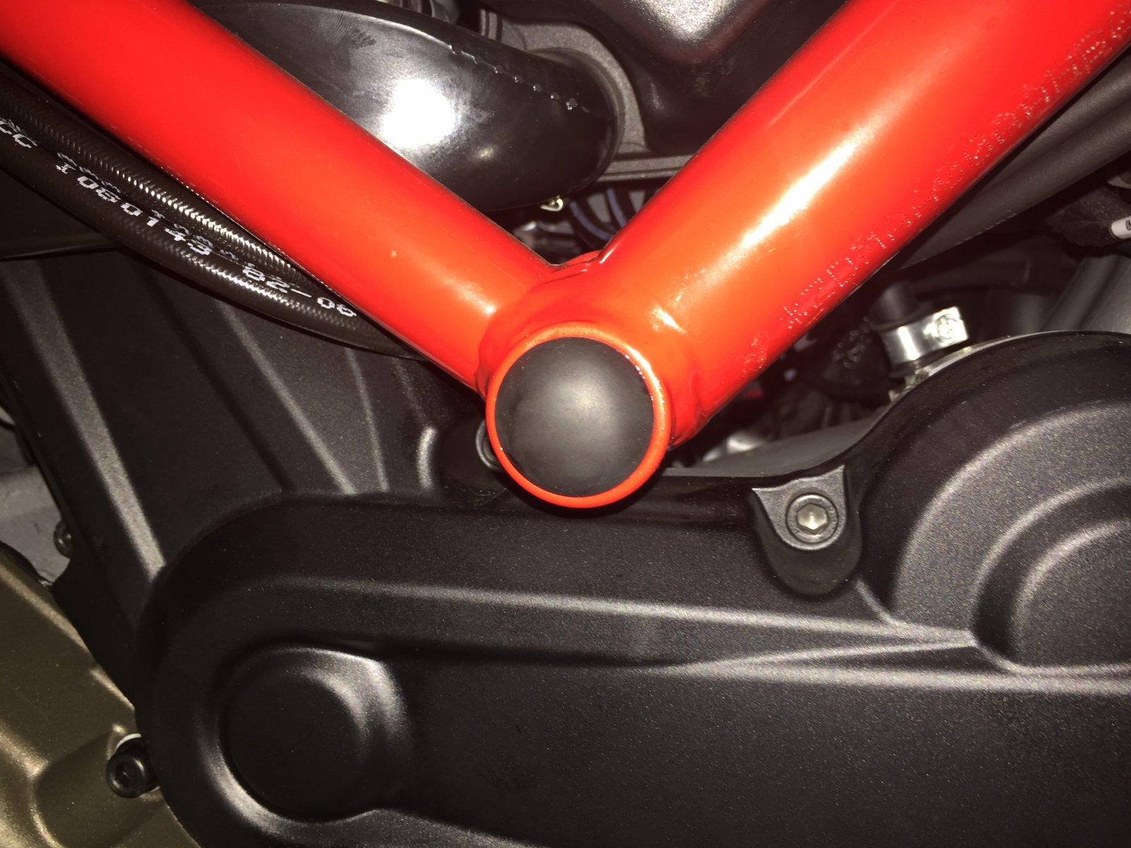

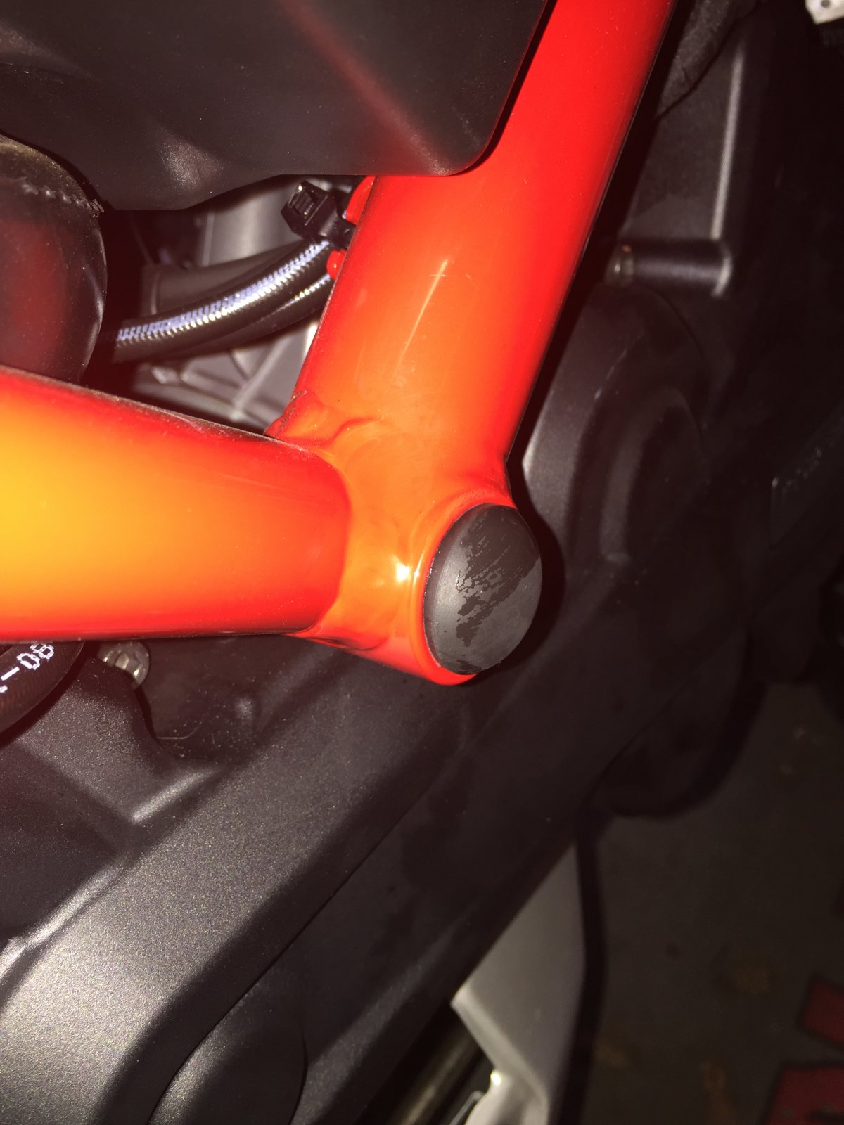

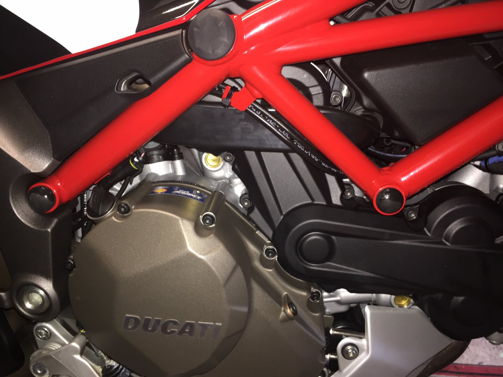

  1. While looking at the USofA forum, I noticed one of the guys had put some frame plugs onto his Multi so decided to follow his lead.
    The frame plugs are actually chair leg rubber tips, size is 19mm, bought on fleabay for a couple of quid instead of £185 for OE plugs lol
    Ignore the shiny bit, thats just water I used to slide them in neatly and they fit nice and tight. I think they look okay and you get 4 tips so both sides done, fit the bike quite nice :thumbsup:

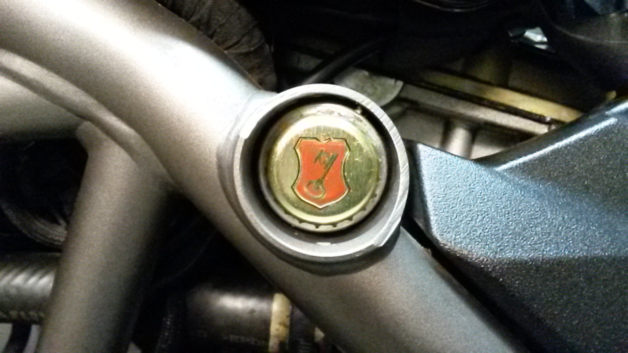

  8. Maplins blanking stoppers was the choice of old. Nice find :upyeah:

  12. Jim are the sizes given on flee bay bore or outside diameters ?
    Sent from my iPad using Tapatalk
  13. Hi Nozzle, Pick the 19mm bore as it gives you an additional 2-3mm on the wall thickness and they need to be slightly squeezed to fit in the holes.

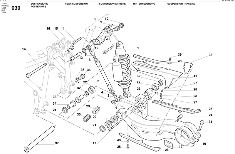

  14. If we could find a plug for the swiingarm hole at the bottom of the shock that collects water and holds it forever, that would be great :rolleyes:
  15. 872.1.016.1A
    Cap 1
    872.1.017.1A Cap 2
    I wonder if they are the same shape hole that they used to Cap off? Item 29 & 30
  16. The water fills where the lower suspension eye connects to the swingers. Alas int think you can plug it. Seems a terrible design flaw, no drain under, so wash the bike then centre stand and it will go no where, ever!
