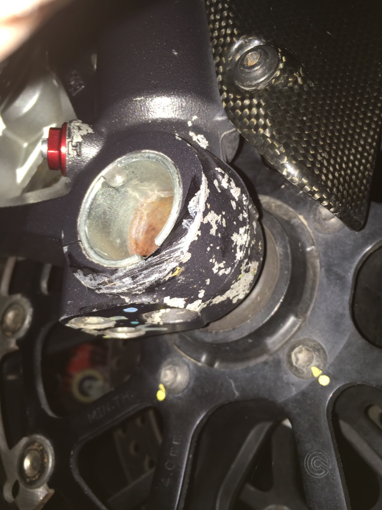

    I think i need your help a litle bit, i bought my white Ducati 848 a year ago with some damaged parts. The most parts are all ready replaced but one part is a litle bit difficult. That is the front fork, the black or grey part at the wheel where the brake is mounted. Replacement is a litle bit too expansieve, does any body have an other or better idea to make this nice again?
    There ar a lot of scretches so you can see the metal. Is painting an option?

  10. It looks not very nice[emoji56][emoji106]

  11. That can be dressed with a fine file, wipe a bit of metal filler in the scuffs and painted. Fit some crash bungs through the axle if it still looks rough.

  13. Looks it nice to paint it black or try to get the original color?

  14. As Streetfighter said, easy job that and its in an area thats not to noticeable i would try and get a good colour match,it looks a plain colour and not metallic if its metallic try ladies nail varnish they come in lots of metallic shades and colours.

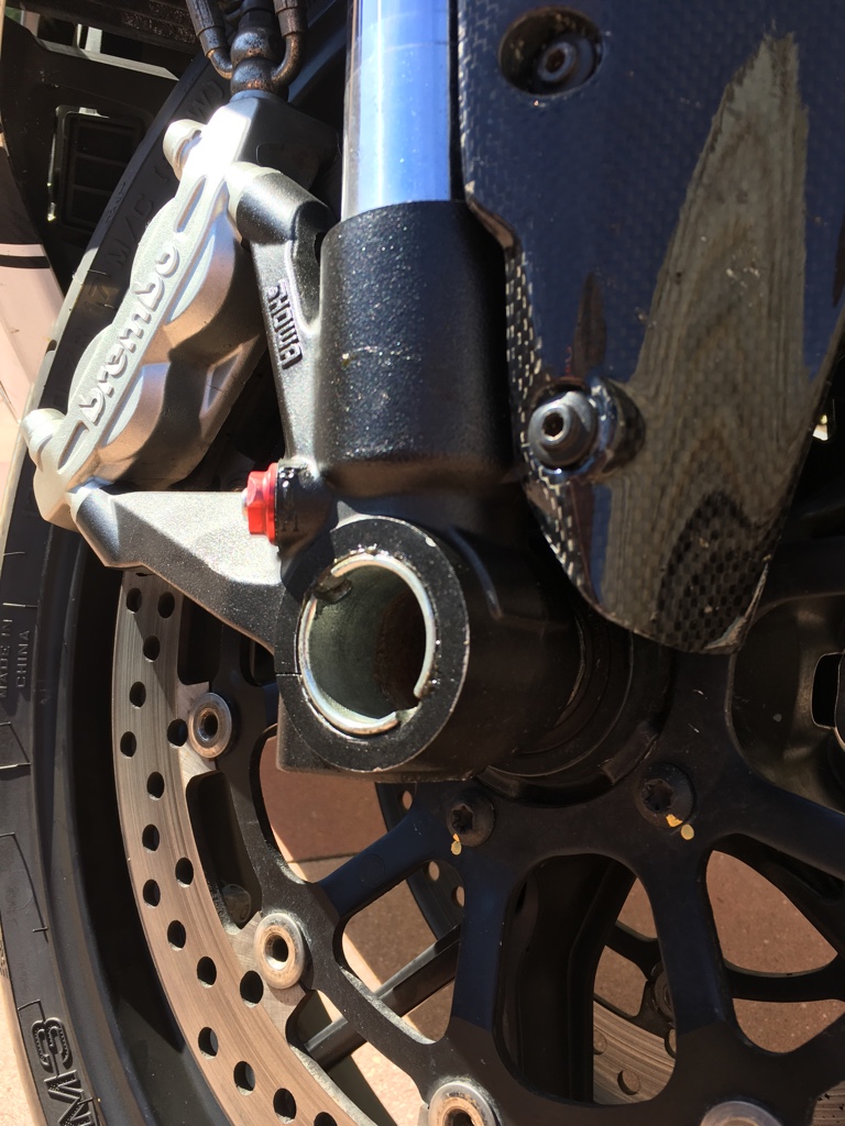

  15. Problem is over, i just bought a new pair and now it is good looking[emoji106]
