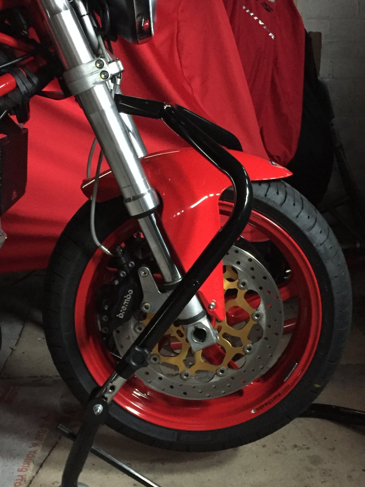

  15. @Chris2511
    TBH I don't know if it fits, I never tried it when I owned the 1098 so can't confirm this. I needed a pin modified which had a double headed pin (twice the standard size supplied)in order to lift up the 8/1199 front end. My mate simply re-designed and milled me a new pin on his lathe that fits the Panigale (28mm) with a small shoulder so it fits and holds better. As mentioned you'll need to check if a hole exists on the 1098 for 1 to fit and then do your necessary searches as appropriate on the stands. It also works with the Monster S2R which is why I bought it in the 1st place.
    Enclosed is a photo of the stand under the S2R, when I get it back I'll take a photo of it under the 899.
