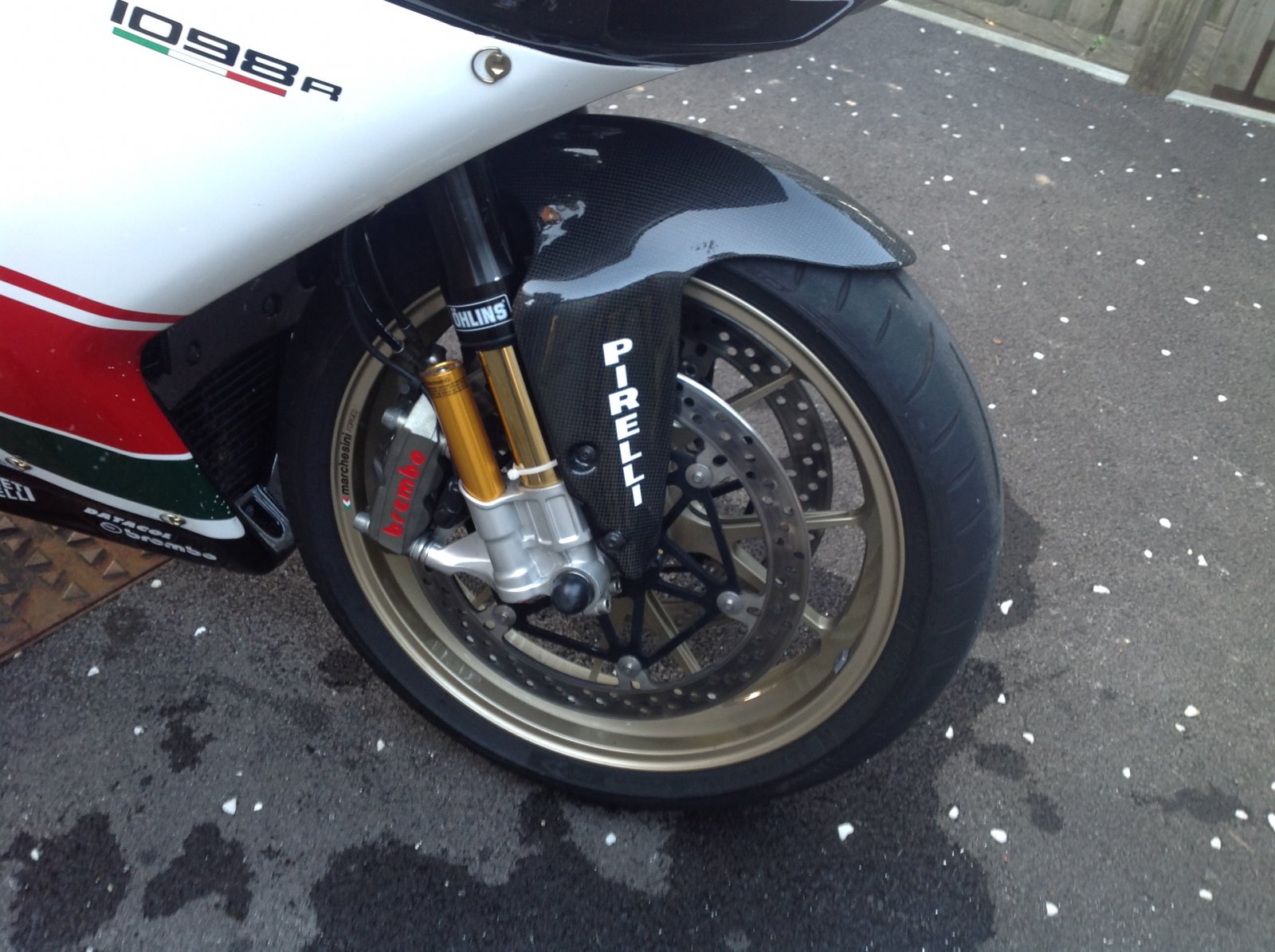

  3. You mean like this....?

  6. @RickyX can't afford those there off the desmo! Retail price is about £10000 for fgr300's
    @bradders I know what you mean mate buying the forks as a whole your paying for the gold bling on the out side but they do look good!! Or just go for the internals where they do the same job but save myself a £1000 and keep my yokes.
