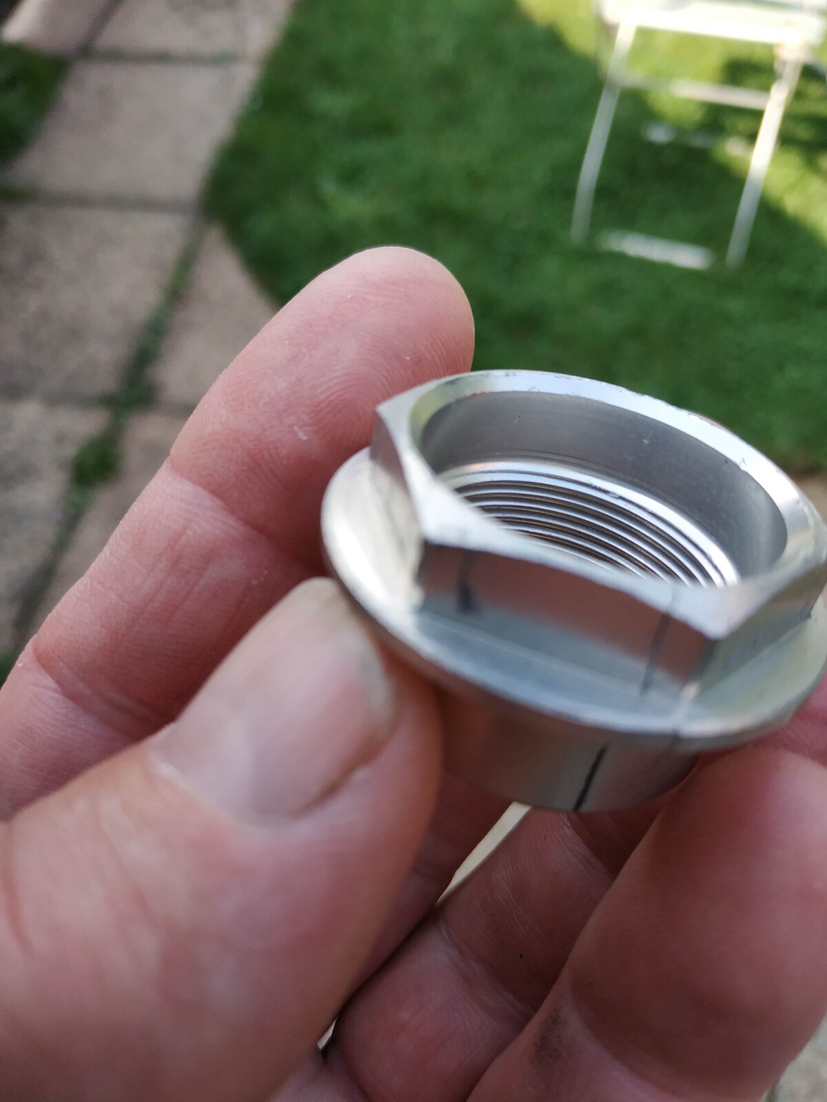

  1. So ... after finally getting rear wheel nut off for tyre change, went to remove the front and found the front wheel spindle nut cracked. Didnt take any force to remove, so any thoughts as to why ? Previous owner over tightened ?
    Also the more I take apart, the more corrosion I find - Pic includes one of the spindle clamp bolts, is this common on a 3 year old bike ?

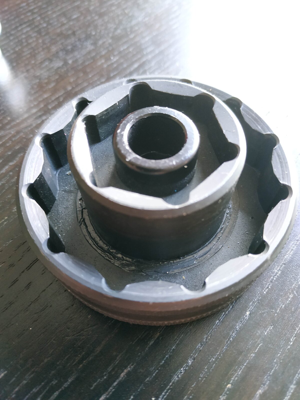

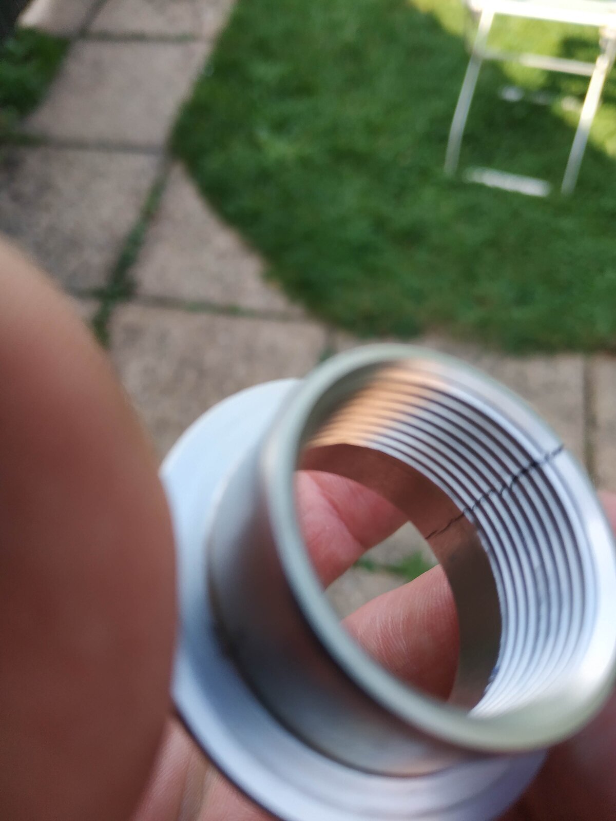

  7. This has happened to me .....nut was easy to get off ...I was the last person to fit the nut no problems used torque wrench correct torque 65NM etc. No corrosion on any bolts... I had a painted mark on the nut /lower fork as safety creep check ...it had not moved. Fitted nut torque clicked (twice) couldn't get the socket off ...strange. bit of effort off came the socket to reveal the cracked nut. I can see my socket left witness marks on the nut where the crack is (in the loosening direction) ....christ that nut has thin walls.
    I cant believe what I'm seeing ...as i say no corrosion ... correct torques used.
    As Nelly mentioned I'll check my axle for any ovality ..... new nut ordered.
    The socket does not have any radius on the end of the flat which engages the nut surface so Im wondering here .....a little play in the socket/nut interface could the edge of the socket flat have bitten the aluminium ? and a wedge effect happened ?
  9. So ....I wonder if when I removed the nut last time it was stiff maybe ....cant remember and the nut became fractured ...fitting it today caused the fracture to actually let go ......

  11. This fractured nut is caused by over tension.
    I see it all the time in my trade.
    Change to Ti

  12. Gerr, Looks to me like the spindle nuts and their mating flanges have been torqued without the proper lube on the thread and flange - leads to over torqueing and snatching. Also try a conventional single hex socket
  13. Greased and correct torque.... So... I won't be using that socket again....
  14. I have a good 30mm hex socket...not multipoint. Forget I had one...

  17. If the pinch bolts are proper then the cracked axle nut is not going to have your front wheel falling off, but certainly a concern. The dual rear-front socket tools like the one pictured several posts back are terrible tools, particularly for the aluminum front axle nut. They are a poor alternative for proper 6 and 12 point sockets
  18. I bought the socket for the rear axle nut to be honest ...
