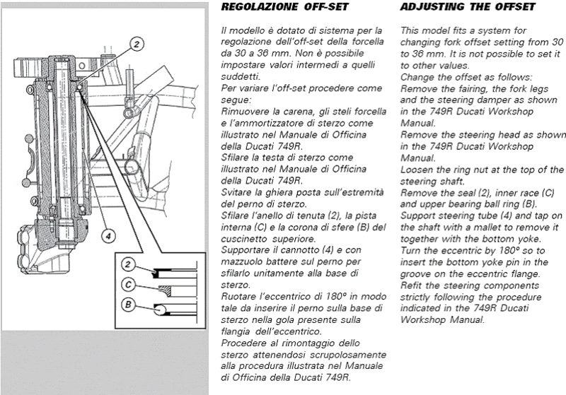

  1. Up for sale is my used 749R triple set. This is a 1:1 swap with the XX9 series.
    As you likely know, the 749R is/was the only XX9 with an eccentric to allow an offset of 36 mm (OEM) or 30 mm. The latter will make the bike more flick able. By altering the rake (i.e. turning the big (frame) head eccentric) to 23.5 degree you will get superb stability.

  5. It certainly doesn't fit all 749. Biposto steering stem is much longer. I had ohlins put on my Biposto and had to have a steering stem manufactured as the S and R ones are too short.
  6. Apparently you're right, seems to be if you have a frame without adjustable steering angle ( some 748, some 749 and some 848 ) then this won't fit.
    They call it an E frame, Econo frame, LOL:joy:
    http://www.ducati.ms/forums/56-superbikes/273297-ducati-749-steering-stem-shaft-length.html
    However all other bikes with adjustable steering angle it does fit.
    You learn something new everyday on forums. :upyeah:
