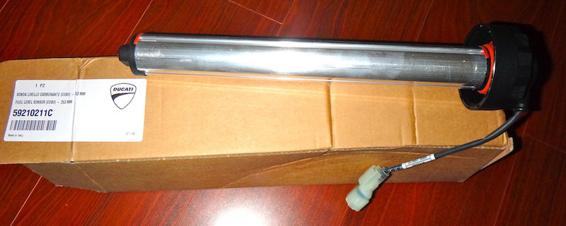

  18. G'Day,
    Just got the newest Ducati MTS Fuel Level Sensor (59210211C) with my parts order.
    Very clear and straight forward, a software update is needed as per enclosed multi language instruction.
    Good on ya Ducati ~ no more secrets and asking questions to dealerships and mechanics.....
    The replaced Fuel Level Sensor (59210212B) still doesn't work properly.
    As the actual fuel level in the tank goes down the fuel level bars indicated go up and the KM fuel range increases ~ weird.
    Shall have the new fuel level sensor installed once time permits and software update is available.... stay tuned...
