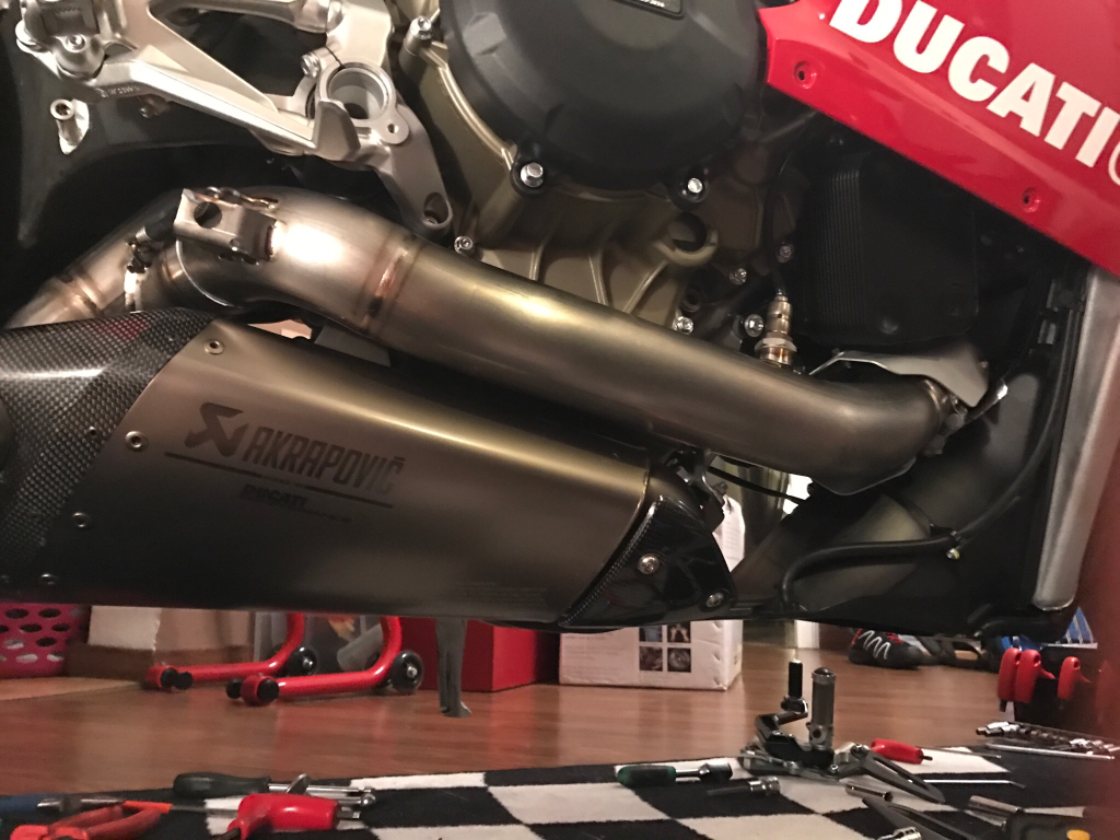

  5. [​IMG]
    Nearly finished... almost time to wake the dead...
