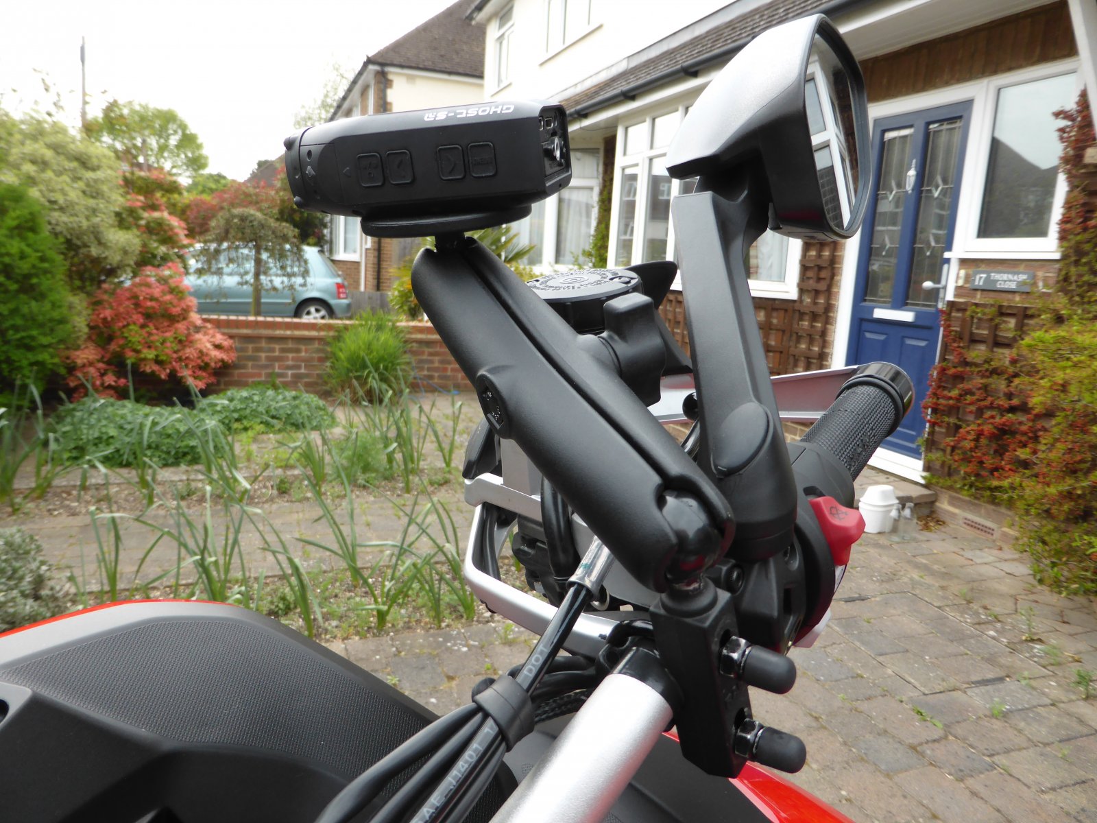

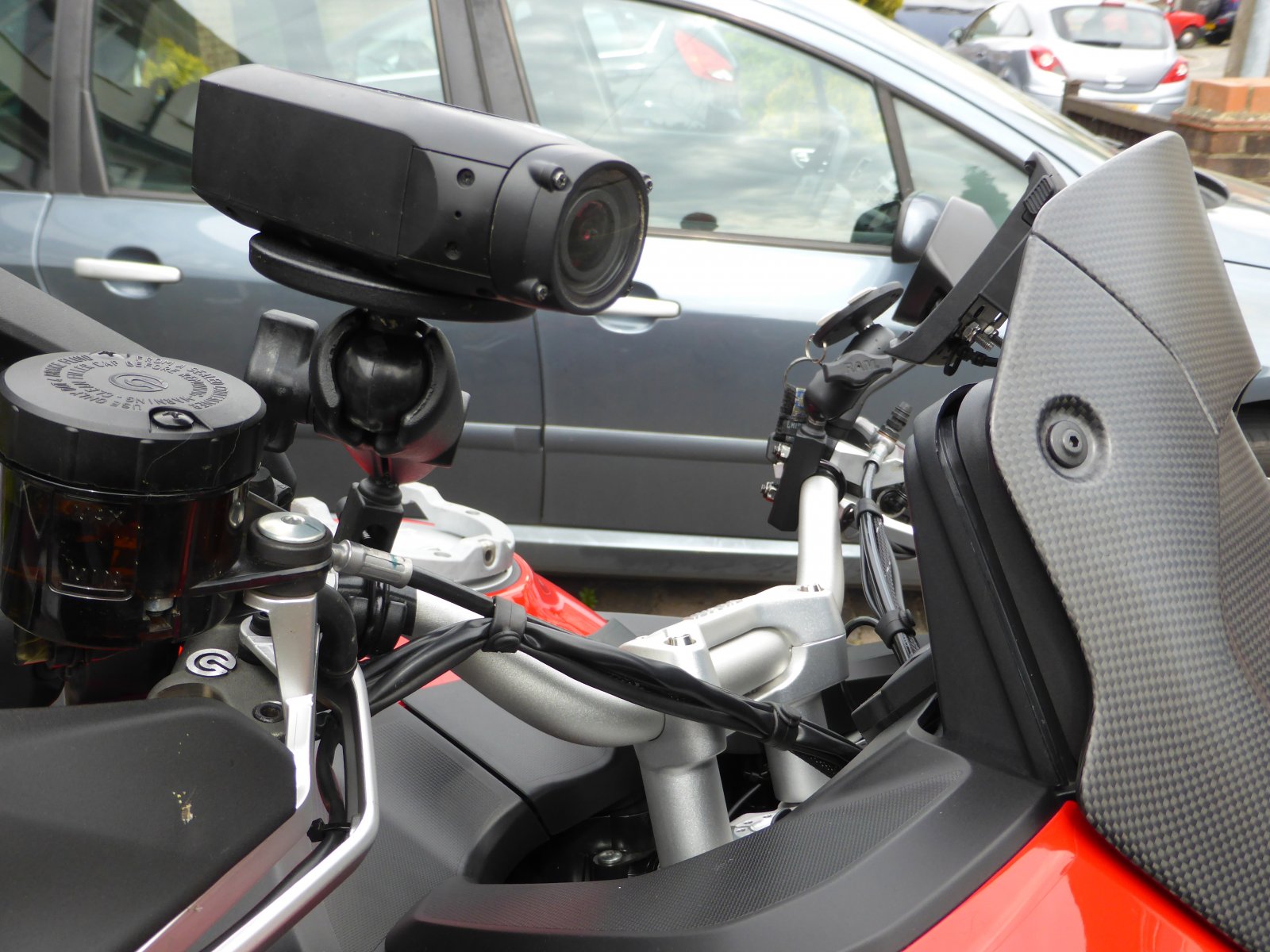

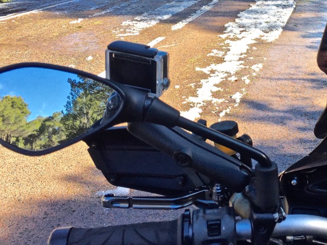

  5. I use a drift camera and ram mounts on my handlebars. Use a long armed bracket to get the camera as far forward of the bars as poss - to the side of the screen in effect. Used it mounted that way on my old 2010 Multi, and it worked a treat. Not so easy to work out the same set up on my DVT, but have kinda fixed it the same way eventually. Not tried it yet, hopefully testing it tomorrow. Have also use the suction cup method on my helmet and also on the rear tail brake light assembly. Gives another viewing perspective, but my preferred choice is handlebar mounting.

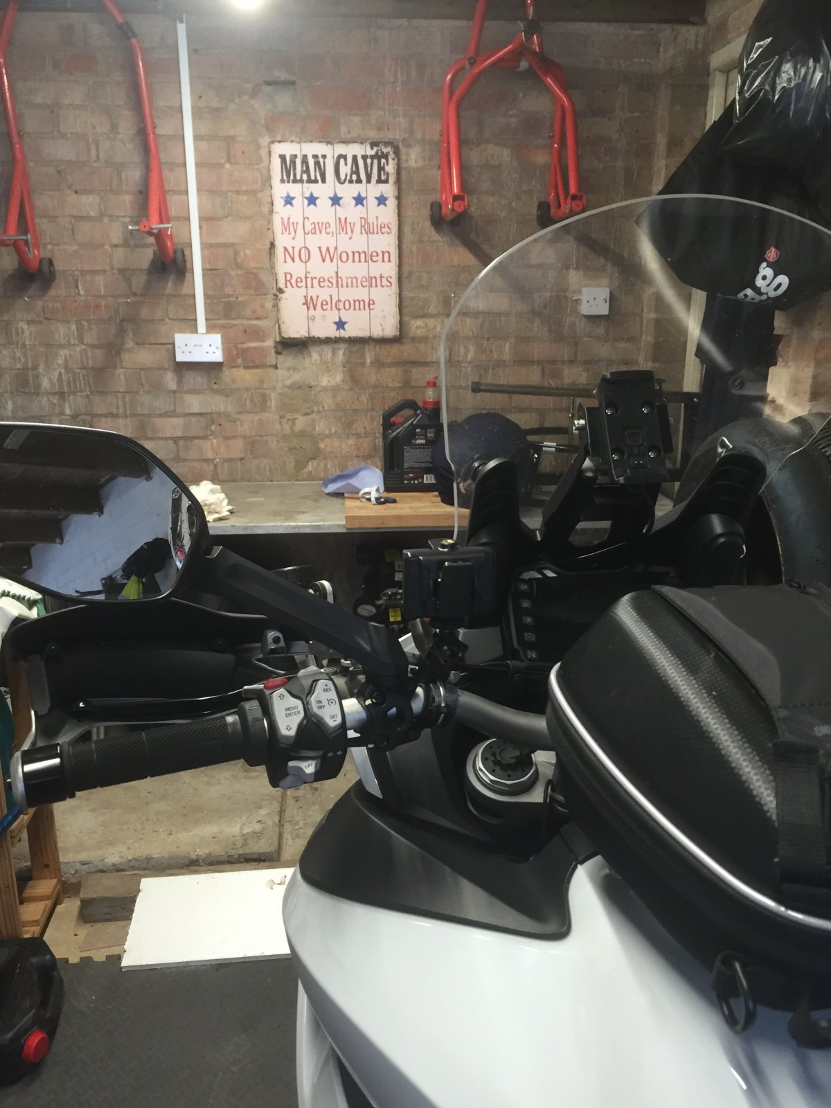

  7. I havent used yet but mine is fitted to the bar with a clamp, usual camera type one, and manages to clear everything when on full lock either way. Its between the mirror and the centre

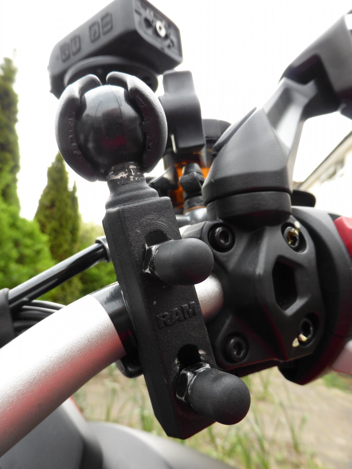

  9. Hi - I run 2 mounts,
    - One on the left hand side of the handlebars
    a very net RAM ball attachment that's attached by the left mirror
    and a long RAM arm to place the camera just in front and above the mirror.
    It's easy to reach to switch on and off with left hand and to see the red light blinking if it's filming. There is some vibration on hard acceleration but not enough to bother me. The advantage is you get a steady, constant view in the same direction ahead of the bike at all times.
    - Another mount on the left hand side of the helmet which is just using the curved mounting plate that came with the camera.
    There is no vibration and the view can be adjusted to include handlebars & front of bike etc for a more involving POV film, ( however I always try and keep the speedo out of shot... :wink:) You also capture your body movements if you're hanging off around corners etc... :tonguewink:

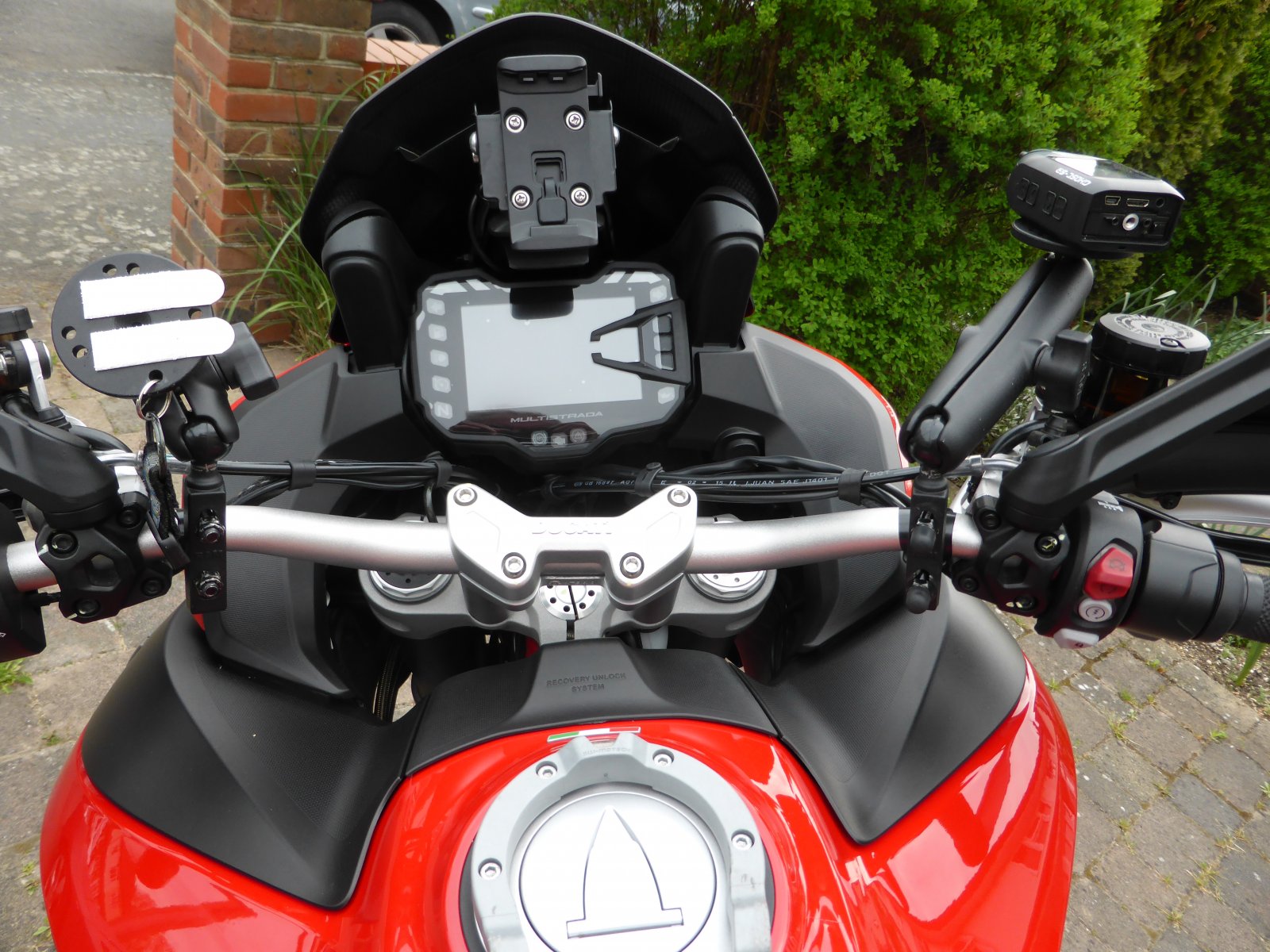

  12. As per my previous post, herewith a couple of pics to show my set up with RAM mounts. Know it won't suit everyone, but it shows you an option....

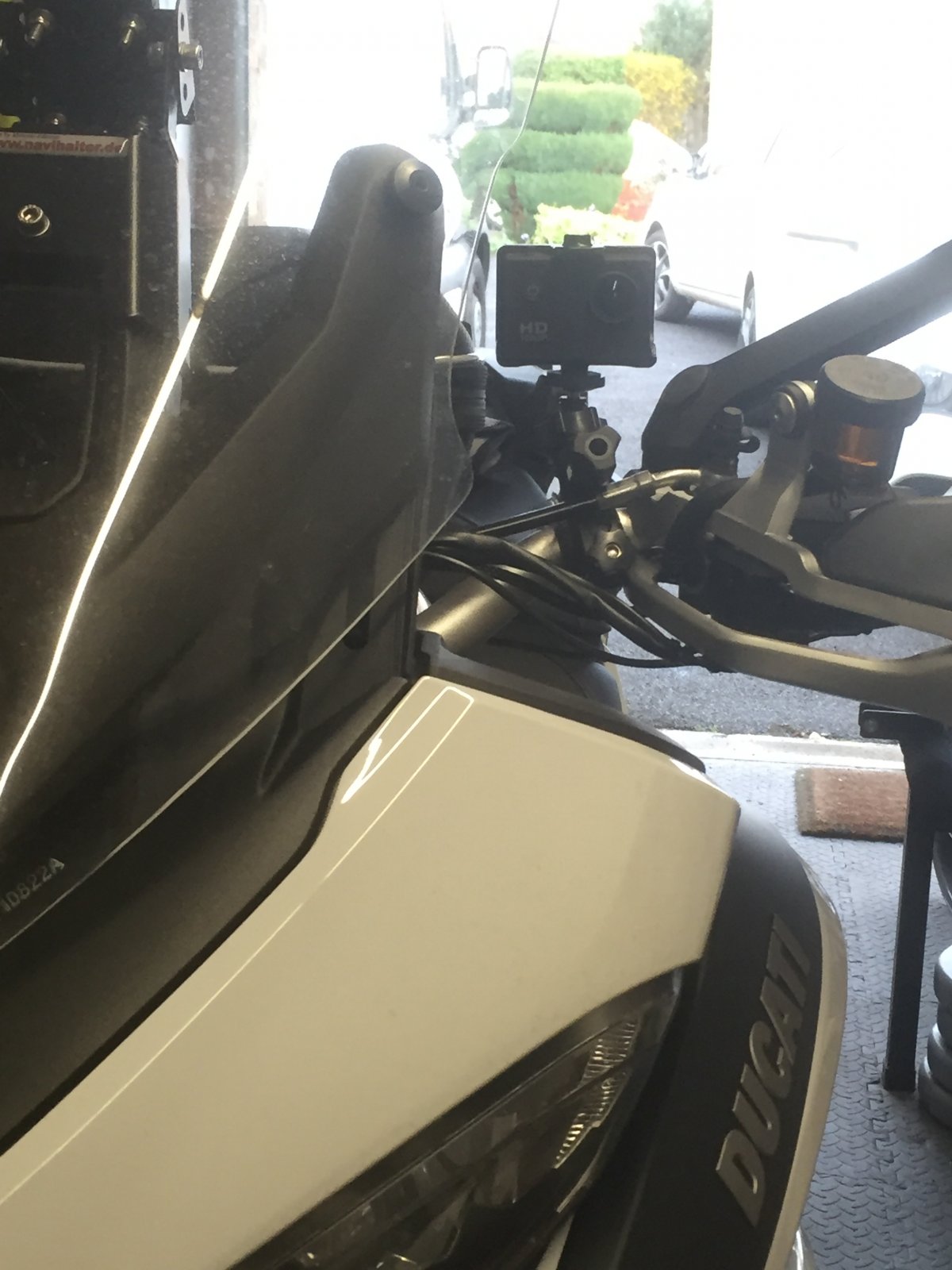

  17. tested today, works fine, no real vibes, will post the most boring bit I can edit in ;) but happy with my set up

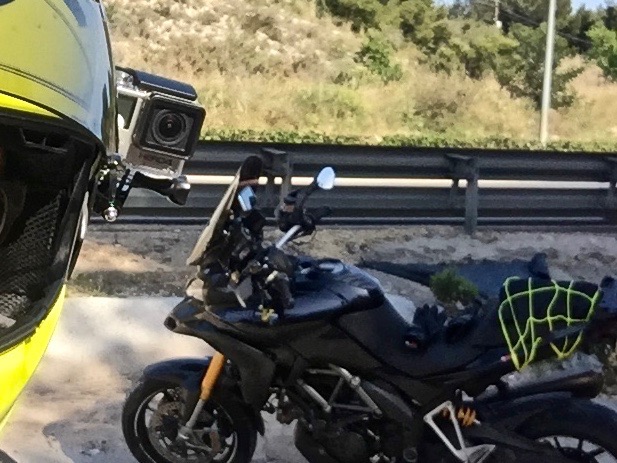

  19. I used helmet and water pump hose mount in this video:
    I'll try to upload some pictures of such mount.
    L's
