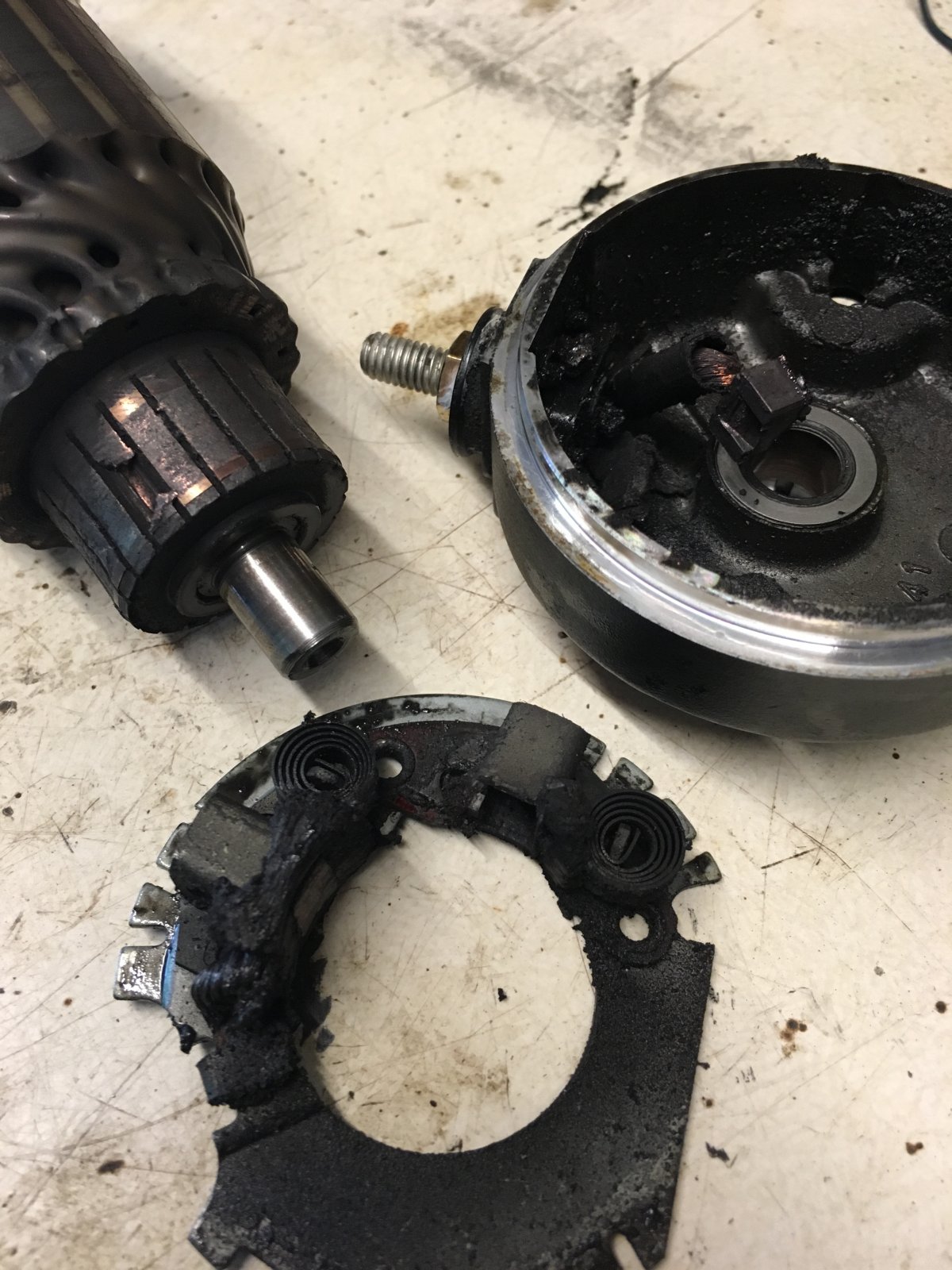

  18. Hi.. First of all thanks for the advice in diagnosing this issue.. Replies have been really helpful, so much so I had the confidence do the work myself, and glad I did as it's not a difficult job. Made up a small case pully tool and it was a good opportunity to changeout filter and fluids.
    I thought to post my findings here if it can help anyone in the future.
    Having got the motor off yesterday yes it was poked. Pic attached.
    Unfortunately not just a brush set fix (and the local alternator refurb shop says can't do anything with it) so will replace the motor.
    Thanks again for the support.

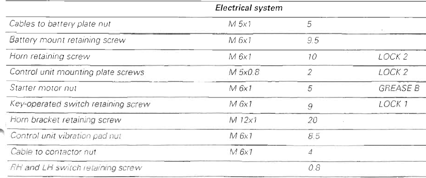

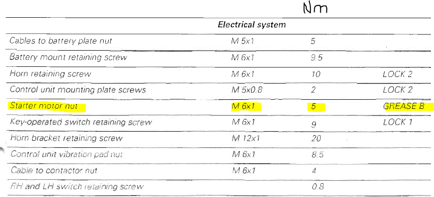

    (PS: anyone have the torque settings for the starter motor and crankcase cover screws?)
