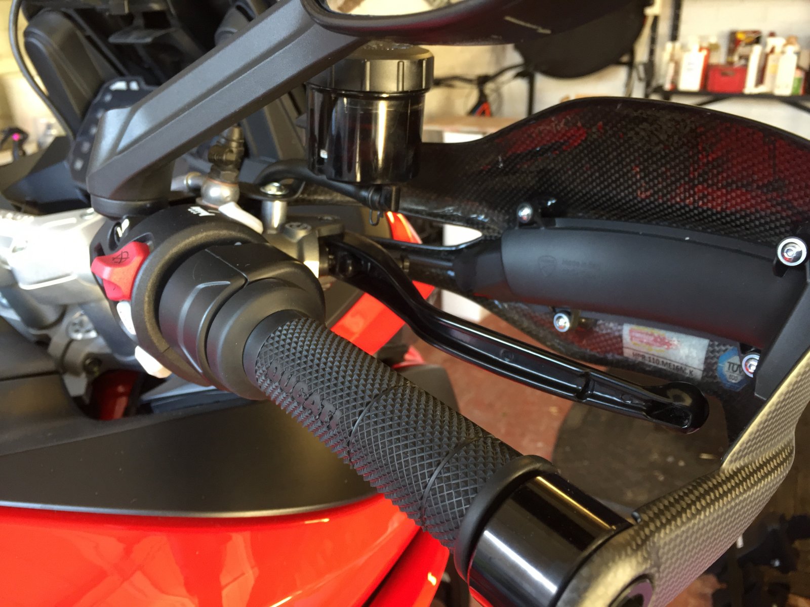

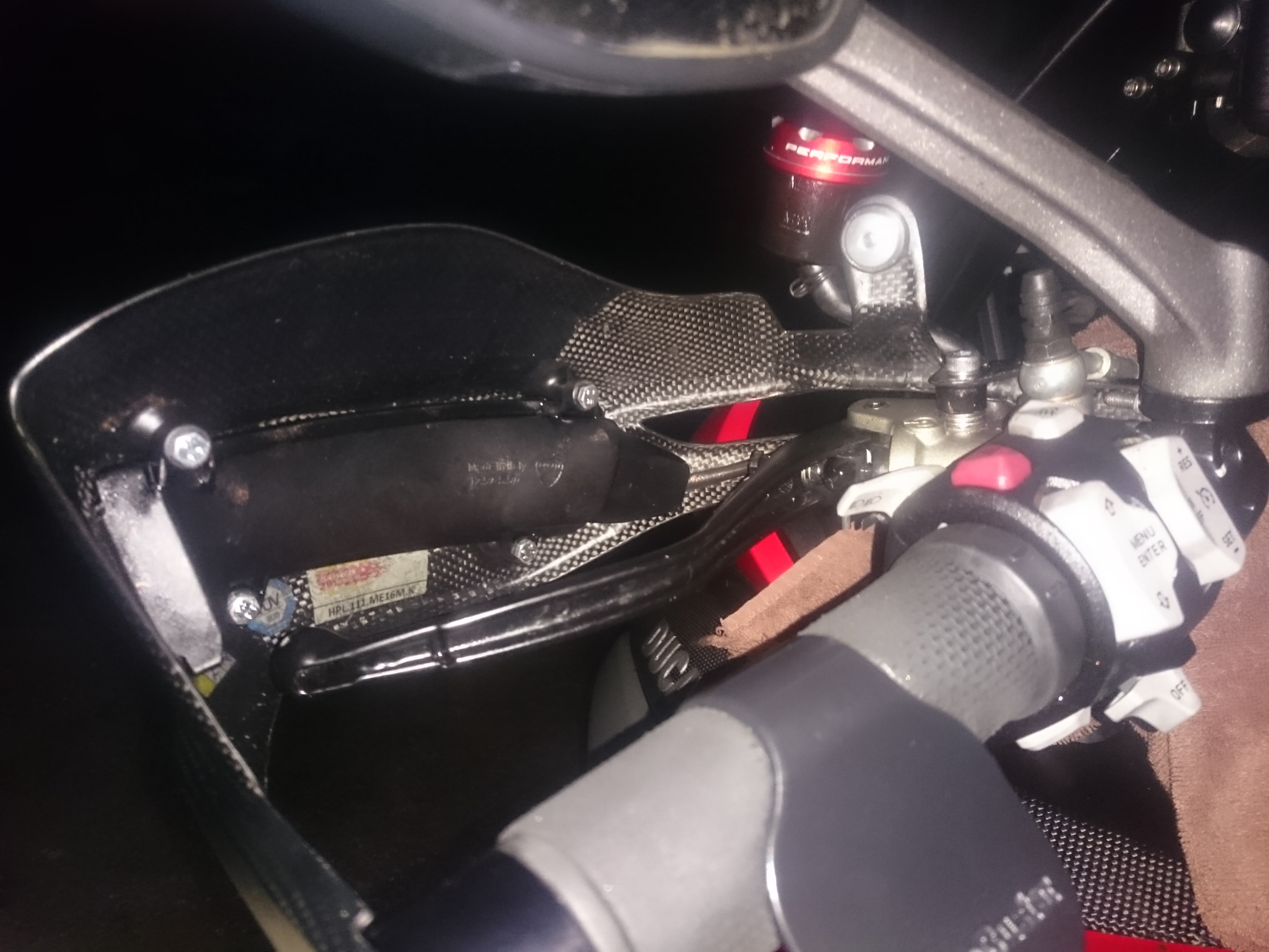

  2. Well the adding of handguards spiralled out of control & took most of 4-hours. Even though I've replaced one already due to dropping my bike turning it around. The hole for the brake reservior needed opening up (using a good size round straight file) and so did the fixing points on both sides that get bolted down with black spacers. I had to add four 6mm washers under each spacer (as shown in image below) because the fixing point wasn't sunked like the plastic profile handguards. I also had to use different screws for the indicators due to using standard course thread inserts. The ones you have on the enduro will not work. Also those bolts & double fixing point bolts by mirror assembly had to be longer too work. So a few trips back & forth to my local fastening shop covered that.
    Above the red hazard button is the location of the extra 4 washers. A bit of filing was also done to make the right hand size indicator sit more correctly but a rubber draft exluder type of seal might be added to make both more air-tight so too speak! The clutch res didn't have the little dimple insert point but that caused no problem remounting it.

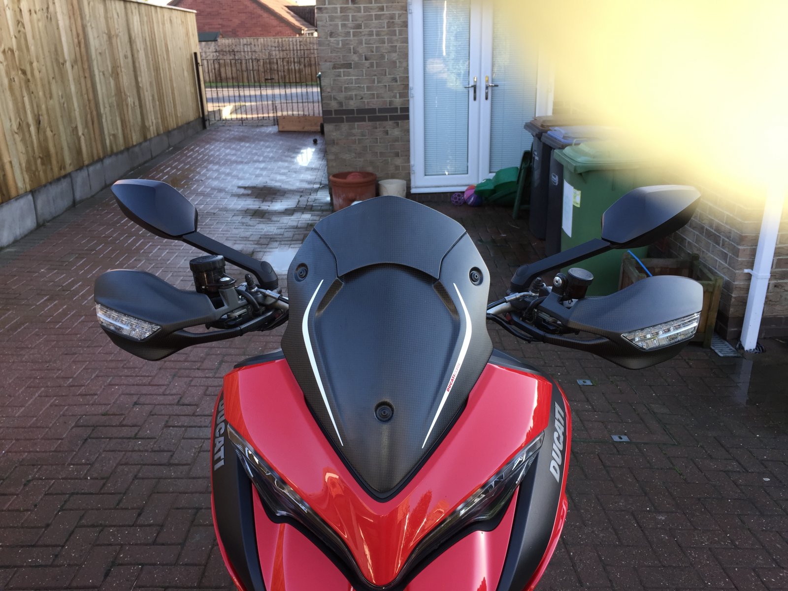

  7. Finally fitted my hand guards, didn't have the same problems as GZB, there was a plastic envelope with all the necessary screws and spacers in the packaging.
  8. Nice, might send ilmberger a polite query over where my screws&spacers ended up!
  9. @Blairso they look great, pity their not gloss though :)
    Are they bigger than the oem stuff (do they keep more of the elements off) and are they an easy fit, or is there some fiddling ?
    p.s. Did you get them straight from Ilmberger.
  10. They're the same size as the original, but in one piece rather than 2. They are easy to fit, had a slight problem with one of the indicators and had to slot one of the holes a fraction. A tip I found is to run the screws that hold the indicators into the holes before fitting the guards, as a couple of them had resin slightly blocking them. I bought them direct from Ilmberger.
