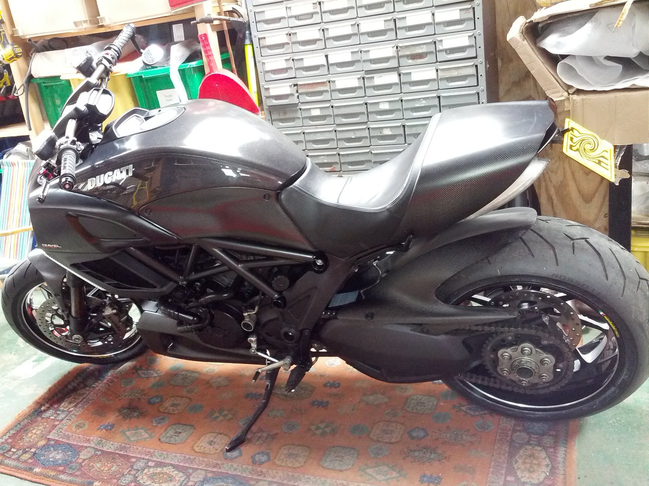

  7. Excuse the messy background, but here's mine with LSL drag bars. I'm tall so these give a great position & get me out of the wind a bit. No mods to cables needed. Also showing Pazzo shorty levers & tail tidy :)
