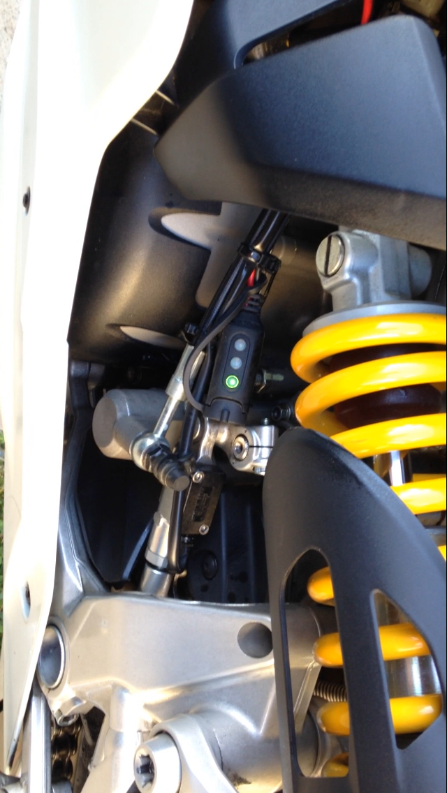

  12. Thanks for this - made it that little bit easier and got my CTek lead on :)
    I got one where it shows the battery level so I can keep an eye on it easily. Only £5 from CTek!
    #12 Cake, Nov 7, 2016
  13. Was it the m6 or m8 eyelets you got?
  14. now thats cool :upyeah:
  15. M8 but they were very big and I took all other eyelets off and put them under to keep on; so M6 would sit on top no issues I'd say.
    Basically you can go either way :)
  16. Thank you....AWAY TO THE INTERNET!!!!
  17. Just worth noting that these work perfectly with no interruption so only take the light as reliable when not touched for an hour.
    If you turn on the ignition or anything after it won't be reliable until everything is off again for an hour.
    Perfect for looking in the garage and checking all okay :)
