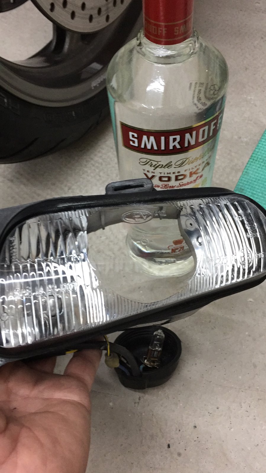

  1. I know this has been covered lots of times but I decided to have a go at cleaning my milky headlights. Can't believe how easy these bikes come apart! Found a great cleaner in a box in the garage, maybe not a good idea if you're in a weak frame of mind!!:tearsofjoy:
  2. Gin is a lot better and not so much of a waste :Bag:. Andy
  3. One of the reasons why I love this bike, just so easy to work on compared to the newer bikes. That's one of the first things I did to mine. Makes a massive difference to the look of the front end. :upyeah:
  4. Definitely mate, looks spot on now. Fitted a mph clock which is like new so just need to spend a bit of time with the drill to correct the mileage! Do you know if the speedo drive is different gearing or is it sorted inside the clocks as mph to kmh?

  6. Pretty easy to be honest, once the headlamp is out I just got a small socket extension with a rag taped to it, soaked it in vodka :tearsofjoy: and just rubbed it in! It was the only alcohol I had!!

    You guys were right - dead easy to do. And the lights are now sparkly and gorgeous!
    But...on trying to remove the sidelights (changing to LED bulbs while it's all apart), one rubber 'plug' thingy came out ok, and the other one didn't. I mean, it came out but the wires ripped from the spade connectors. Gutted. And annoyed at myself..! Any tips for prying the spade connectors open? Fine flat head screw driver I'm guessing - unless there's a trick of the trade...?
