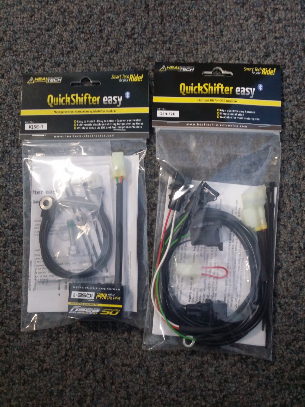

  1. Well - ordered this yesterday...bit of a leap of faith as ive never been able to find much in the way of documentation regarding qs's on 1100's. Theres not much room in the linkage (well, lets face it, theres no room in there) and ive seen bad photo's of the qs bolting behind the gear shifter so, this seemed to be a tidy solution with wireless connectivity for setting it up....petrol oring spigot thingy's got delievered this morning home so I'm gonna push and see if I can get this, the gear indicator (healtech) as well all done at once....

    The qs senses the shifter being moved (up in this case) cuts the ignition which for less than a second which unloads the gearbox and then the ignition starts again... All in about a quarter of a second... And you get a lovely backfire on the change... Bloody addictive...

  14. Nope... Far from it... Everything is plug and play... No splicing.... The injector plugs, plug inbetween the existing injectors... My z1ooo took about 3 hours to do and not because it was difficult... I was just taking my time... I suspect this will be easier as I've not got to mess with the shift bar... If your interested in doing it I'll be as thorough as i can with the pics... If your near Bristol I'll help you do it.

  16. Well it's all in and back together....it starts (which is good), it doesn't leak any fuel (also good) but not configured the qs or been out for a quick test run.... I'll be doing that in a bit... Fitted the gear indicator at the same time but when I fire the bike up its giving some letters and what not on the display so I guess it needs setting up whereas my zed just worked but obviously it's a newer bike/type of ecu I can only guess...

    1. The qs mechanically isn't working but ive not played with anything yet.
    2. Bluetooth connection works and did a firmware update... When the bike is ticking over the app pics it all up...
    3. Gear selector is working.
    4. No fuel leaking (happy about that)
    Think I just need to piss about with the app when I get back... Pics later...
