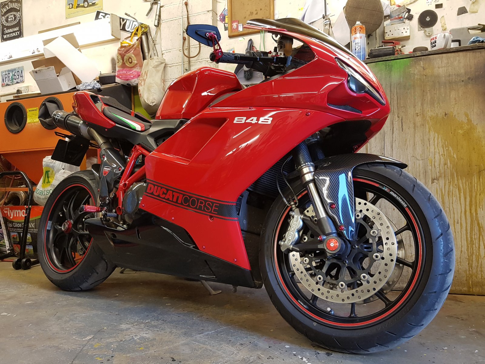

    I'm looking for help advice/real experience/pointers for metzeler tyres for my 848. I'm down to ether Z8 interact or sportec M5, I would like great grip/handling and longevity, Its my first Ducati
    bought in may and love it, Came off Honda's, been riding since my 20's.
    The idea of the Ducati is I love Italian bikes (own and been riding Lambretta's all my life as well as bikes) and to enjoy m commute which is 32 miles each way, mixture of motorway but mainly country roads, lots of twisty winding but poorly maintained mostly in deep Somerset, Bridgwater to Castle carry if any one knows it.
    I like my tyres to last at least 4 plus ideally 5 plus and have great grip as it is a rubbish road and comfortable as can be.
    Its on Dunlop Qualifier 2's, they were was allegedly new, rear has less than 1 mm in the centre and 3mm edge, done less than 1600 miles. I'm usually enthusiastic when permitted. Looking at doing 6k a year maybe more.
    I know there stuff out there and I apologise if its been covered but I cant find much actual experience. I'm not tight but 2 sets of tyres is too much having a family and a fleet of other cars to keep.
    Thanks for any help advice
    Cheers Mark
