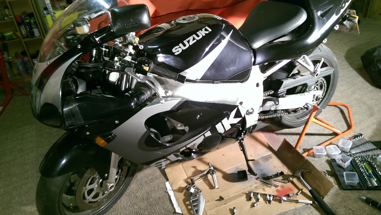

  1. So, went to take the bins out and accidentally spent an hour removing left rear set and chain guard off my SRAD. She has been massively neglected, forever really, and spent many winters under a cover shivering and dreaming of a dry garage. Intentions mid-term is a spruce up and general overhaul to get her ready to do track days on next year. She will need to stay road legal, at least a daytime MOT.
    What I'd like is any general hints and tips on striping and rebuilding. Useful tools and products. Do's and don'ts.
    So far I have 2 shagged bolts out of the 8 removed. I got out thanks to mole grips, the other is for the heel plate and will need drilling.
    TIA.
    PS, sorry it's not a Ducati. Or red.
  2. probably an obvious one but penetrating fluid on every bolt a few days before commencing the assault can save a lot of agro. i see you got ya lil containers ready:upyeah: i used plastic bags and stupidly wrote what things where on the bags... although i used permanent marker it came of most with handling with greasy hands so i put lil paper lables in the bags after that.
  3. They are actually full with different screwdriver bits. Cross head, flat, hex, star, etc. Yes, I'm that anal. Yeah, I need to get out more.
