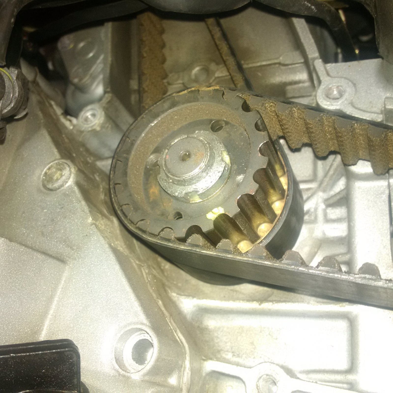

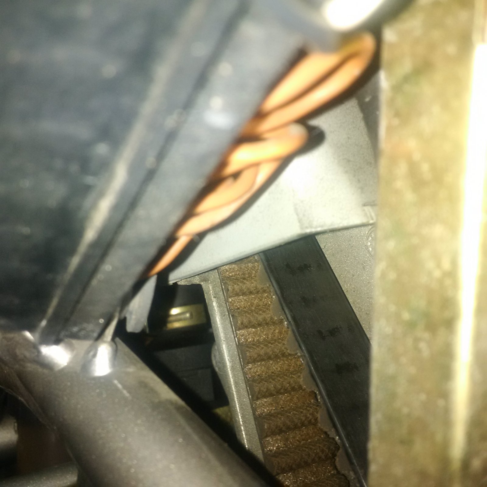

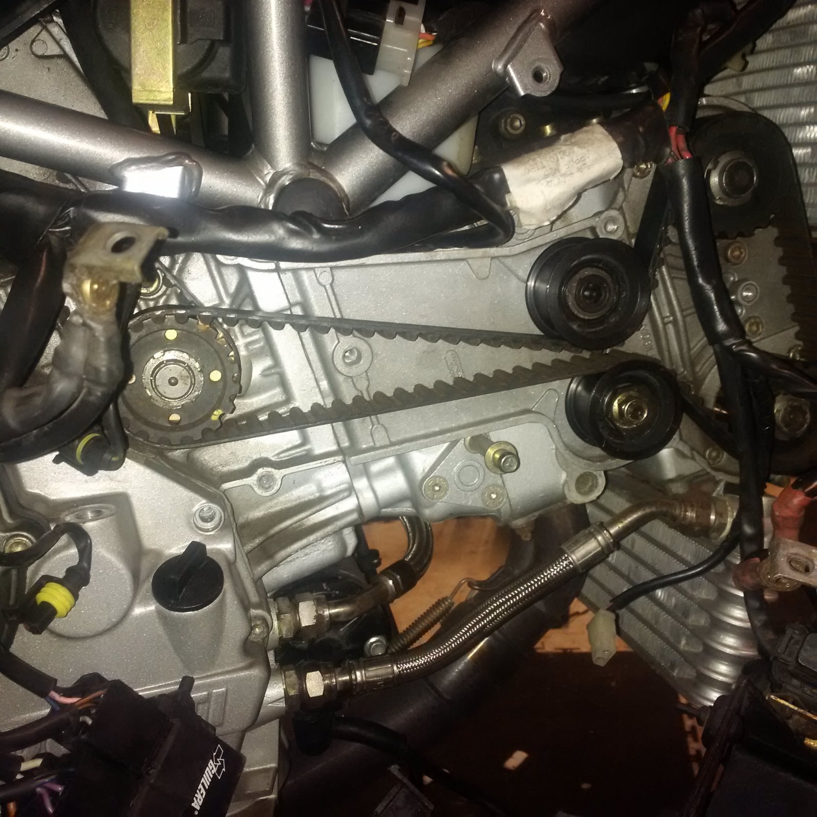

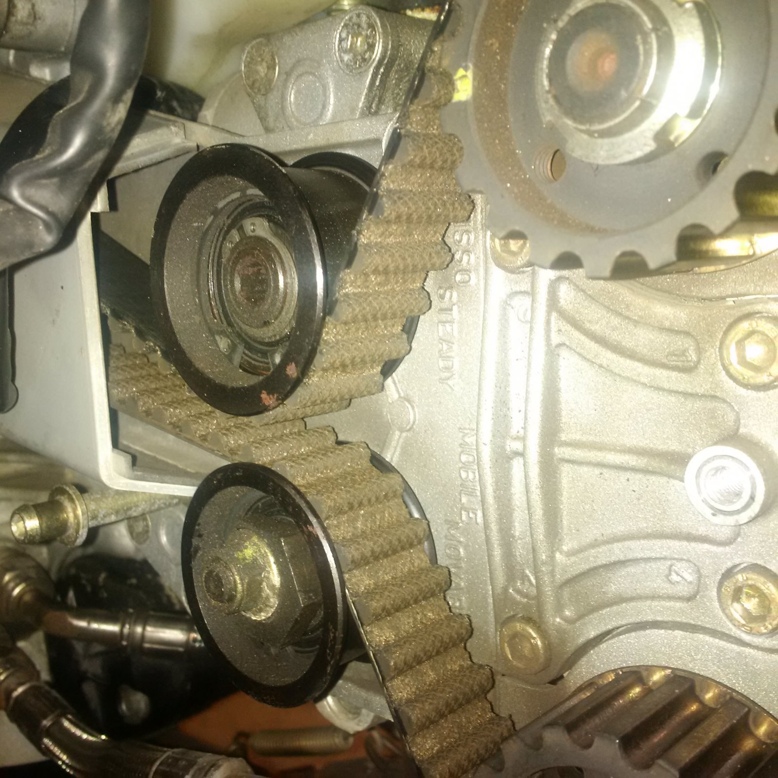

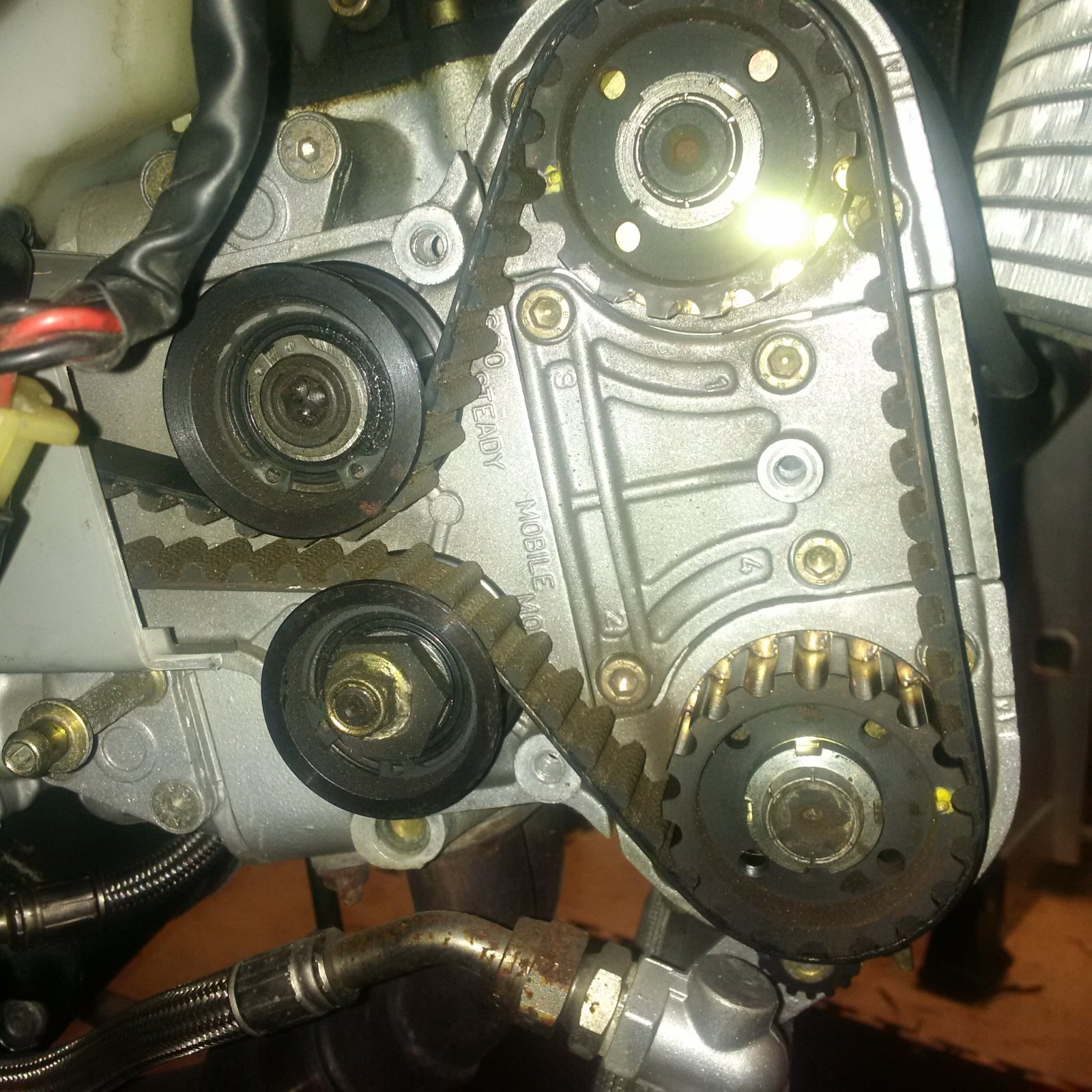

  1. Whilst i await delivery of my gloves ive decided to do what any self respecting boy does which is to break and rebuild his toys before playtime....
    i removed the front and centre covers and took some pics... before i tell you what i know pls let me have your thoughts on
    - how borked they look
    - does everything look as it should esp re fitment and pulleys
    - would you be rushing to get them replaced ( i know i will asap but is there a sense of urgency)
    and if anyone thinks its funny to say stuff like they are on backwards and youve got bent valves pls try harder!!
    cheers chaps
  2. Your belts aren't rubber coated on the teeth :Wideyed:

    Thing with belts is, they can look fine but you don't know. They either work or they don't. Like Exie says, go on time and mileage. If you don't know when they were changed last, change them for what they cost.

  6. Ok so here's some facts.. the bikes and 02 with 9.2k miles
    The belt from top of tooth to the underside of the belt measures around 4-5mm
  7. As exige has said the inside of the belts seem to show the cord a bit more prominent than my two year old belts on the bench, so I presume they could have been on a while otherwise they look ok, adjusting pulley has been turned anti-clockwise so that's ok, nothing else to report from here.
    Steve
  8. They look slightly yellow.

  9. Visibly no obvious issues looks pretty damn clean under that cover :Watching:
  10. Yes, I am afraid they are thoroughly borked.

    I was told the belts were about 2 years old but there's no paperwork to prove it and I had no reference point. There's no markings anywhere and the underside is shiny in places. The bikes done fewer than 3k miles since the belts were changed. I've got no reason to think the guy was lying he was a straight up guys whose best riding years were behind him.
    In any event I was going to get them changed regardless for peace of mind and to get a baseline established for the bike that I can work off
    Glad to know they are not the worst you lot have seen and I can get some miles under my belt now witout too much paranoia!

  18. If you read the owners handbook, the 748R belts require changing annually. The belts are 22mm wide unlike the 748/s/sp/sps, 916, 996. If it were me there'd be no question, change them. Andy
  19. If they don't have any printing on then it looks like he has fitted some belts he has found in some spurious auto part shop. As far as I am aware only Ducati do the OEM expensive variant and then there is little old me with the superior engineered CCW belts. Both of which are printed. I don't know of any other that are designed for the 749R.
