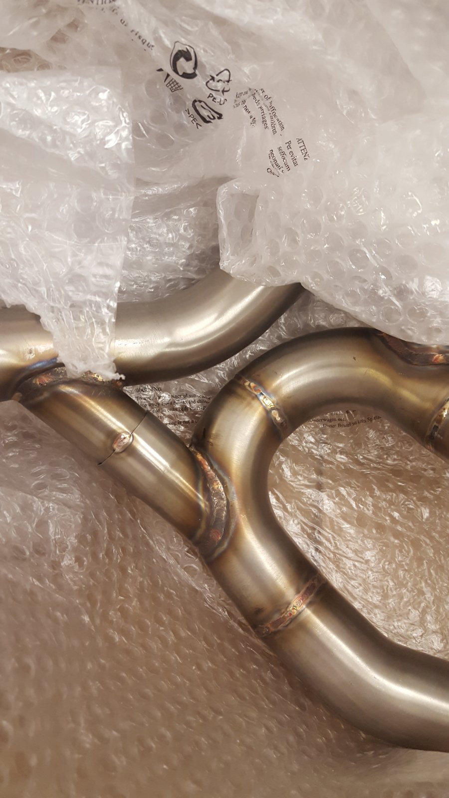

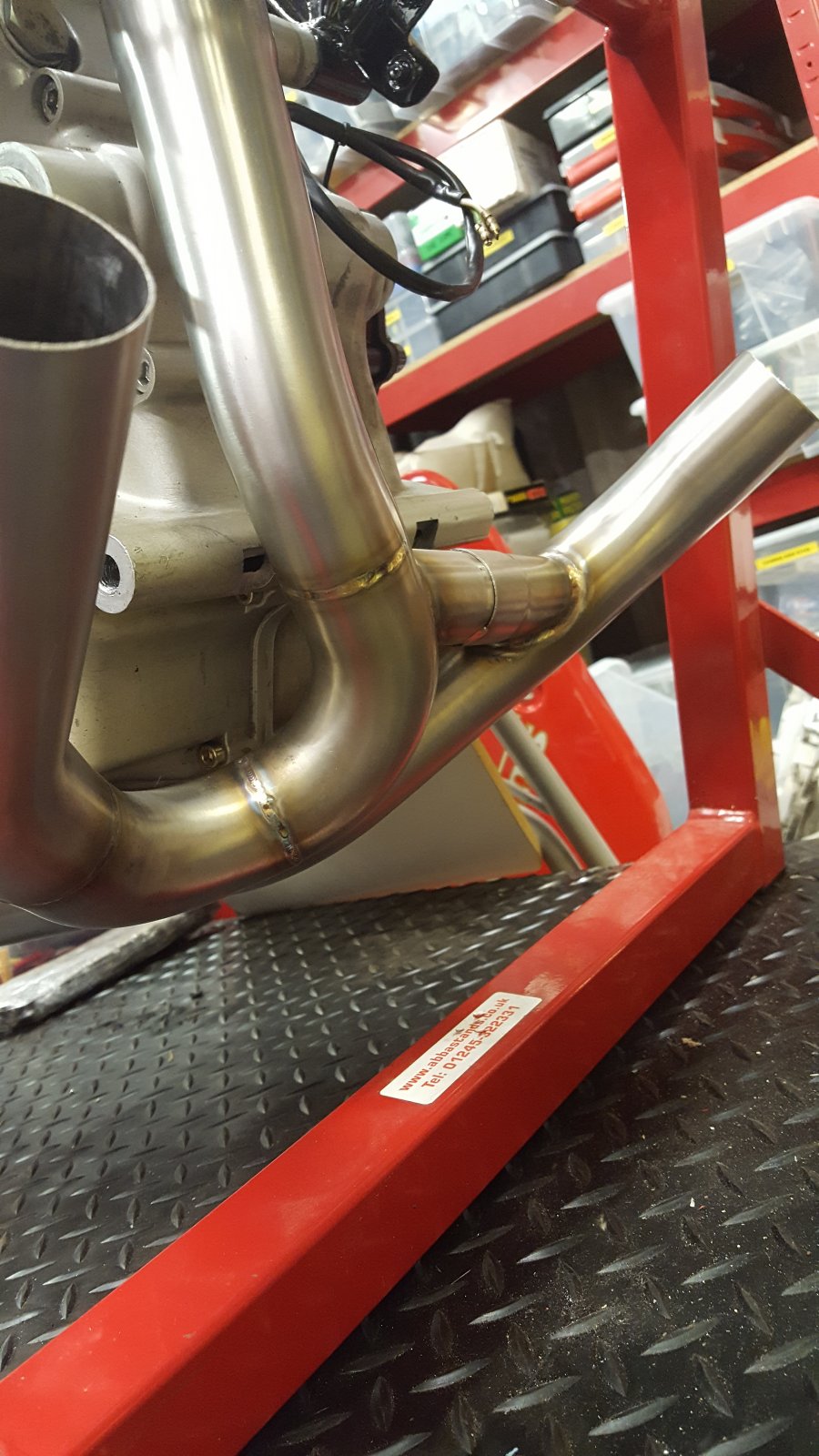

    Anyway as re the pipes, when I got the Sil cans I couldnt stop thinking about the full system, eventually caved in to my inner lust and got them for about £540. A hell of a lot of money.... So I can tell you this, the bore is larger, they look awesome, and they are light as hell, thought the box was empty! You get no plugs for the threaded holes, I had to make a couple on my lathe, easy done. I have since found they are no Spaghetti headers like the Termi system, gets a bit technical but basically the cylinders exhaust ports are not flowing the same, apparently the Termis are designed slightly better....good luck finding some of them.

  5. The headers dont quite look like that image.
  6. I never owned any but know people that have and know someone that makes them...I'd be reckoning on about 1bhp!
