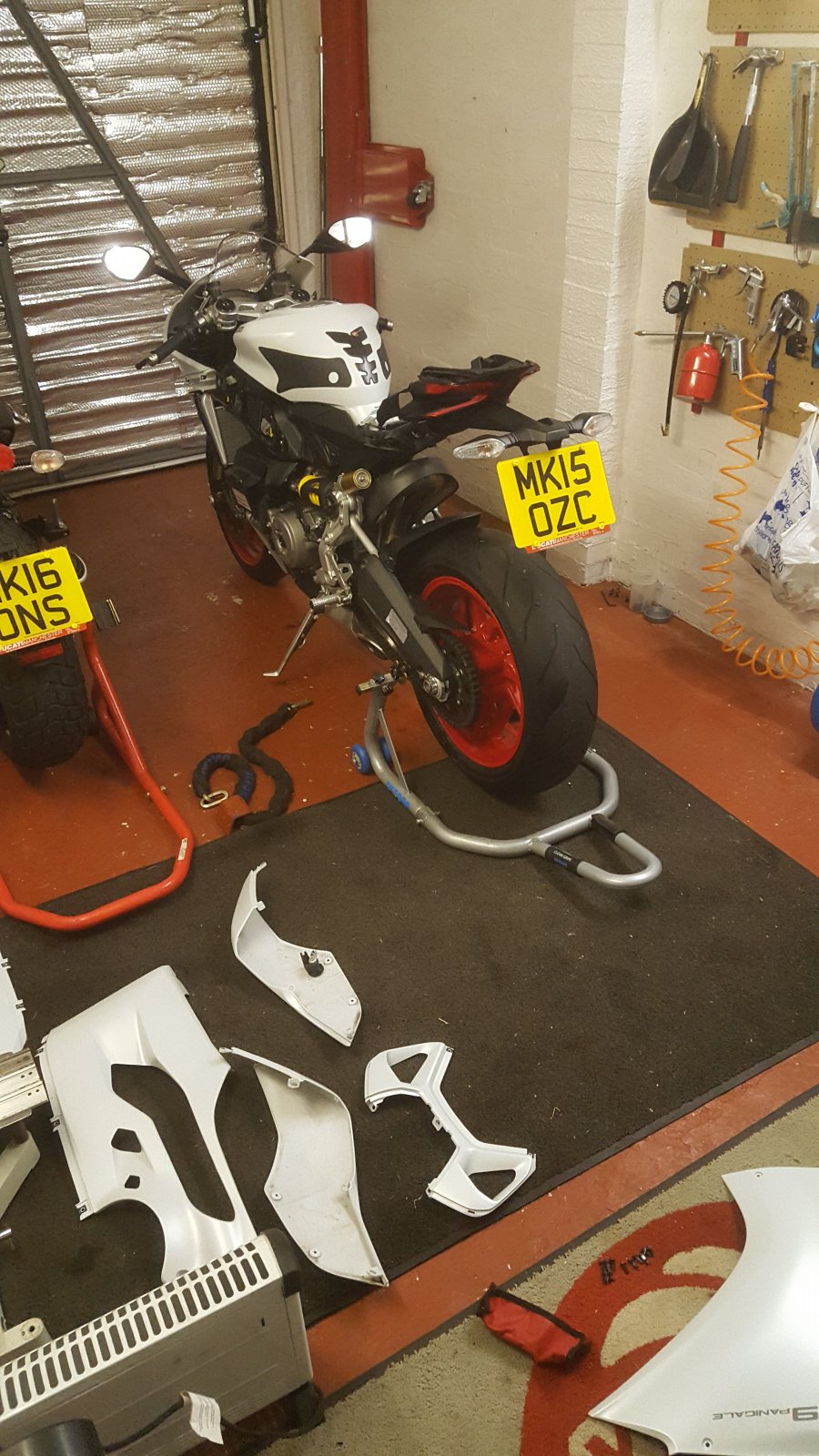

  1. Well it was 8 degrees yesterday near me...but bright and blue, i couldn't resist. As my old grandad used to say "theres no such thing as bad weather, only bad clothing" so i wrapped up and had a fun few hours! There was a bit of salt n shite on the roads so it was a 3.5 hour deep clean(or meditation as i like to call it) when i got back! 20161227_153144.jpg
