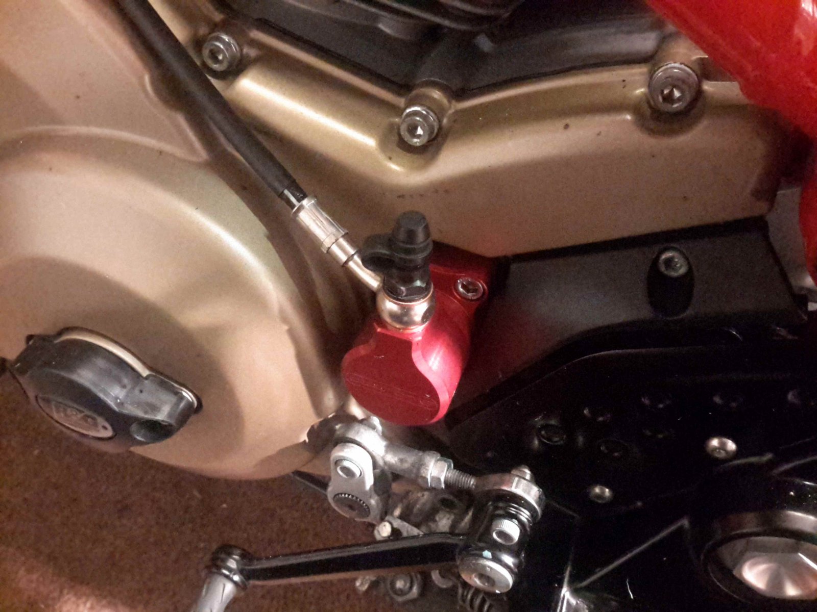

  1. Back in the Ducati family for a few days now... Rode it home for just over 3 hours and rode it to work the next day and decided tonight to get started on the fettling.... Fitted the oberon clutch slave last night....

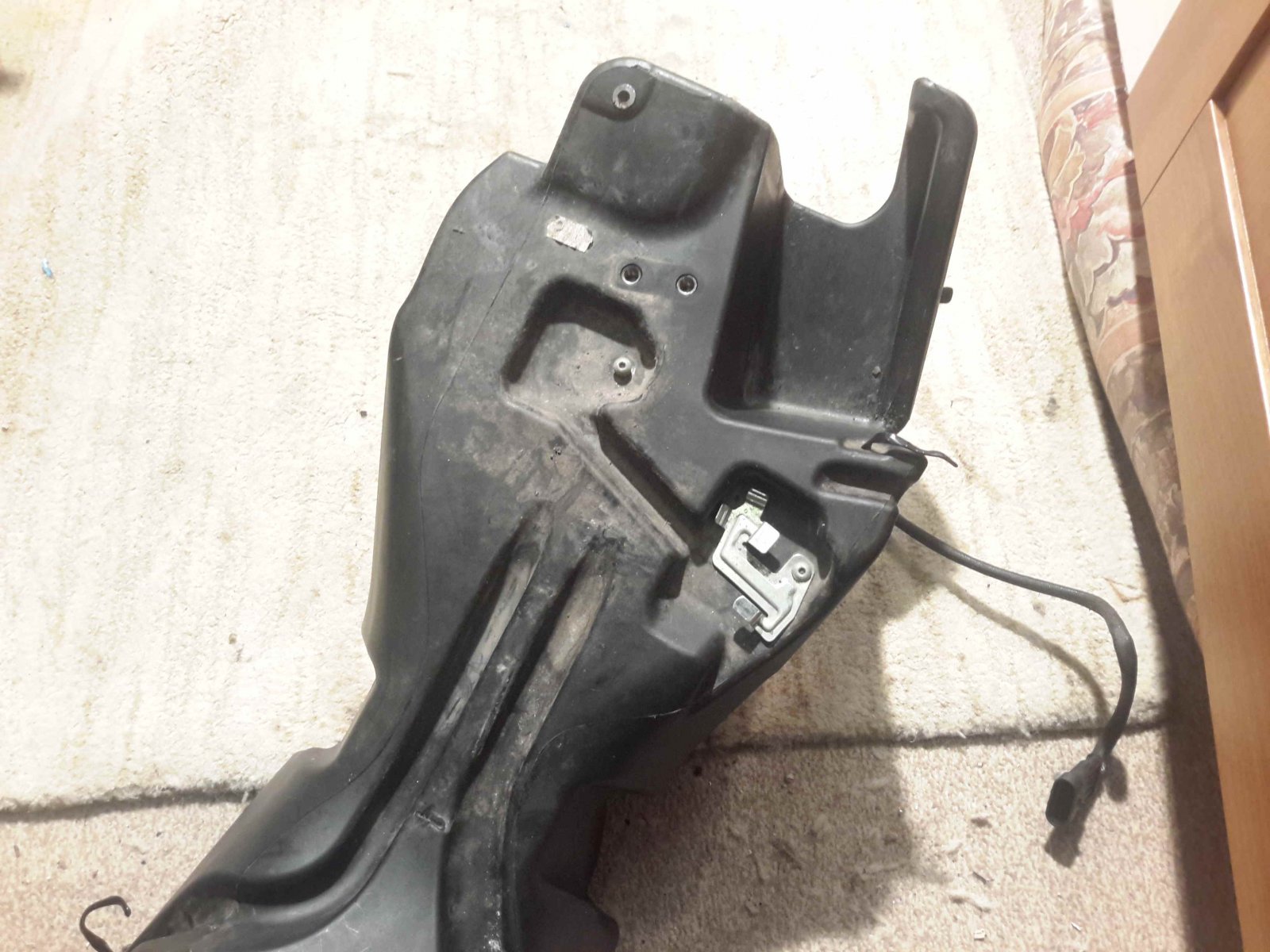

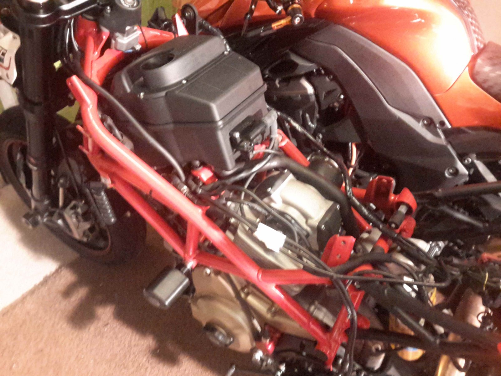

    Tonight I decided to get the tank off and have a look under the hood as it were. I'll be the first to confess that I'm a little bit googly eyed when it comes to buying bikes... Theres nothing wrong with this one, but, it's just been ridden and not really looked after as it should. It looks like the tank hasn't been off for a long time so underneath was pretty grubby but it's cleaned up well...

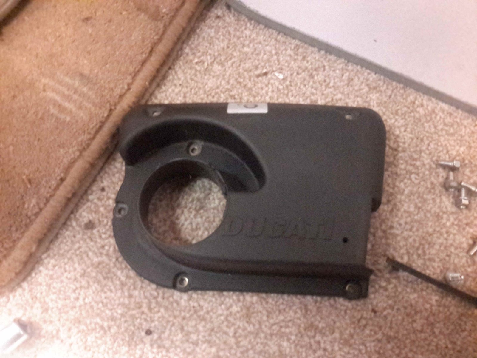

    The airbox had not been modded so thats been sorted out with a hole cutter a La...

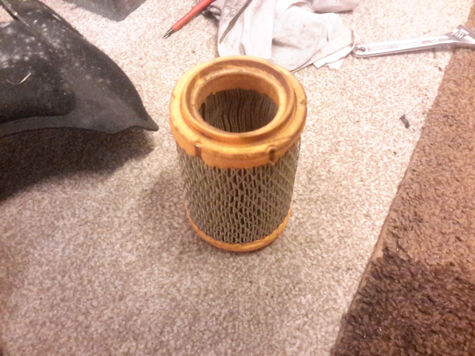

    Going back to what I said about not really looking after it the air filter was pretty knackered and was a cheapo one..
    I'll be replacing it with a k&n unit... I'm planning on keeping it for the foreseable future so it makes sense. Sounding like a broken record the fixings are the worst part....

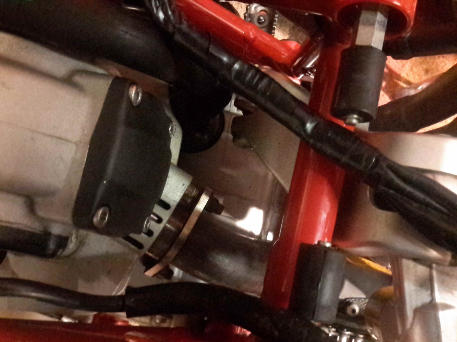

    Exhaust studs a totally rusted and thats the top cylinder ones...! Bottom ones are worse so ive made a start on the fixings also.... Yet to clean the tank up...

  5. K&n ordered..... Think I'll be doing an oil change as well.... Hi flo filter on there at the moment... I prefer k&n filters and probably based on the cost cutting air filter it's probably got cooking oil in it.... Silkolene pro 4 fully synthetic will be going in...

    The Oberons are good kit arnt they , did you get the 1mm bigger one ...just makes the clutch that bit lighter .
    When I got the cylindrical k and n it did sit a bit proud of the lid , the lid was distorting a little as you bolted it down , I ground it down at the soft edge on the filter ( keep it square ) just so the lid fit snug .Post some pics up of your fettling as I know you like taking pictures .

    Cleaned the tank off and replaced all the bolts that go into the tank with stainless jobbies, looks a lot better now...
