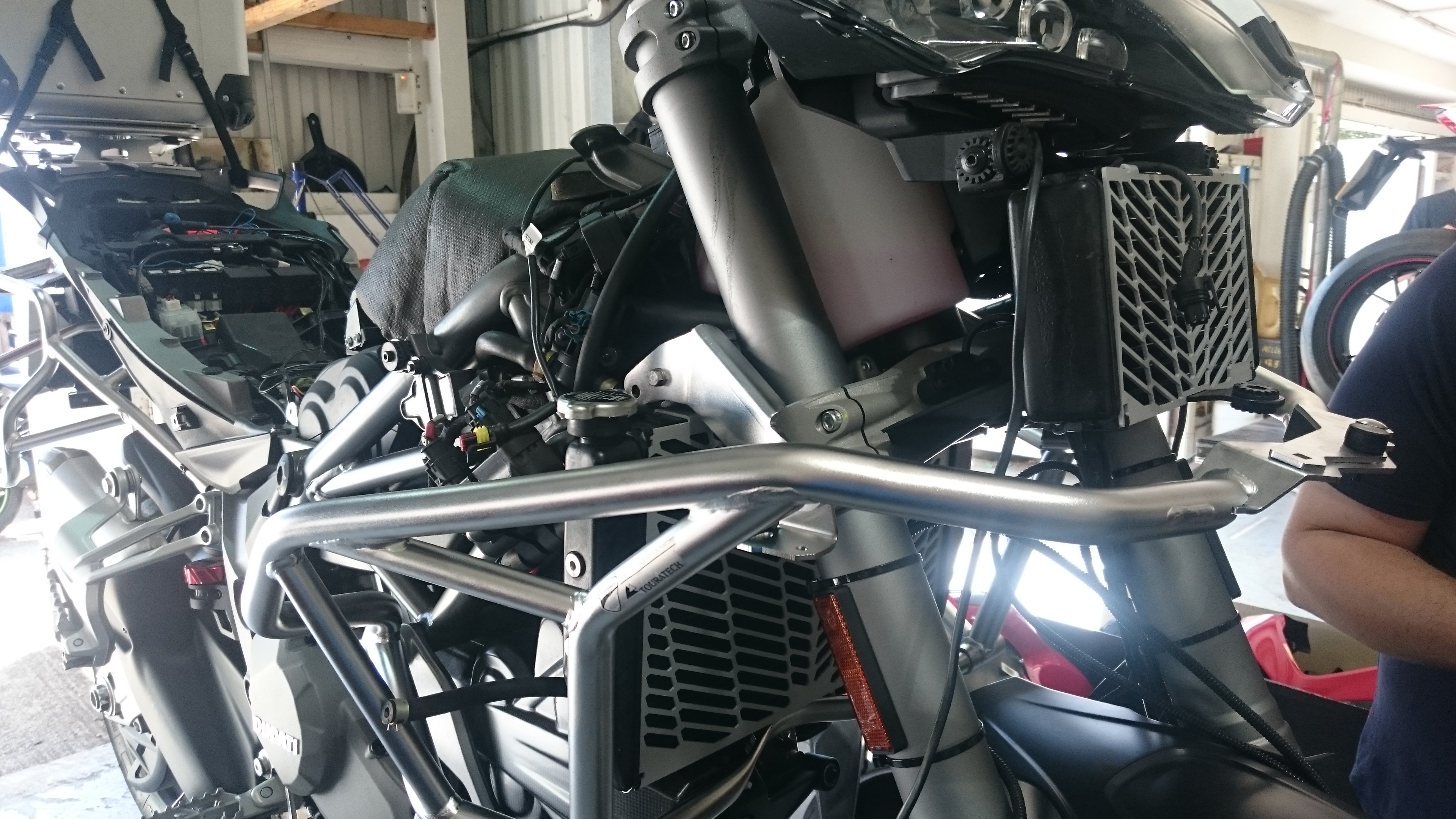

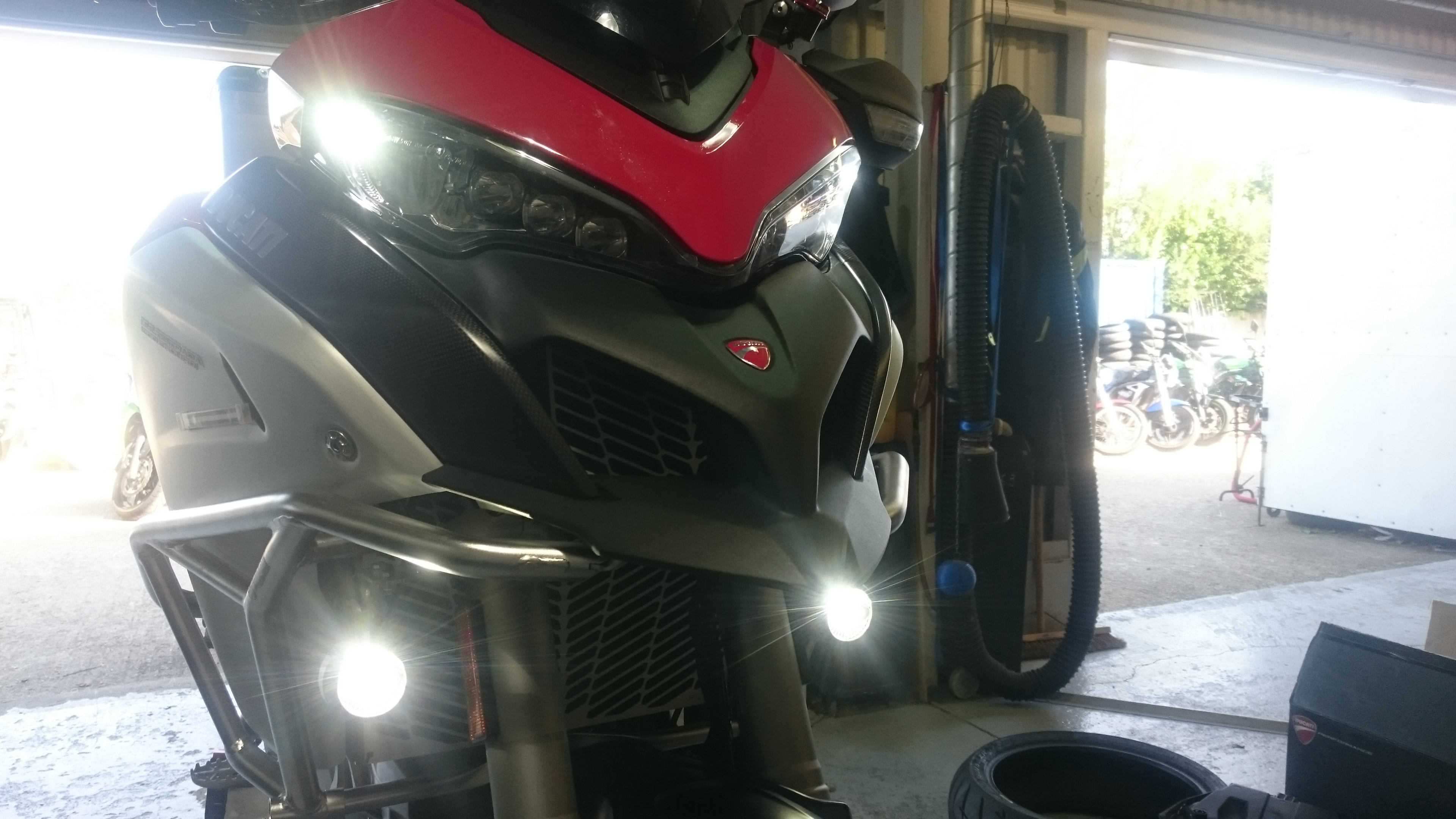

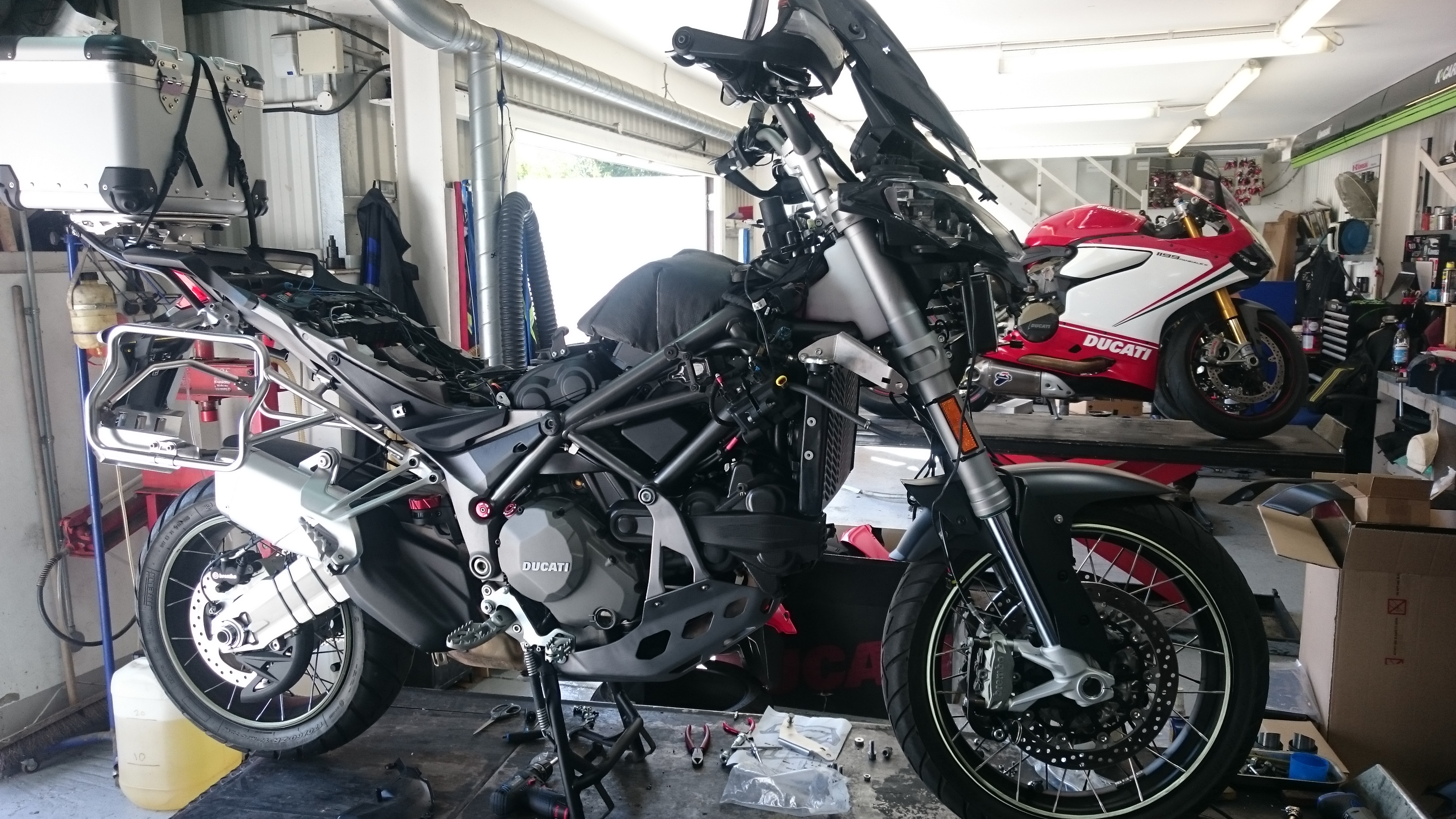

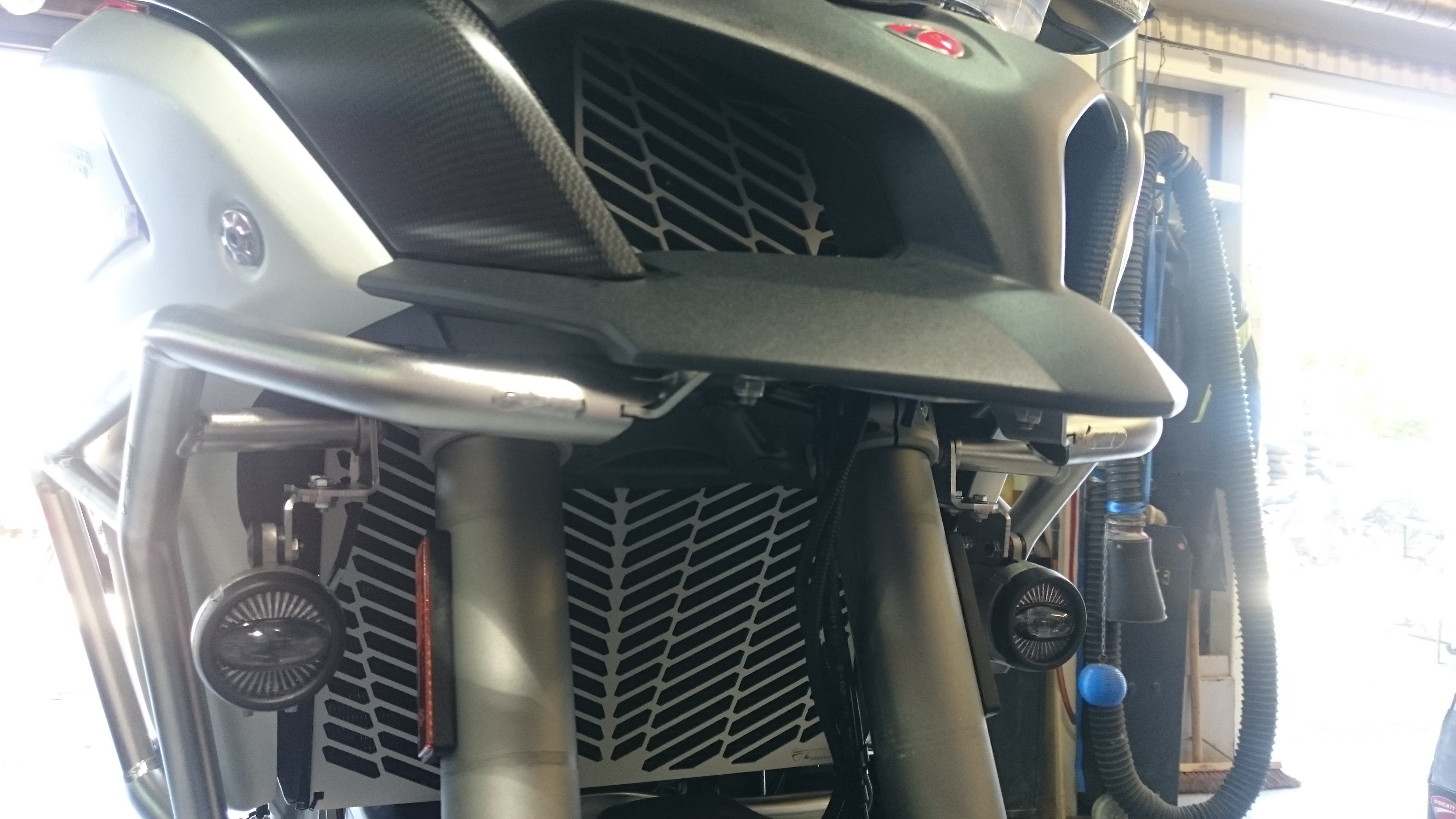

  4. Shite, I am wrong the touring pack is the rear panniers. The enduro pack is definately all front fairing off & even dash dismantled. As it has the two radiator guards & then light kits with crash-bars also. My agreement with the dealer was everything I bought was installed free of charge. I'd suggest persuing that route as that pack is a bitch. Let me see if I can show you an image or two'
  5. 1200Enduro image; bare bones
    Enduro pack guards & crash-bars
    Fog-lights added & working
    Side view of package installed

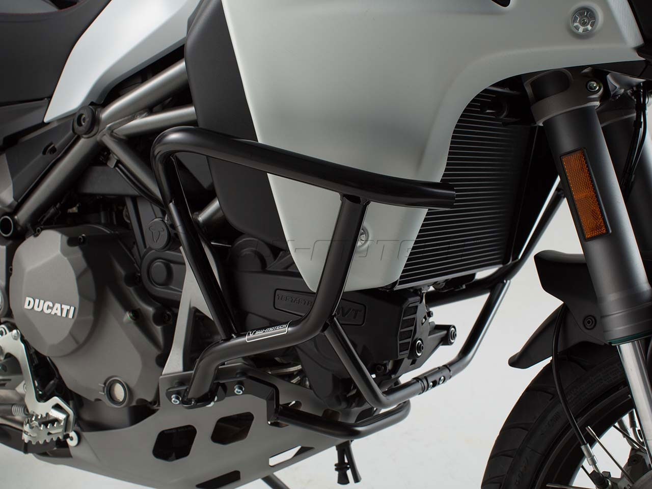

  9. SW Motech have just issued their own take on the crash bars system for Multistrada Enduro:
    Reliable crash bar for Ducati Multistrada Enduro, protection for your motorbike.
    I can't say that I'm enamoured by their looks (imho) but they are considerably cheaper alternative to the TourTech ones. Not sure if they are made from the same high quality steel either. That said, for £195 (approx) or €229,95 they are tempting and look easier to fit that the Touratech ones. Any thoughts??
  10. Recently bought the SW MOTECH ....Yes they are easy to fit. Powder coated mild steel...so likely to rust if scratched.
