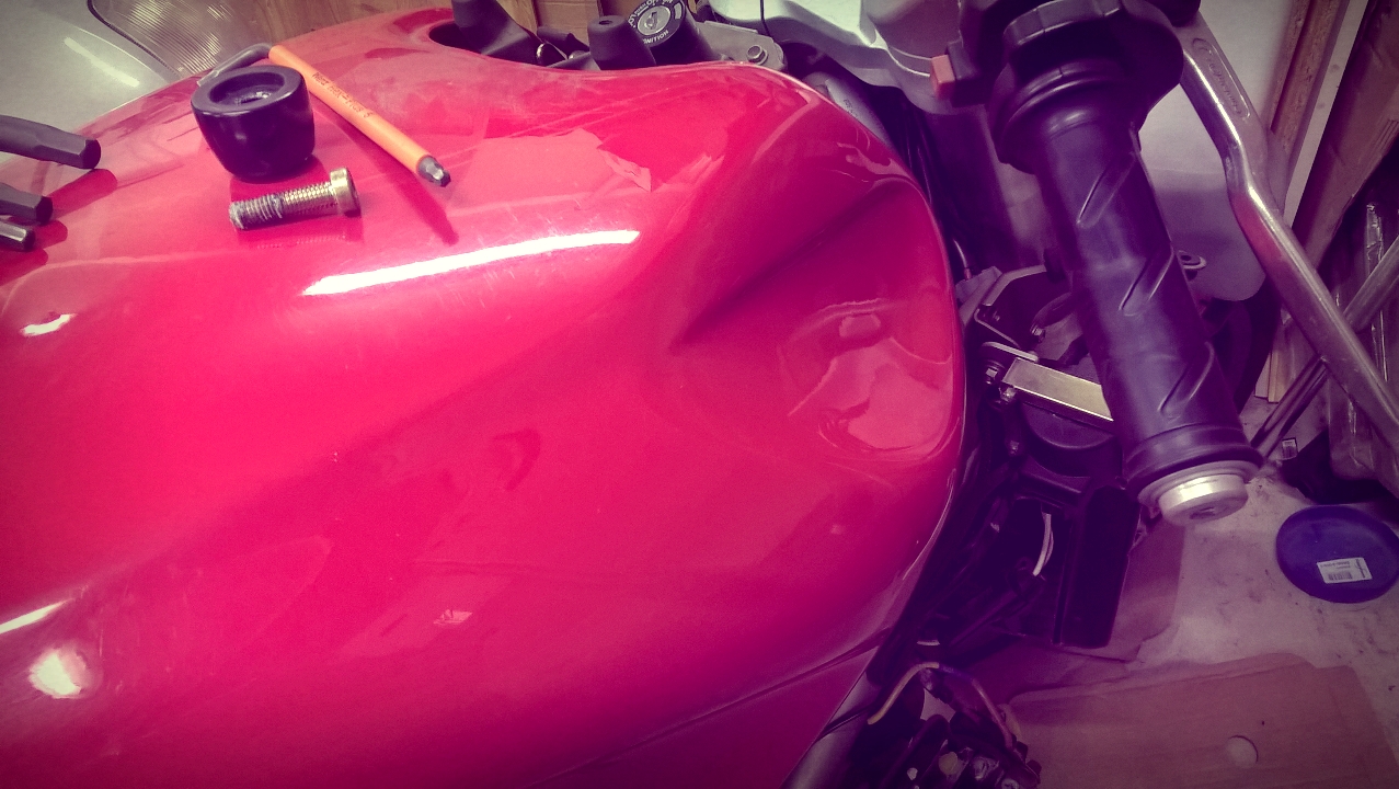

    Installing was really simple, you just need to take care everything is installed the correct way round. First, take of bar end weight:

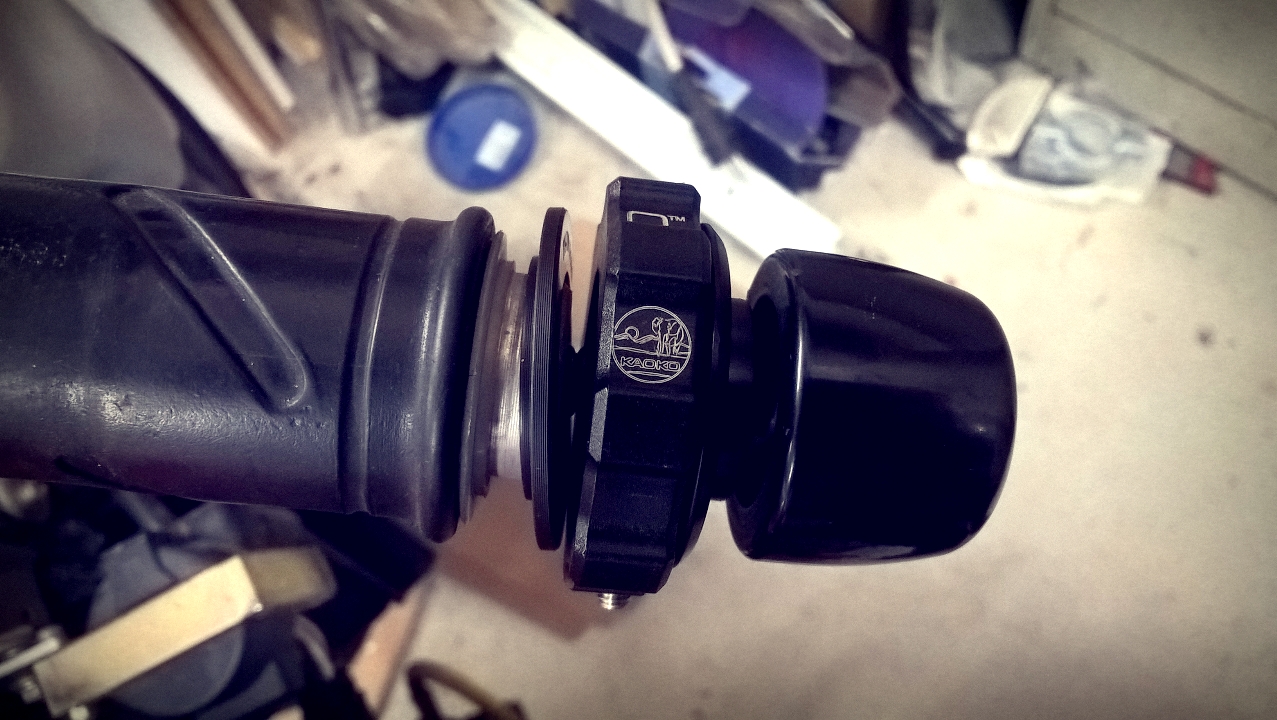

    Then put the washer on the bar end, and put the bolt through the bar end weight and the Kaoko ring. I put some medium thread lock also to the bolt.
    Everything in place before tightening. You can notice that on the washer, there is a small spigot, and that is the part which presses against the actual throttle actuator, and not the throttle rubber grip.

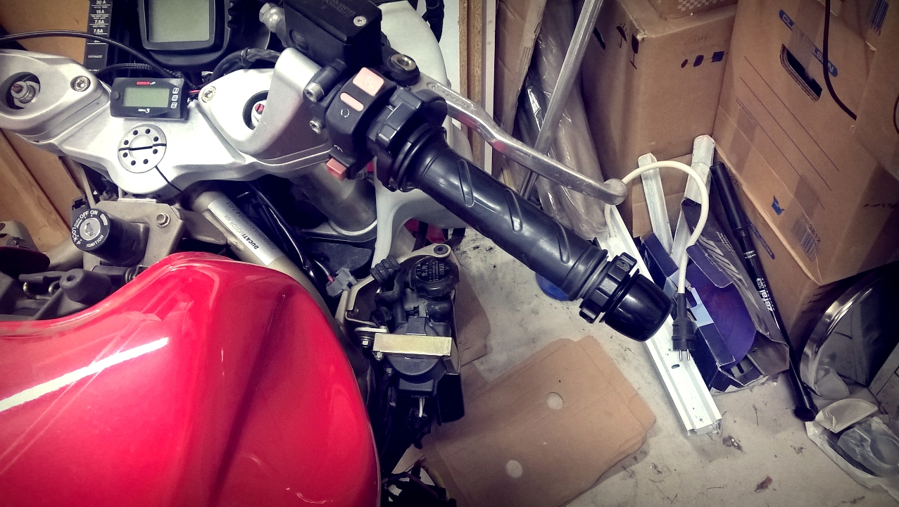

    And now everything tightened. It seems to work well and as supposed, but I can confirm the usage on the road once the snow melts in about 3 months :grin:
