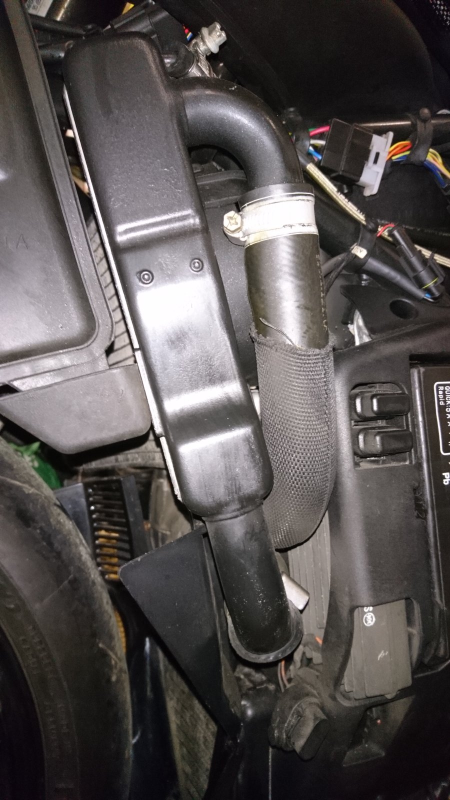

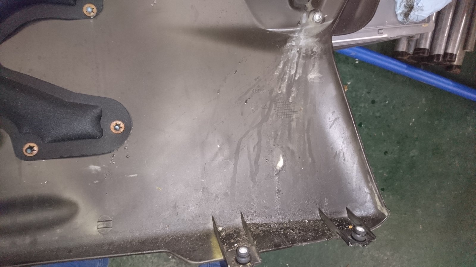

  10. DSC_1410.JPG DSC_1411.JPG Took fairings off tonight. Checked the coolant level and it is fine and it's that green sticky stuff. Deffo not that underneath. I reckon it is a bit of condensation. Tiny bit of coolant leaving rad at big hose.. See fairing mark but it's not dripping underneath. I'll clean it all and check it again after a few runs. Not too worried about it.
  11. If its any help thats exactly where mine had a small leak - at the bottom hose on the rad it was sort of oval rather than round - Glenn at moto-V sorted it when i got it serviced.
