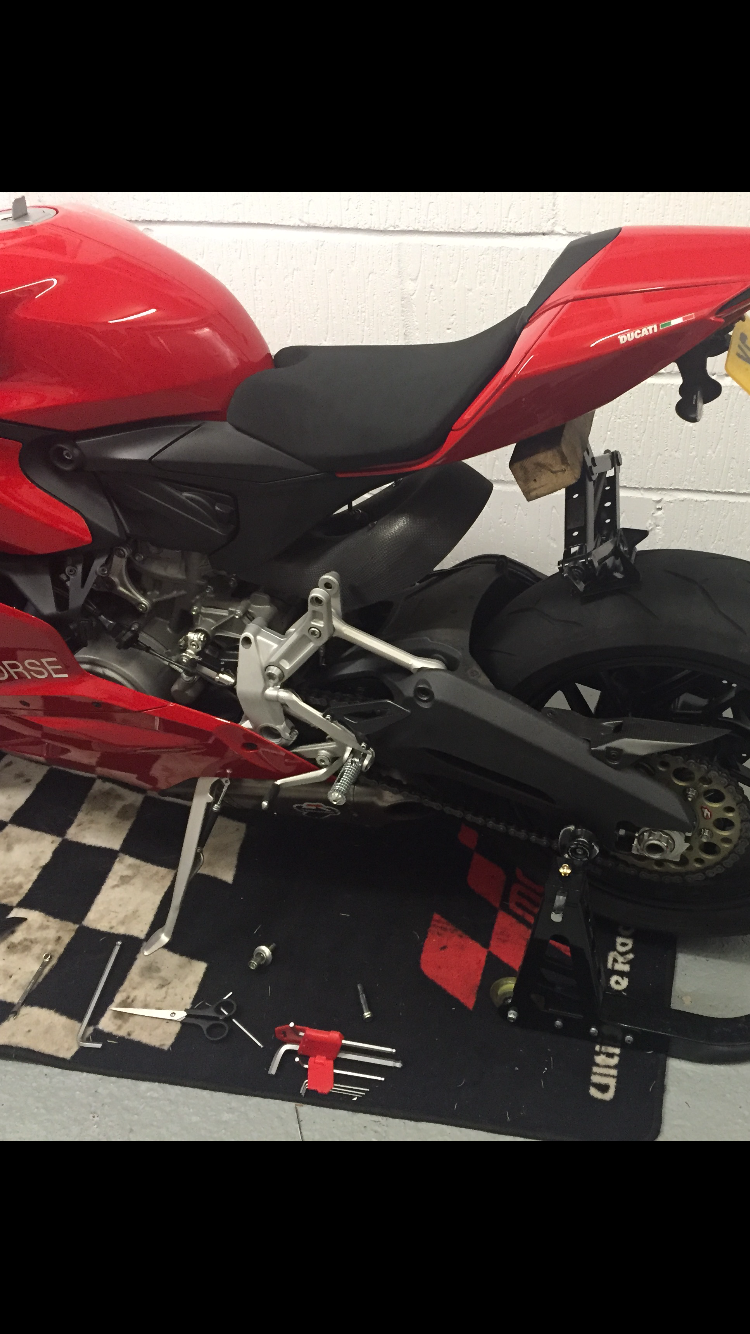

  1. Hi chaps, just gone to fit my carbon exhaust guard, which on the 1199 is a 30 minute job, the subframe lifts easily giving you plenty of access to everything. On the 899 however the subframe appears to be fouling on the engine when I try and lift it. I've undone the bottom subframe bolts entirely and loosened the top ones. Do I need to fully remove the top bolts and lift out the subframe completely or does it pivot upwards and I'm just doing something wrong?
  2. I ended up taking all 4 bolts out, removed the carbon rear hugger and lifted the tank.
  3. [​IMG]
    Same here :grinning:

  16. Many thanks. I hadn't realised that that was it installed in Matt's photo.
    Did the jack / block give you enough clearance or did you have to do what Matt's done in his photos? Cheers.
  17. The photo with the jack is to support the bike while I have the shock removed. To fit the heatsheild I just removed the 4 subframe bolts and lifted the subframe up out the way.
  18. Ah, I see. I hadn't noticed it was off! Thanks.
