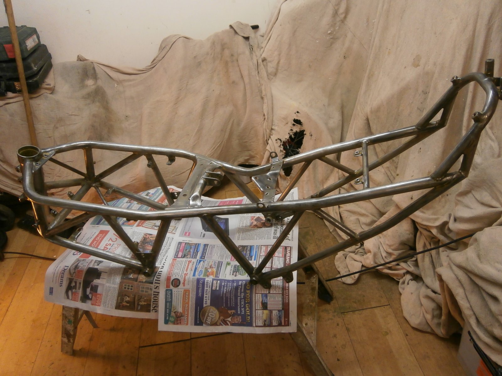

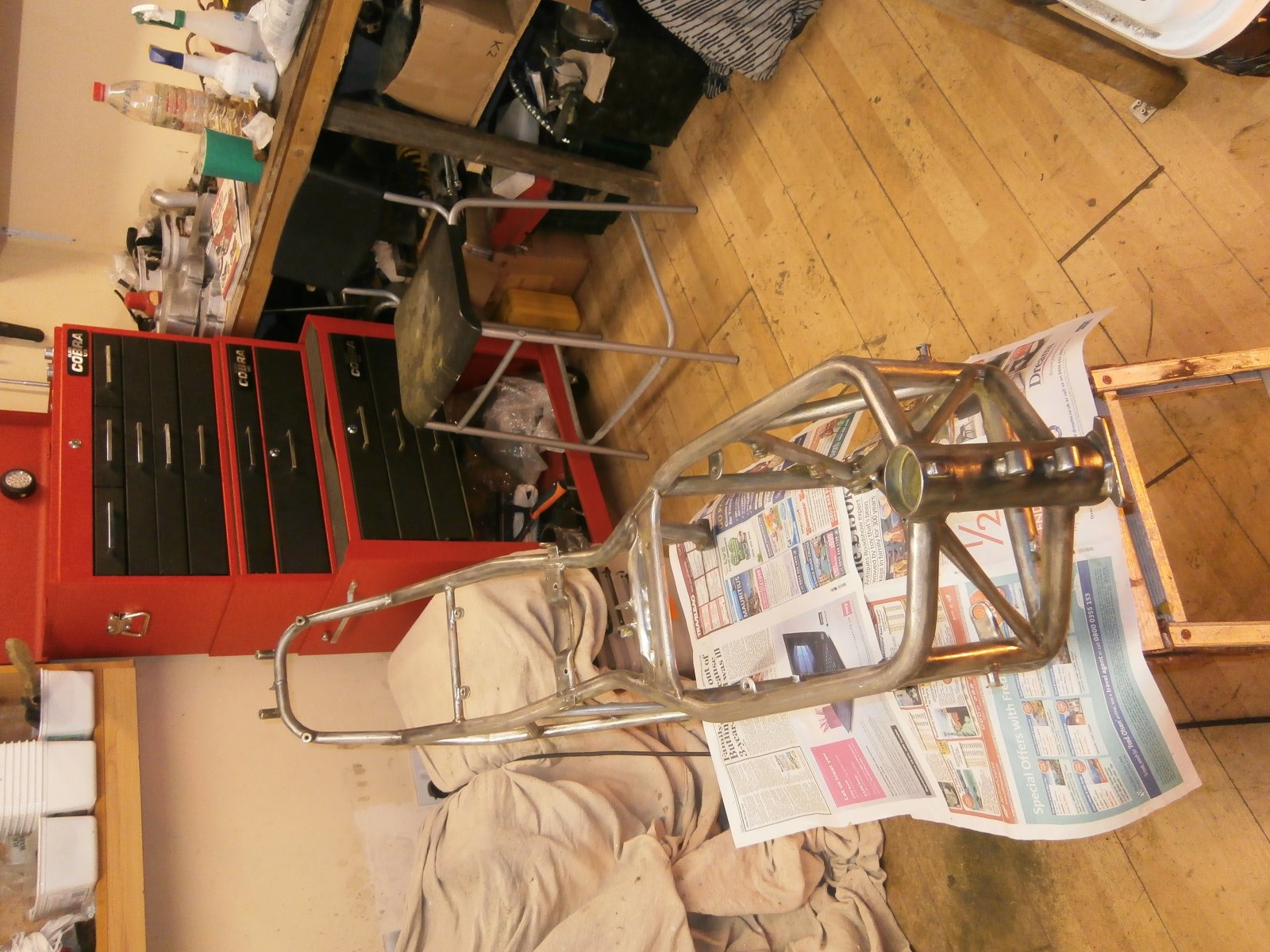

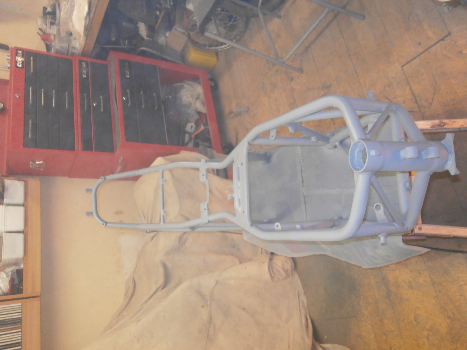

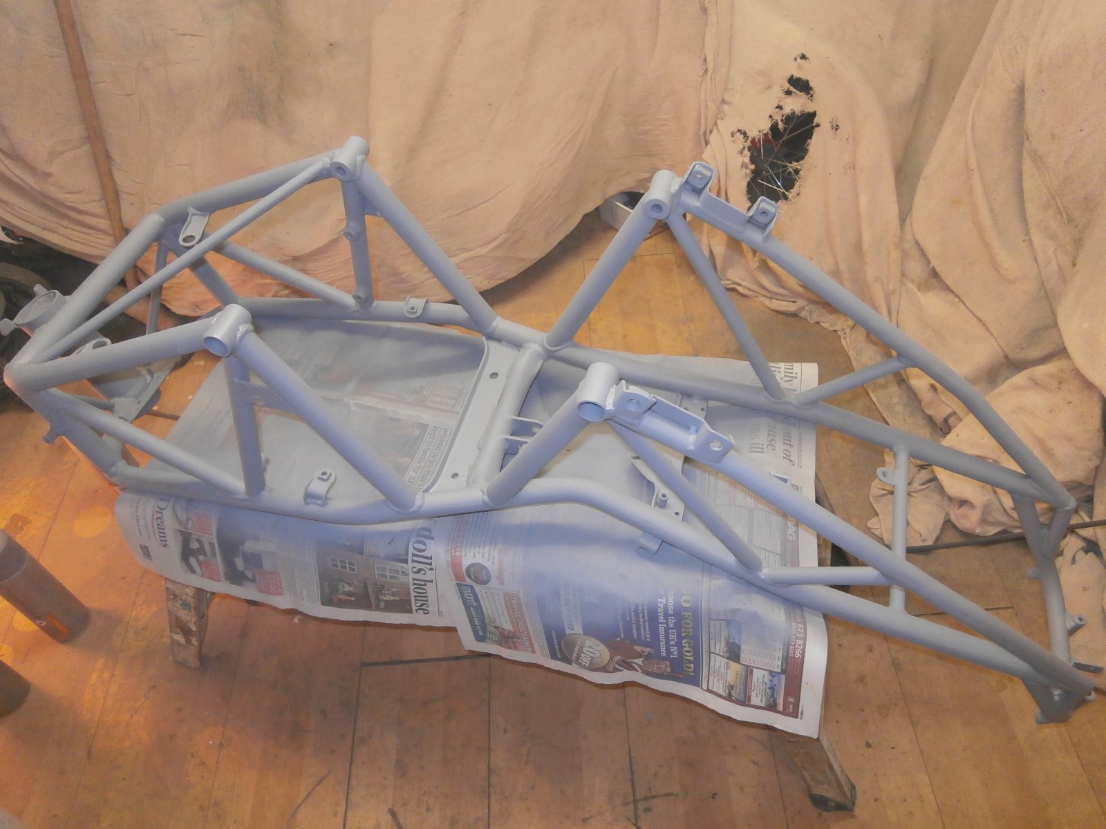

  6. P4170003.JPG P4170004.JPG P4170001.JPG P4170002.JPG Frame finally stripped, what a pain. used different types of paint stripper,s black paint just fell off, yellow plastic coating just turned to liquid and went hard came off with sanding disc. Then a mate told me a body workshop trick, paint the stripper on cover with paper and leave for an hour, when i came back the plastic coating was soft and just peeled off with scraper, rubbed down by hand, Put a couple of coats of primer on to protect the frame, going to give it to a mate to paint.

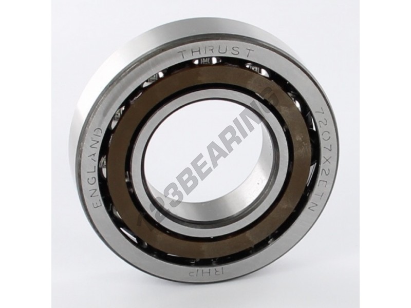

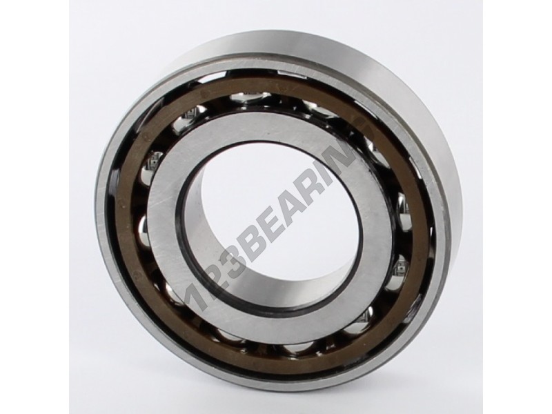

  13. As you can see it's easy to work out which way around they go.
    Put them in so the more open face is towards the inside of the cases, that way the balls are being pushed against the correct(Wider) running surface.
    Nasher
    B-10-7207X2ETN-RHP-EN.jpg A-10-7207X2ETN-RHP-EN.jpg As you
