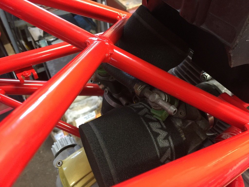

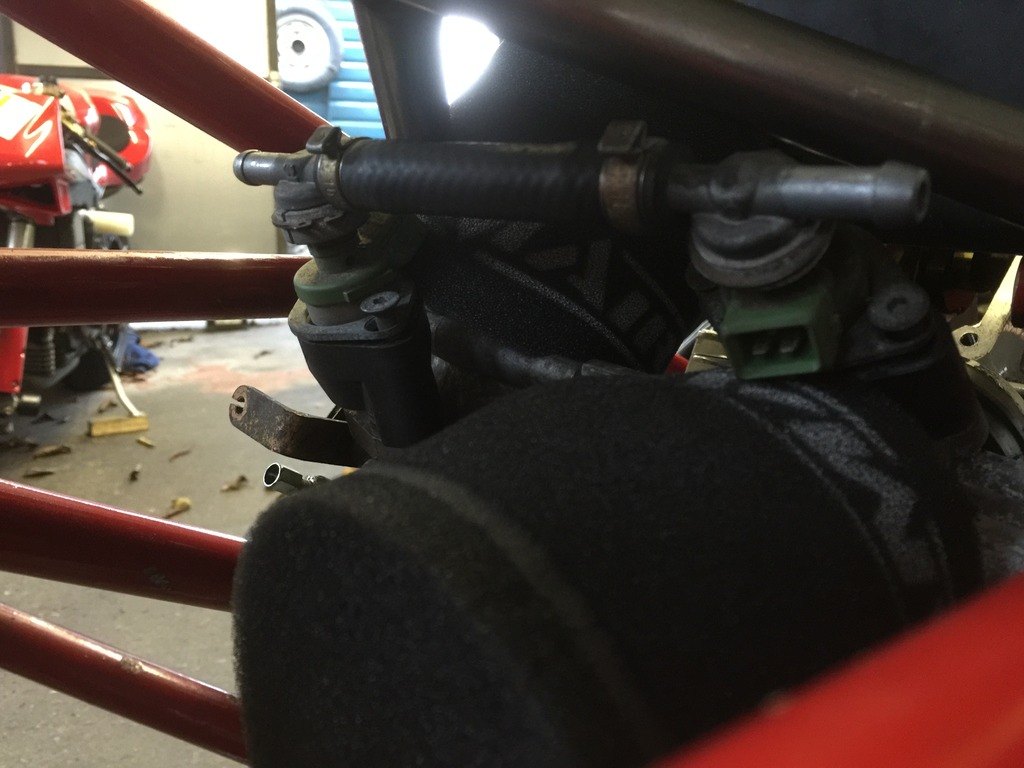

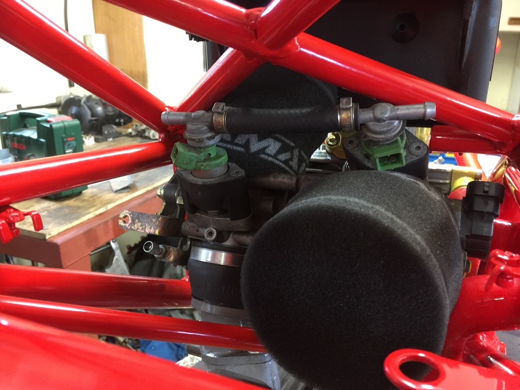

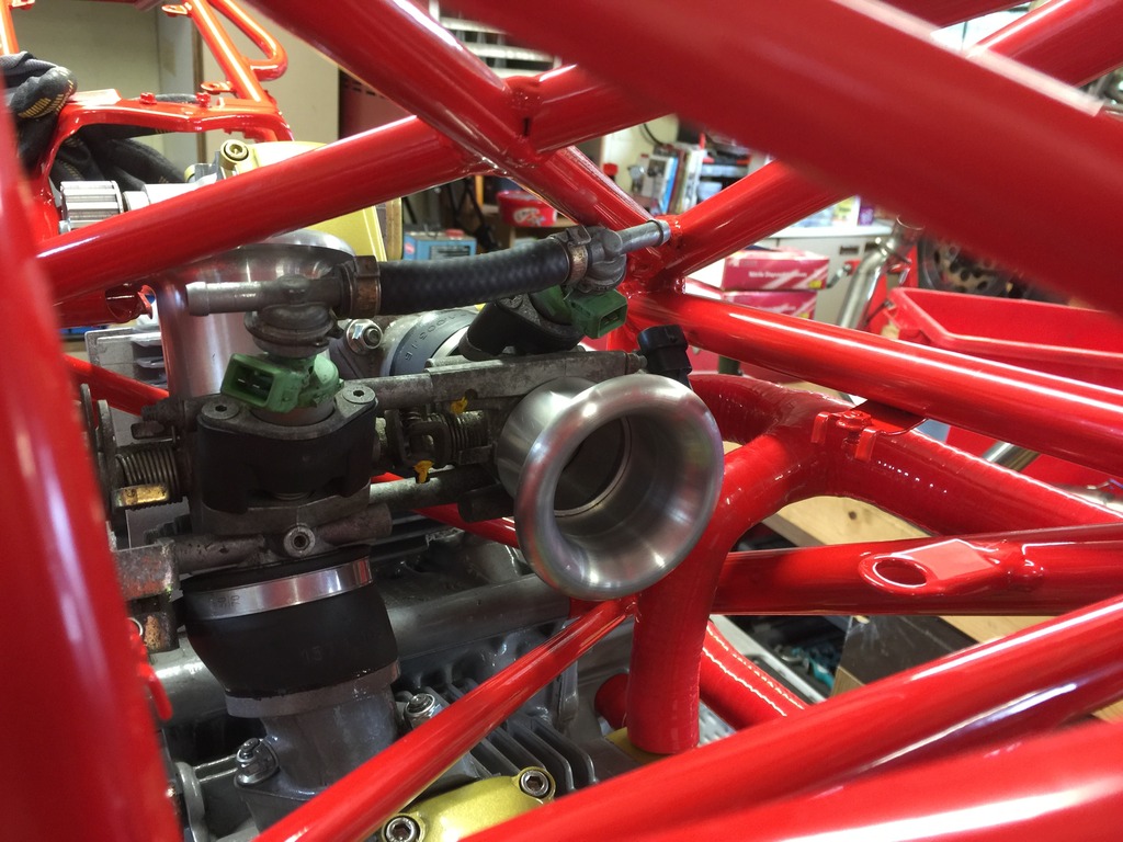

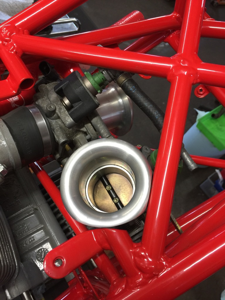

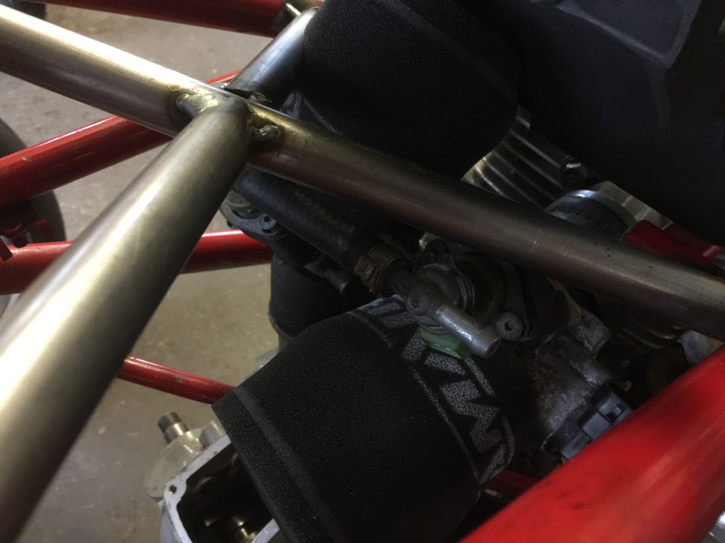

  1. Hopefully this weekend it will be stripped down for powder coating. Last weekend I did the last bit of fitting adjustment with the air-filters and battery box.

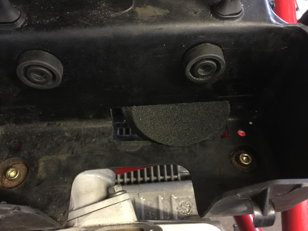

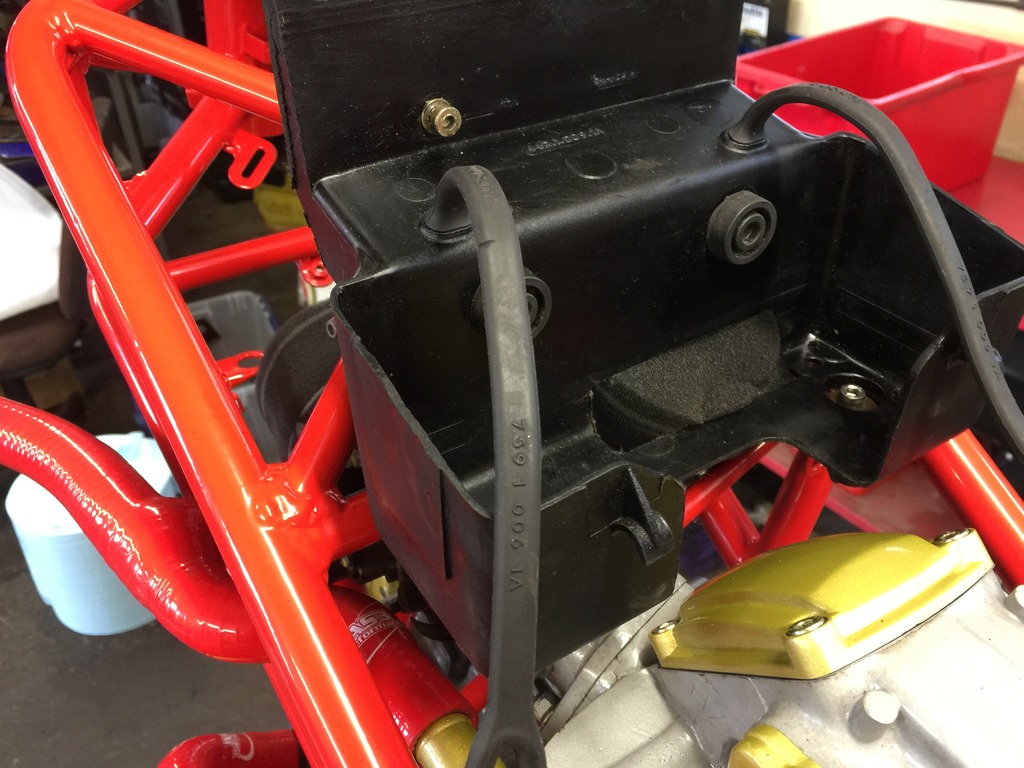

    Bought directly from RAMAIR the filters were only just over £12 including postage, unfortunately they cover the alloy intakes:
    With the intakes and filters fitted the battery box did not fit properly so a little adjustment with a big saw and it all fits together:
    With the battery box rubber fitted there is no interference with the filter or intake.
    Yorkie

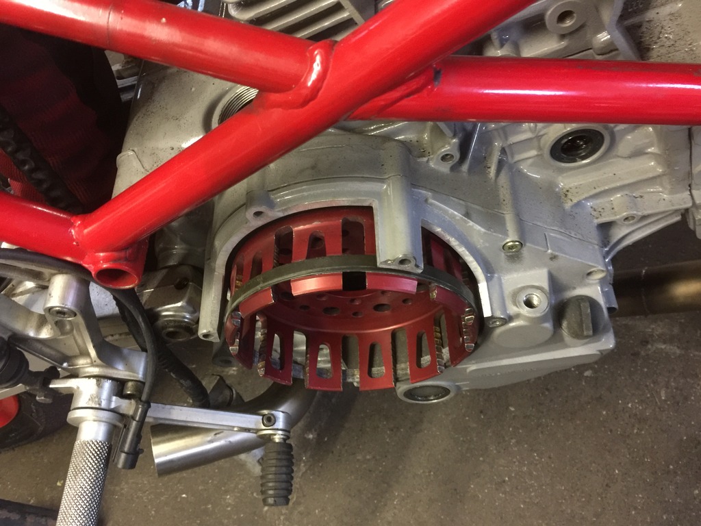

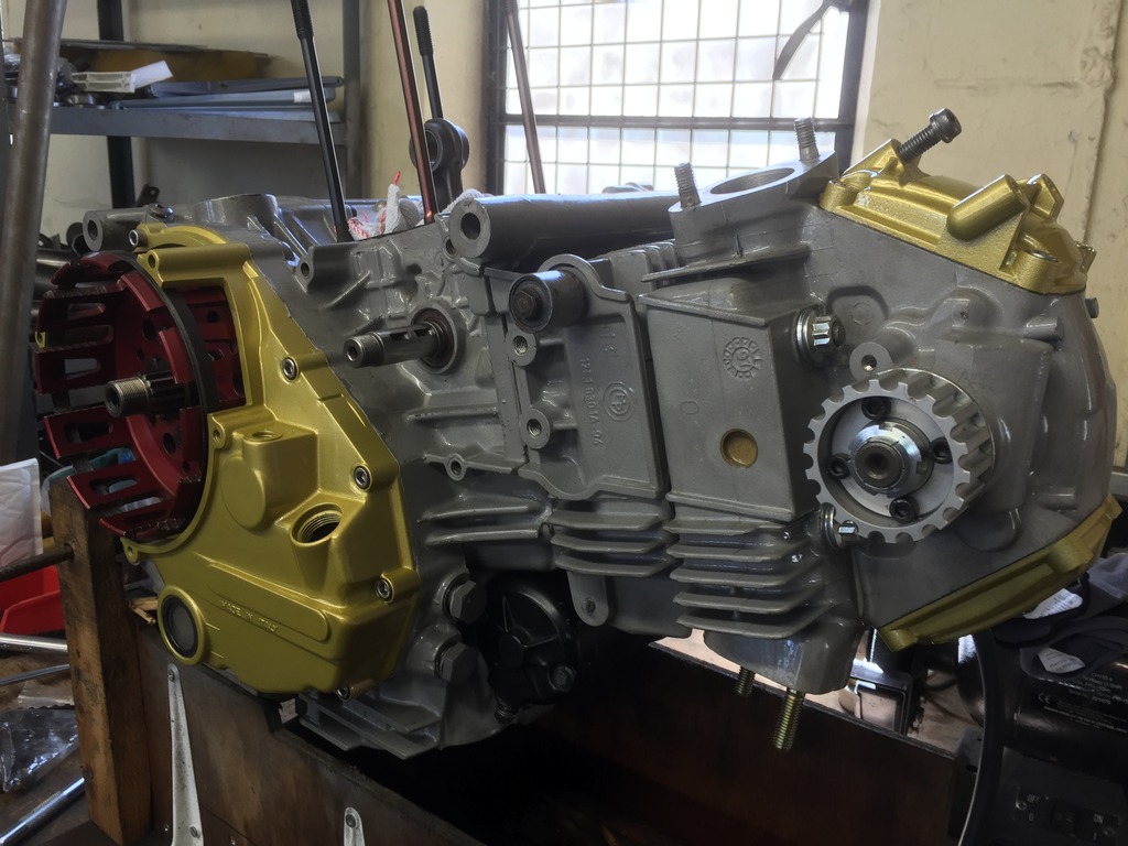

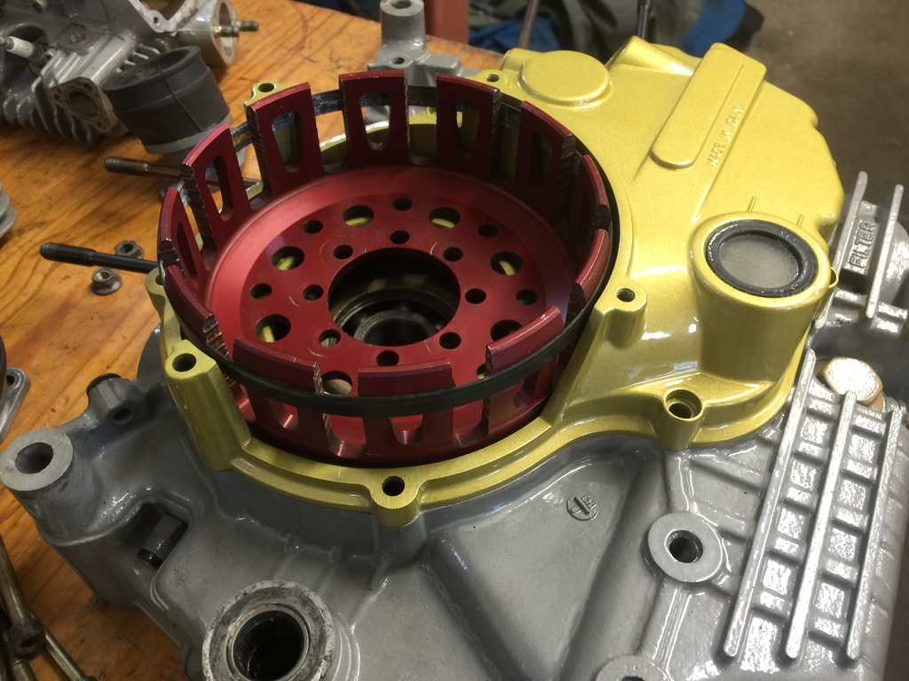

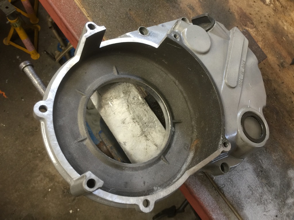

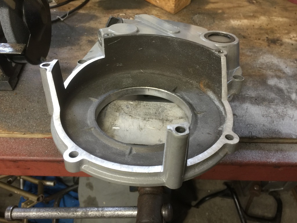

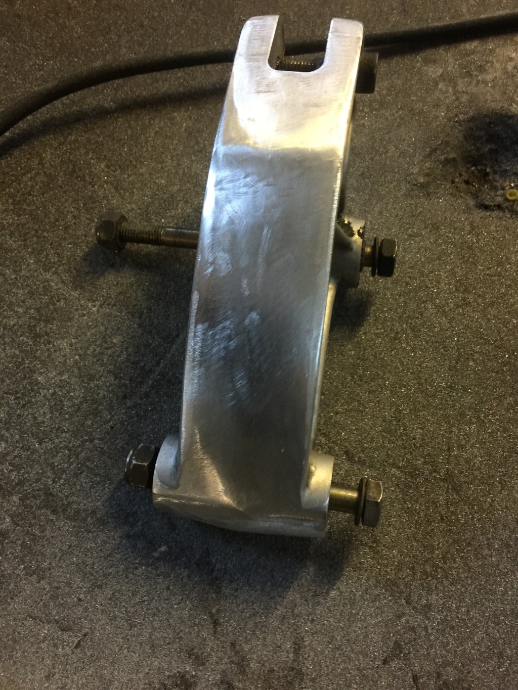

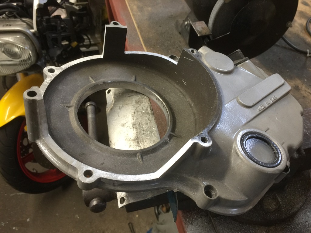

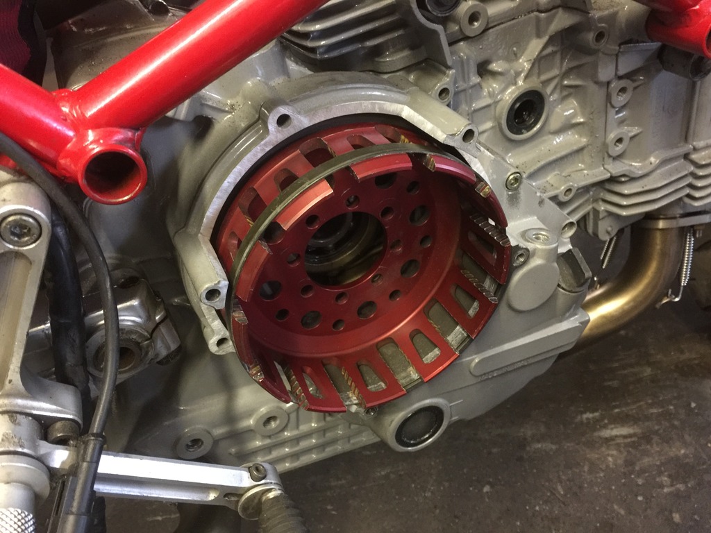

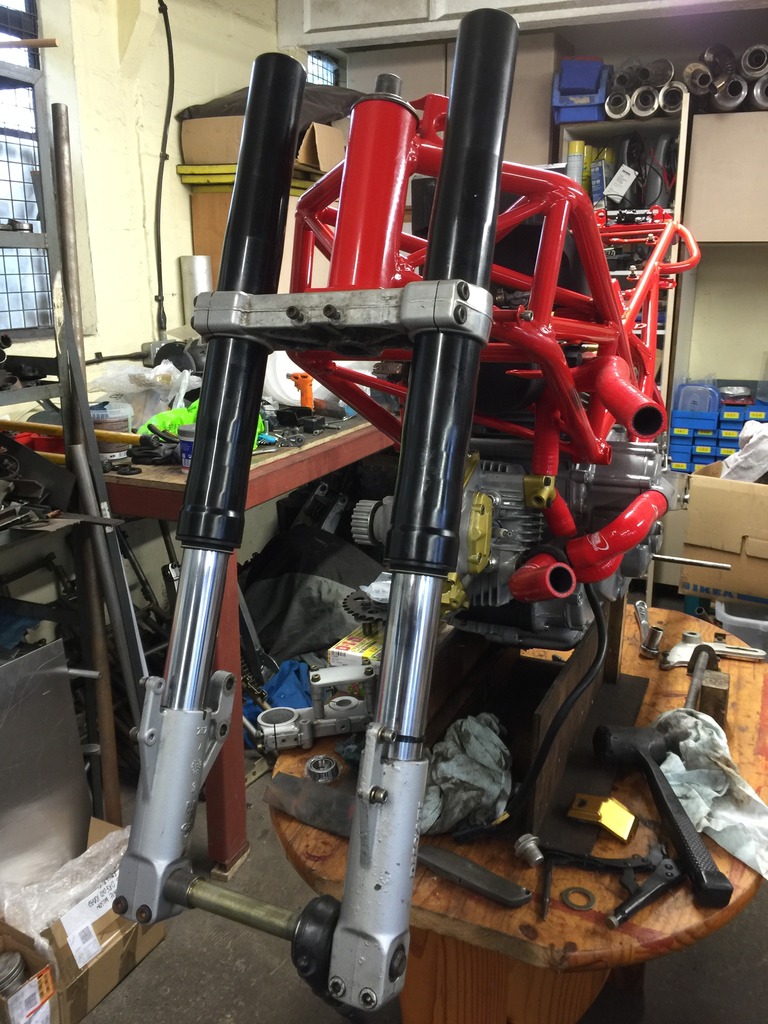

  2. Played about with the clutch case and trimmed a little more weight off it with a hand saw and then finished it off with a few files:
    Yorkie

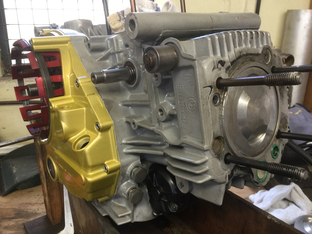

  3. Mounted the clutch case and it looks good with the alloy basket:
    Yorkie
  4. This was today's end result:
    All ready for paint.
    Yorkie

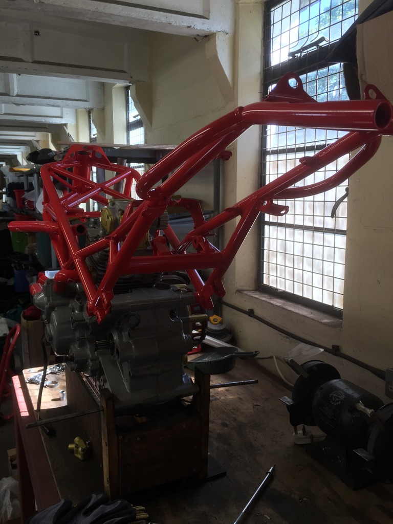

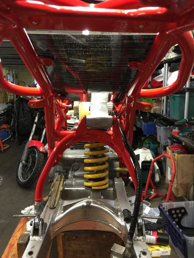

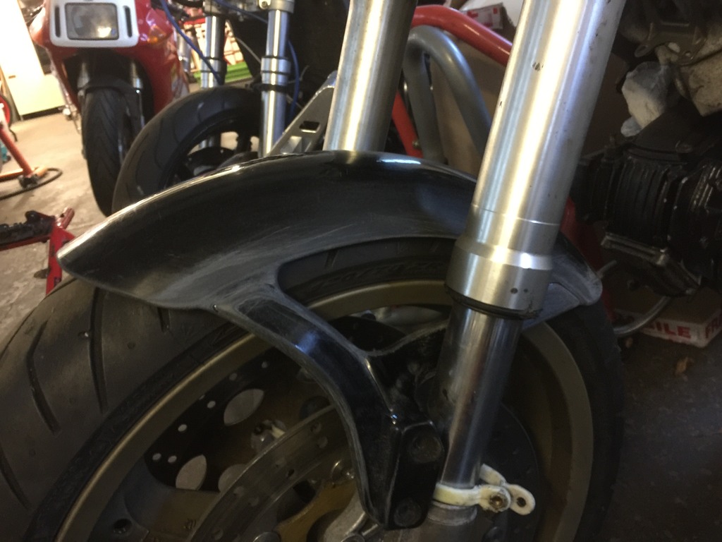

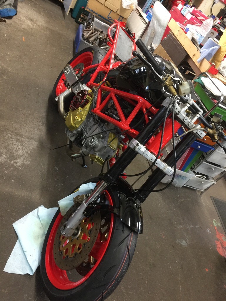

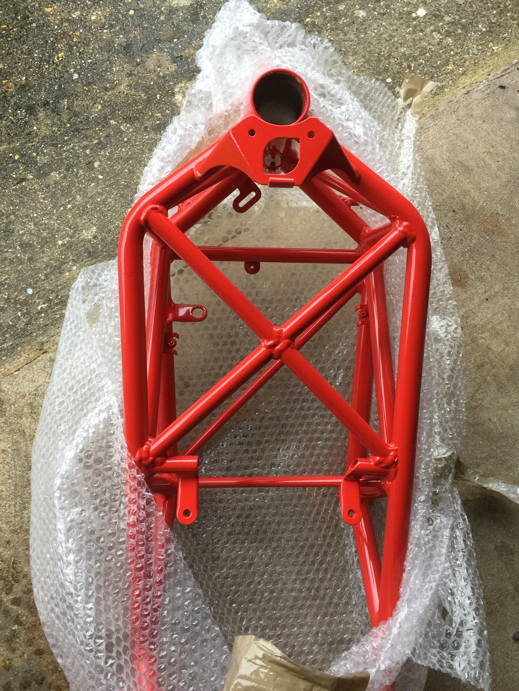

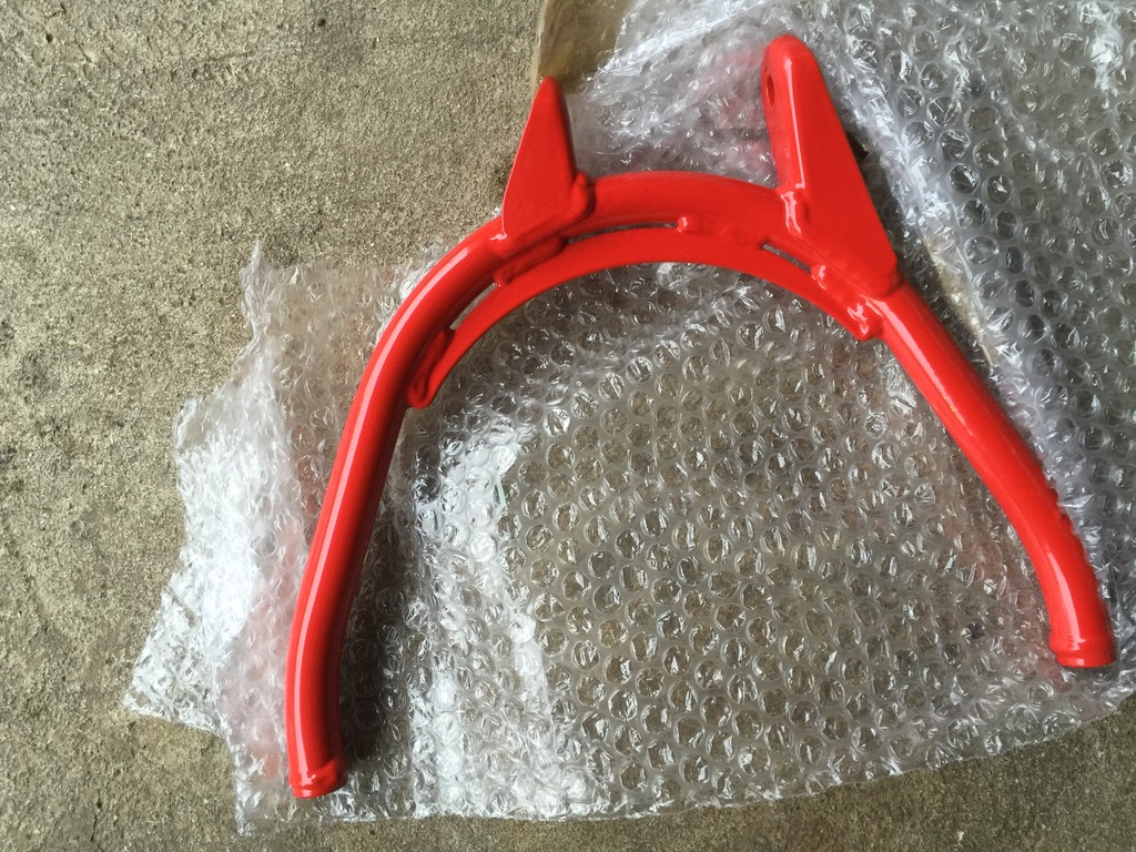

  5. Only did a little bit of work yesterday, trimmed and de-flashed the front mudguard and de-seamed and cleaned up the rear suspension rocker:
    Yorkie
  6. Collected the paint work yesterday from BSA Bodyrepairs in Porton.
    BSA Bodyrepairs Ltd
    And the cut down front mudguard:
    Yorkie

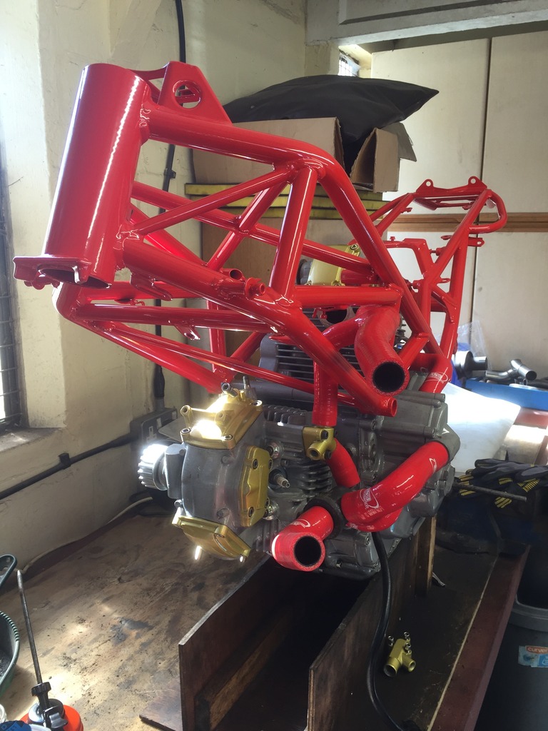

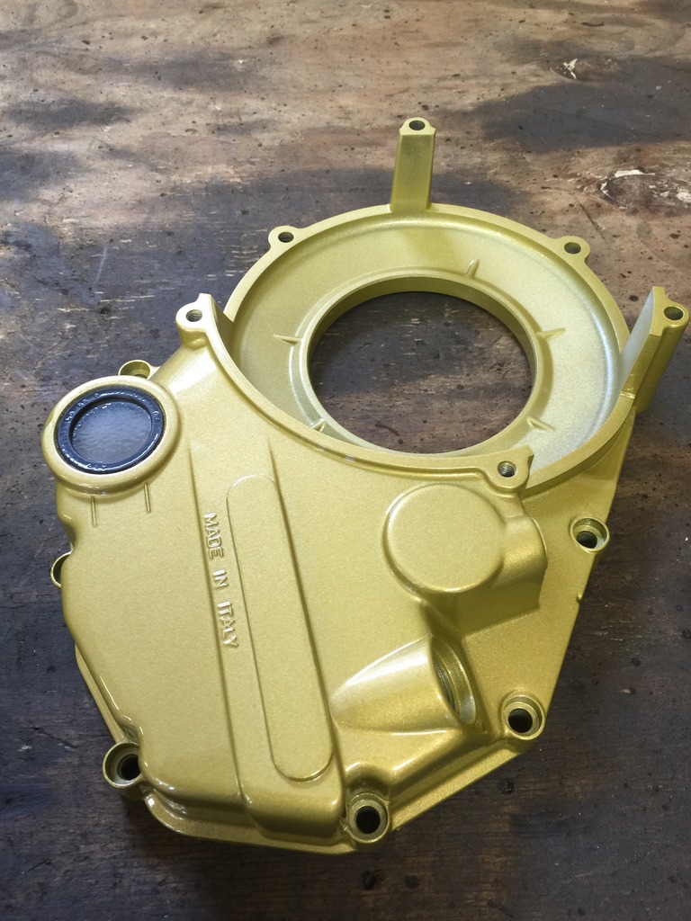

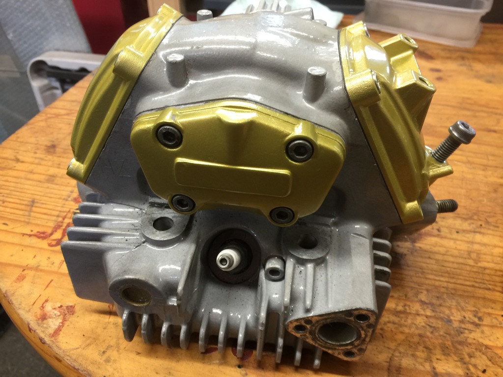

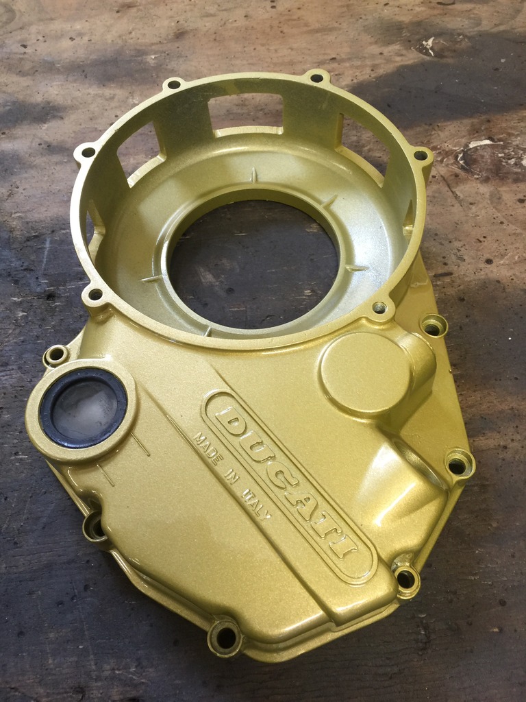

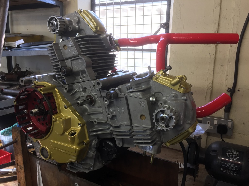

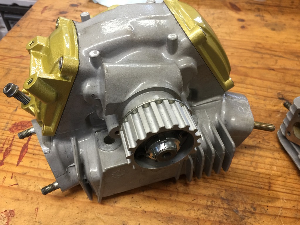

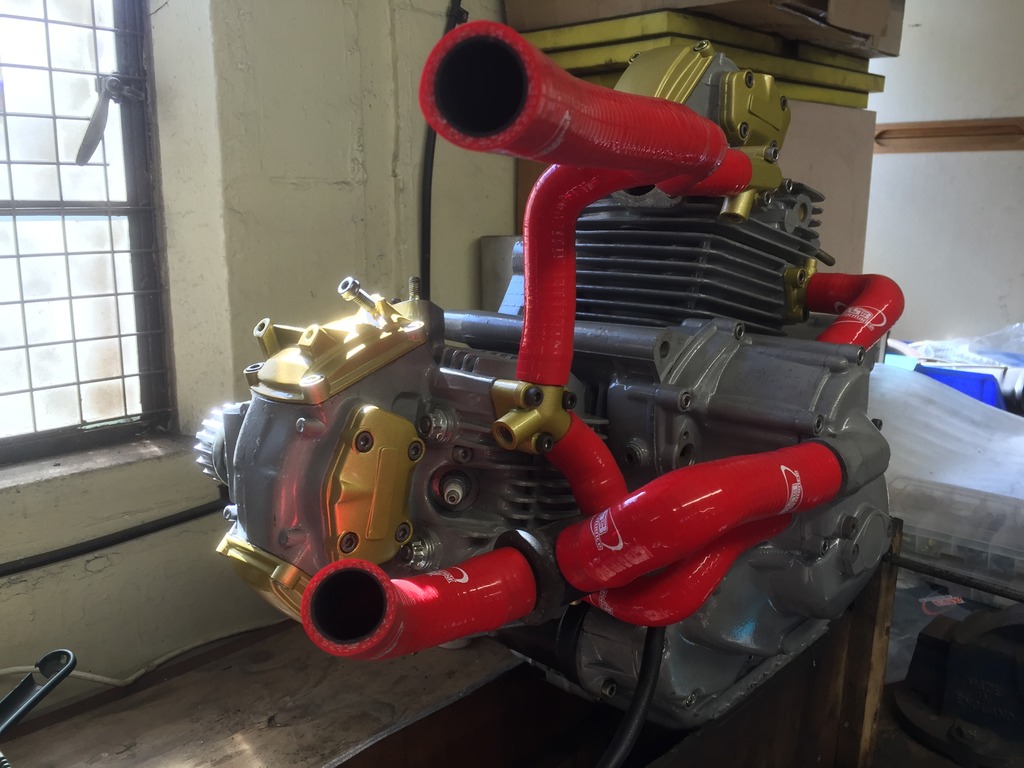

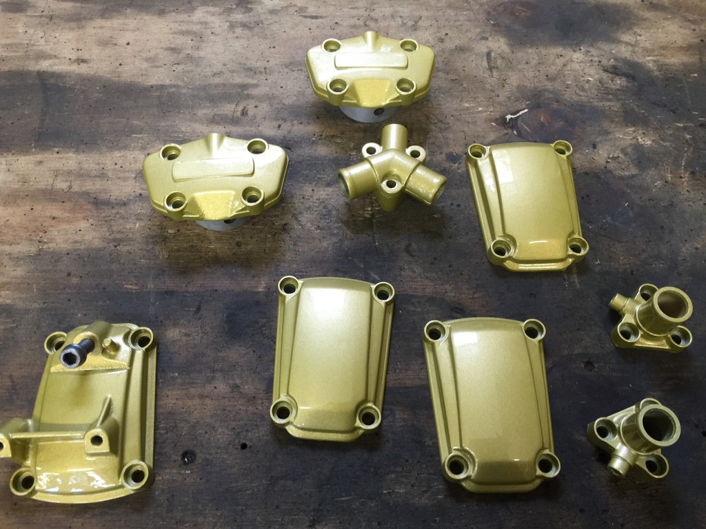

  7. I sent the clutch cases, valve covers and cam covers to get sprayed Gold. Got them back the other week and I think they look okay:
    My homemade Corse style clutch case:
    My extreme homemade cut away clutch case:
    Clutch case looks quite good on the grey engine and alloy basket:
    Yorkie

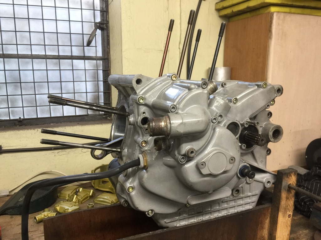

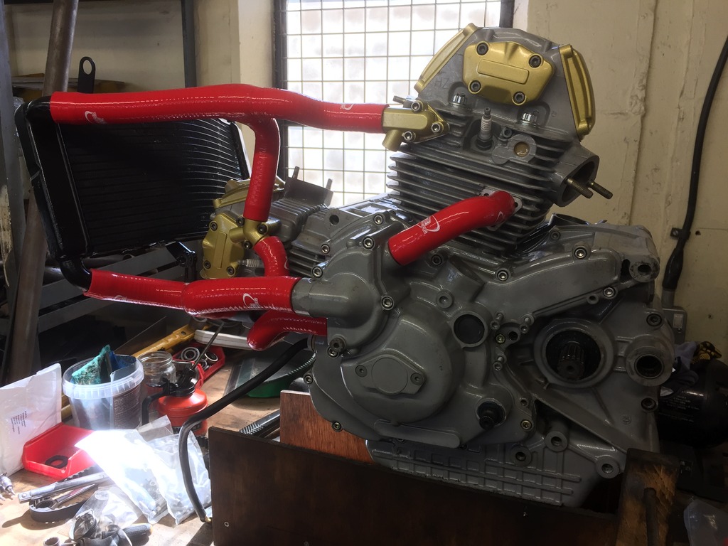

  8. The bottom end was assembled fully and all was going well until a piston ring snapped, stopping the rebuild in its tracks:
    So the heads were finished and shimmed:
    Alloy cam wheels fitted:
    Yorkie

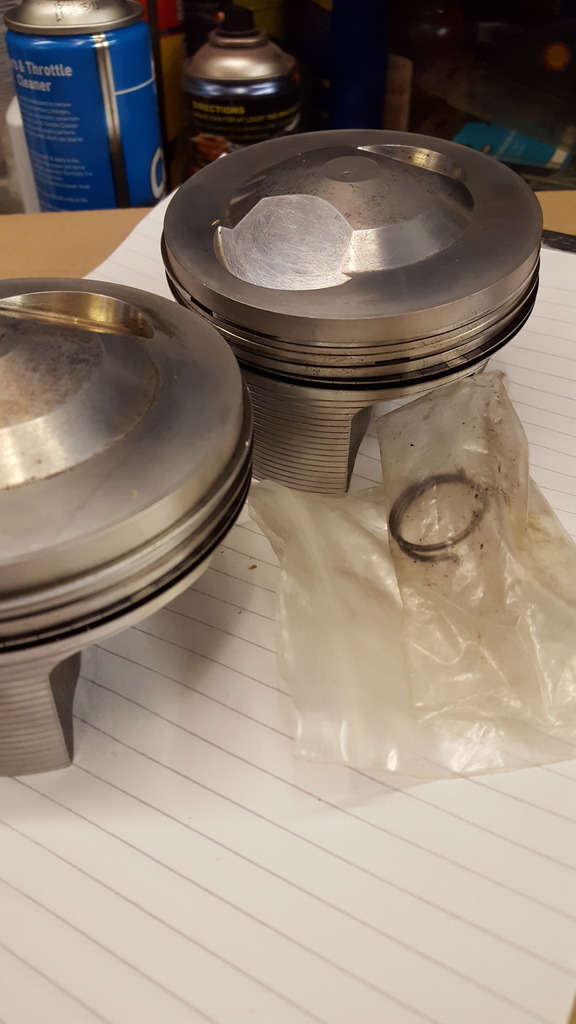

  9. I was lucky enough to get hold of a free set of ST2 pistons with some usable rings. I then picked up a set of Ducati Performance 94mm pistons:
    These will be great once cleaned up.

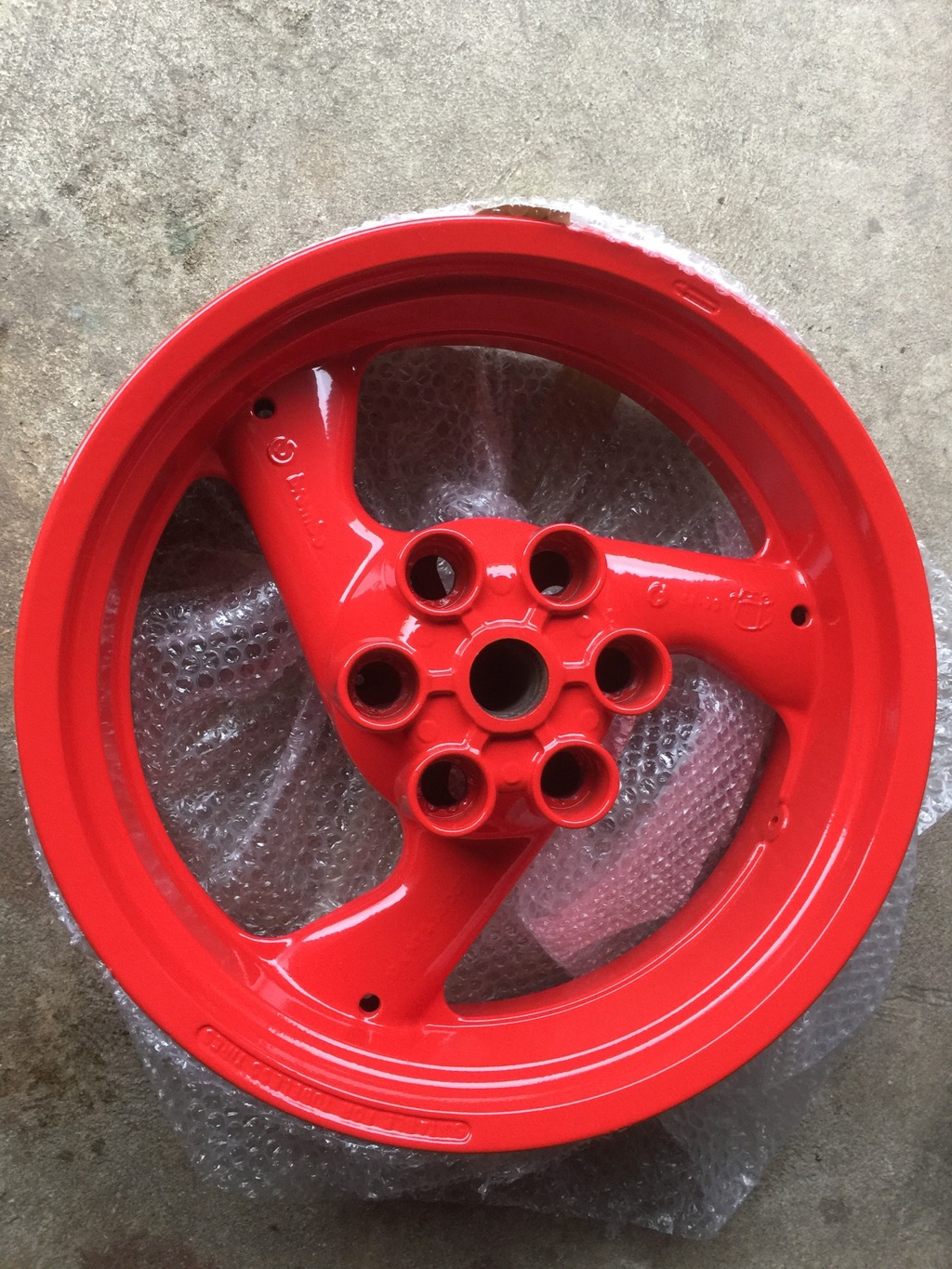

  10. New rubber arrived in time for the weekend and the continued build:
    For £134 for the pair they were worth a try and seem quite sticky as well.

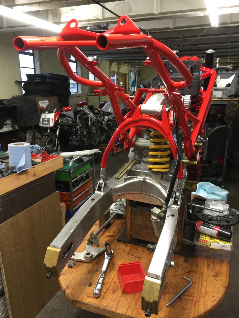

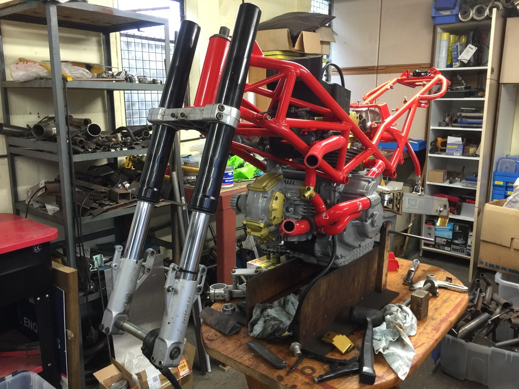

  12. Only did a bit of work on the project today. Injectors on, alloy intakes on (one modified), Ramair filters fitted and battery box on.
    Yorkie

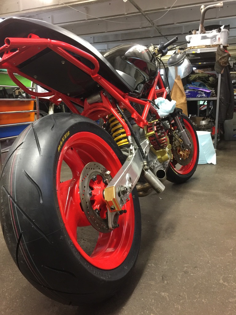

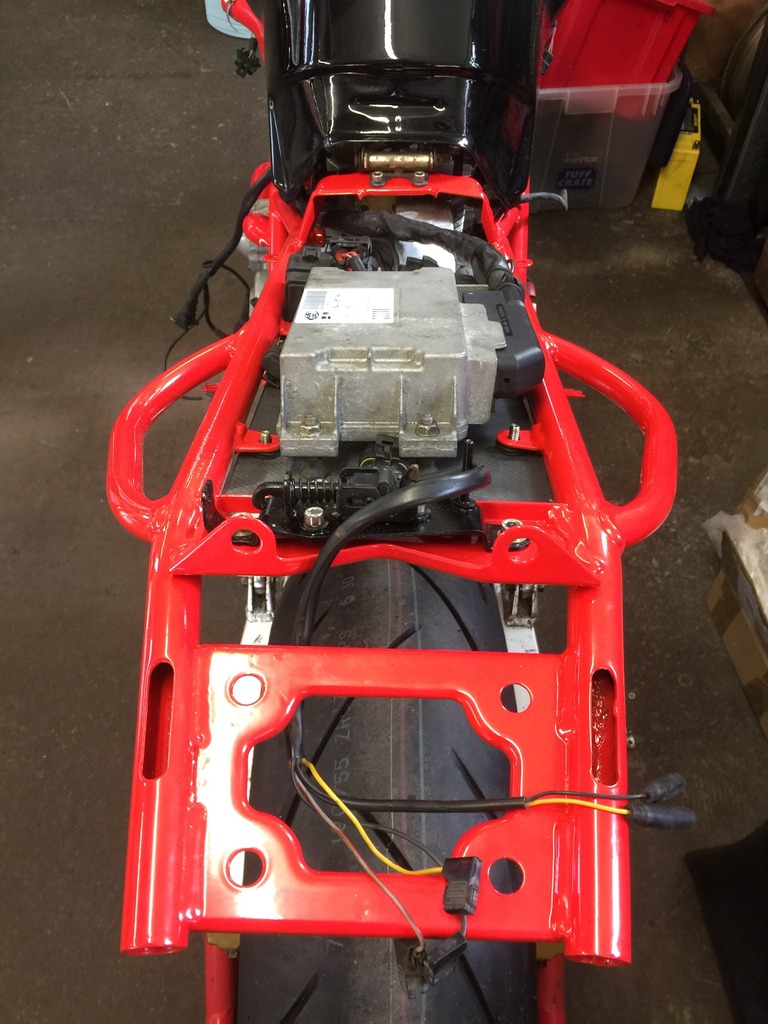

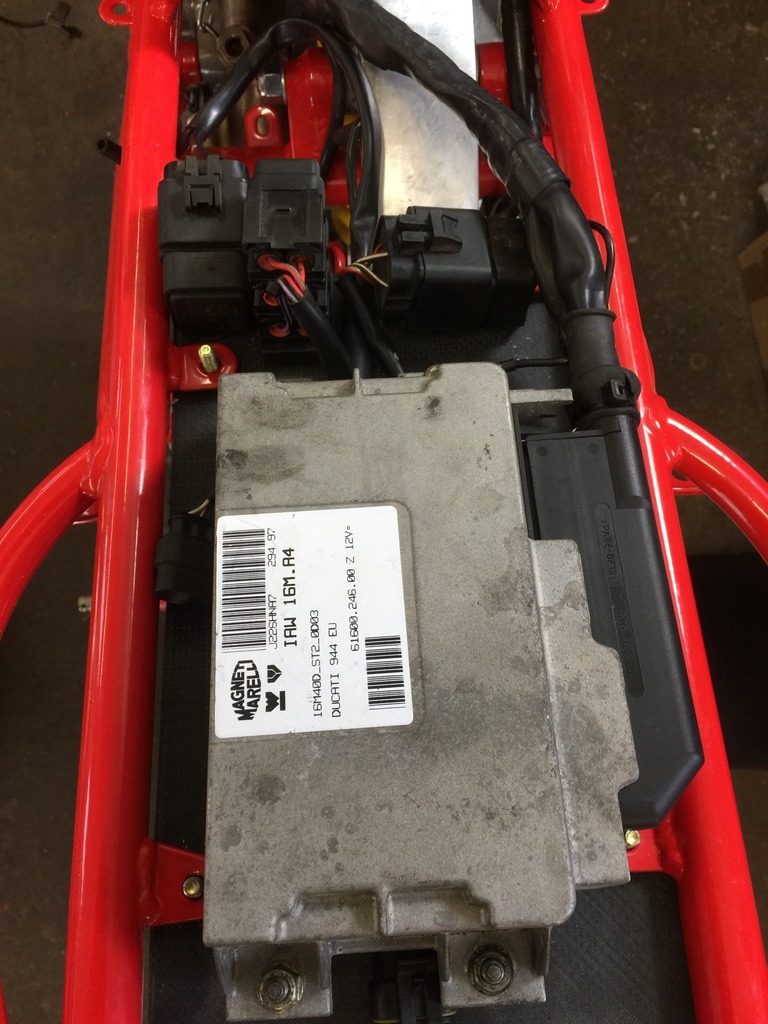

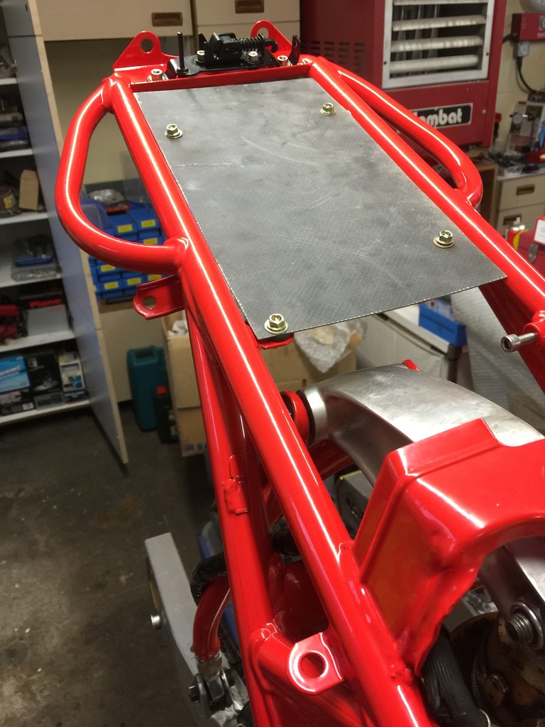

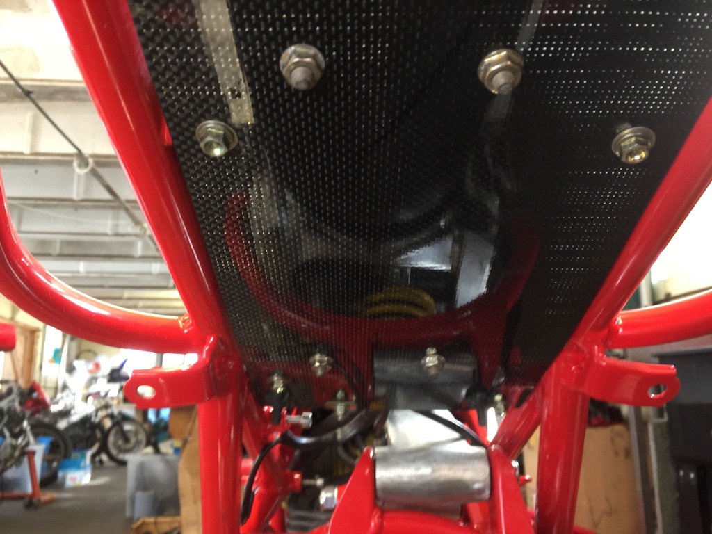

  13. A decent day today.
    Carbon ECU mount:
    Ended up like this:
    Next weekend, tyres on, wheels on and a rolling chassis.
    Yorkie

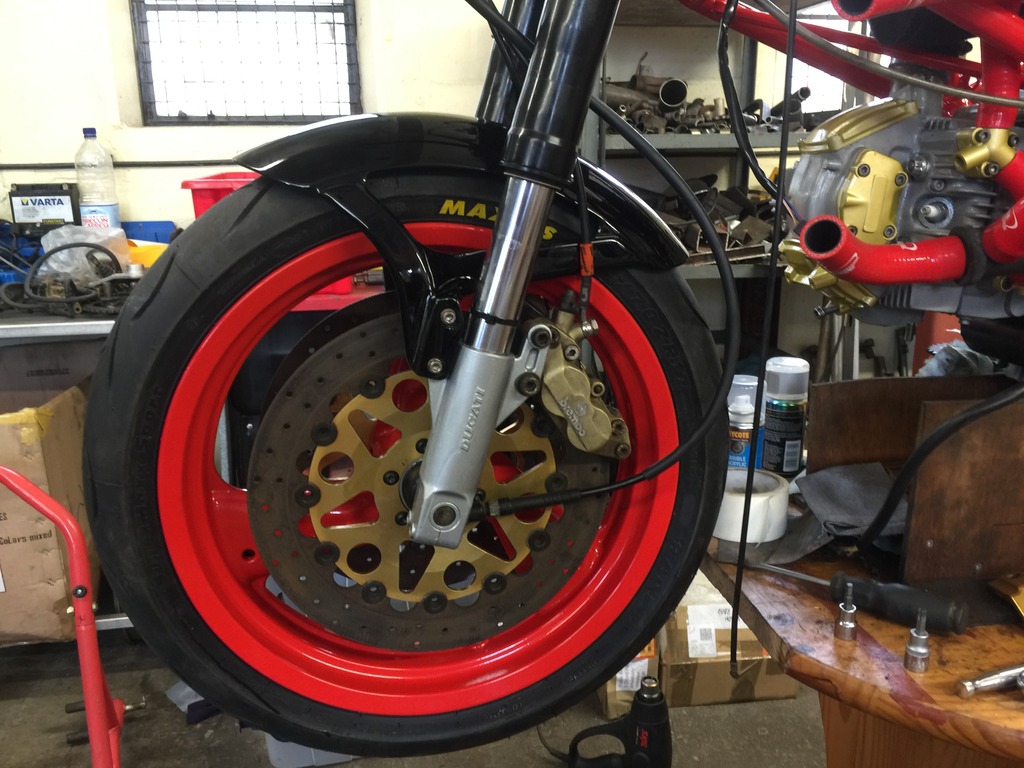

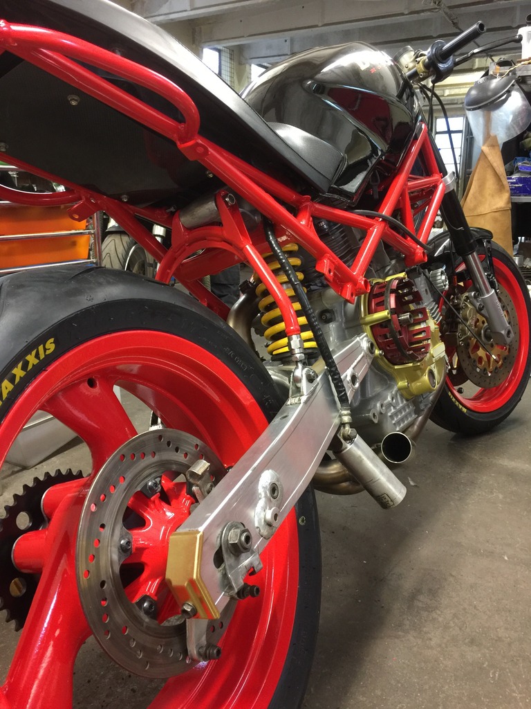

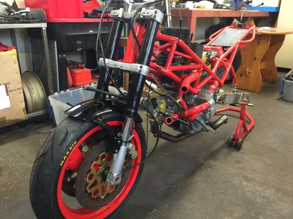

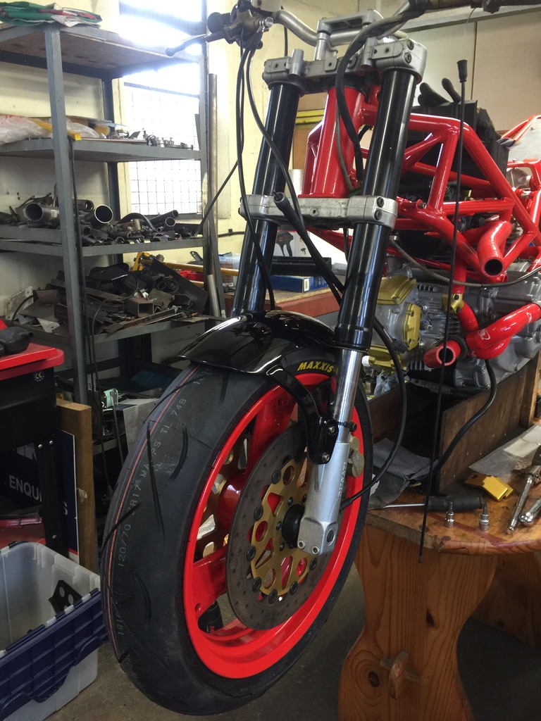

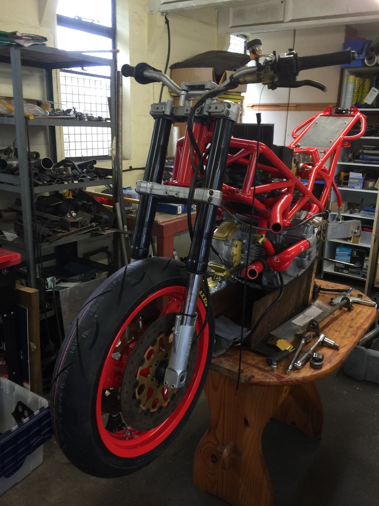

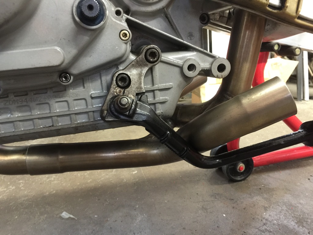

  14. Almost completed what I set out to do ......
    Brakes and cut-down mudguard fitted:
    I do like the mudguard de-seamed:
    So near and yet so far:

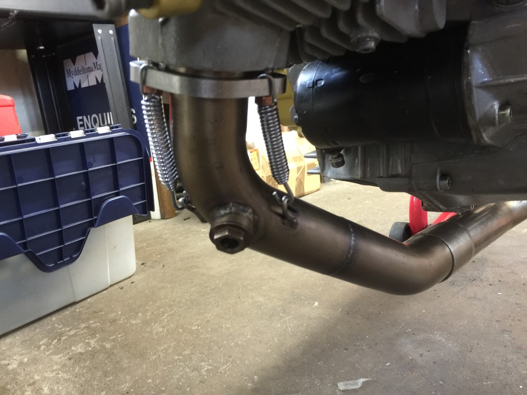

    Stainless headers:
    I couldn't resist:
    Yorkie

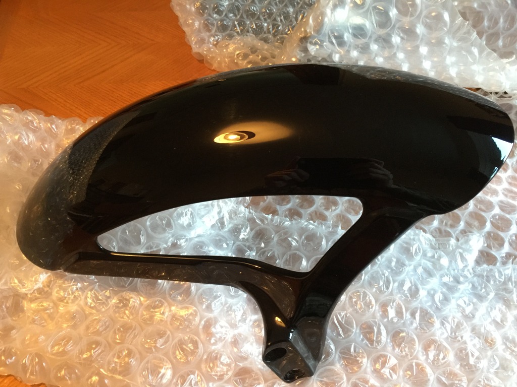

  16. I trimmed down a carbon fibre (damaged) front mudguard today.
    I hack sawed off the damaged parts:
    Then I sanded off the front area:
    Not sure which bike I will use it on yet.
    Yorkie

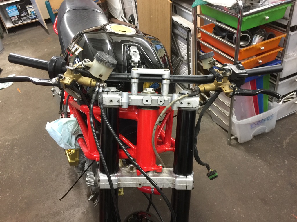

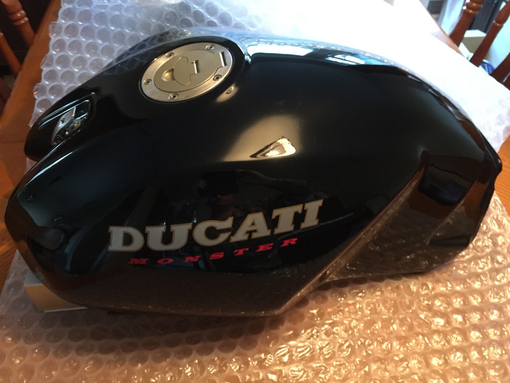

  17. Did a little more today, although the fuel tank needs to be redone as the decals are not right yet.
    Flat drag bars:
    In a couple of weeks the loom will be put into position.
    Yorkie
  18. The loom has been started, and the back end of the electrics completed (ish).
    ECU in place and bolted down:
    Fuse box and relays fitted:
    The carbon mount, now full of holes:
    Yorkie
