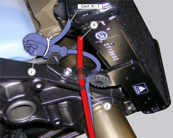

    Here is a pic from the manual with the original installation which had broken at the cable tie.

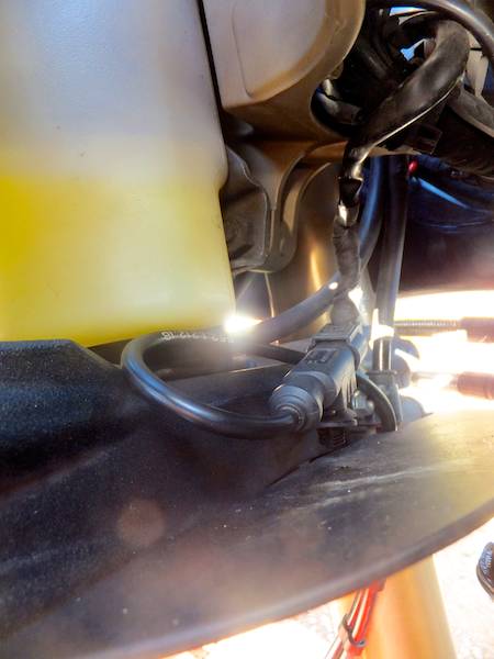

    And this is a picture of how I refitted it with the connector the other way round.

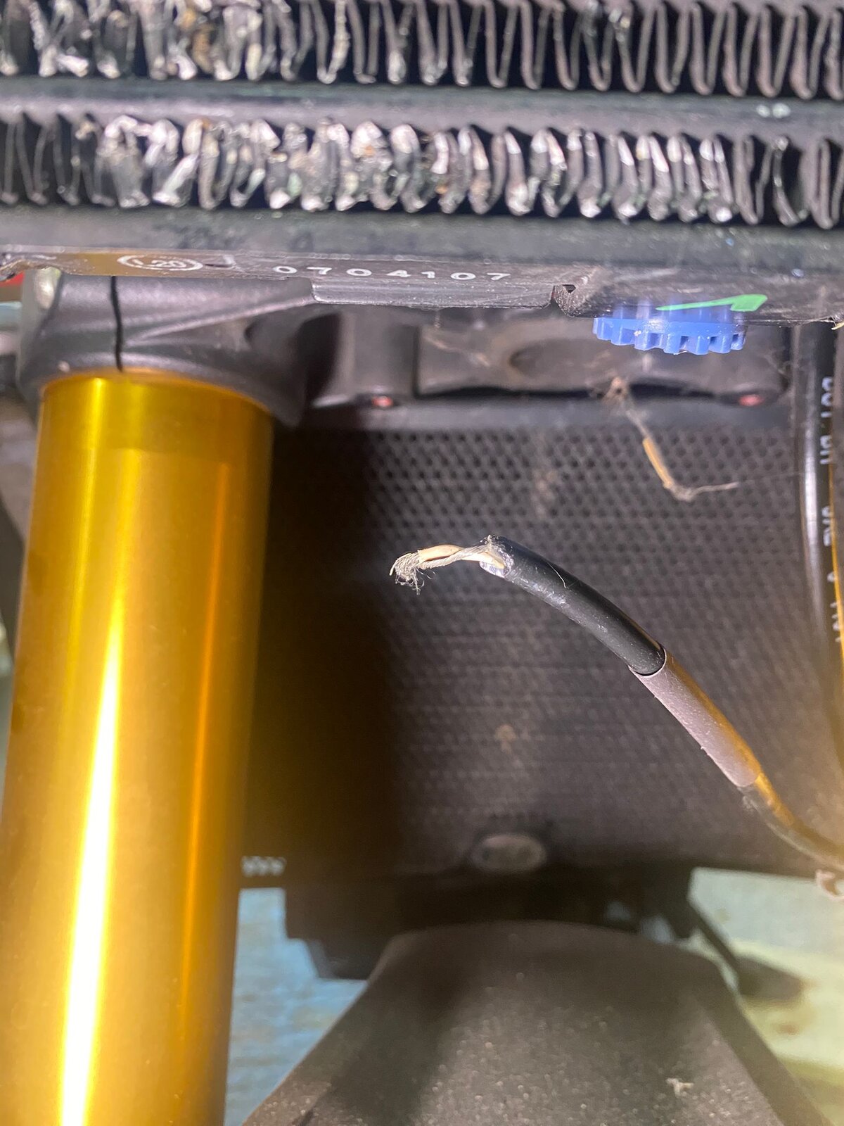

  7. Thank you very much for this topic! I have the same problem now. Gonna try this fix today.
  8. Thanks for this useful post. After owning my Multi for ten years this fault has cropped up in the last year. I’ve carried out your repair and my bike is back to its wonderful self During the time I’ve owned this bike I’ve also had 2 Triumph Explorers and a new Africa Twin. All of them fantastic bikes but all gone whilst this bike stays. I’m about to pick up a new V2s Multi but as with the others, the 1200 is staying until I’m convinced.

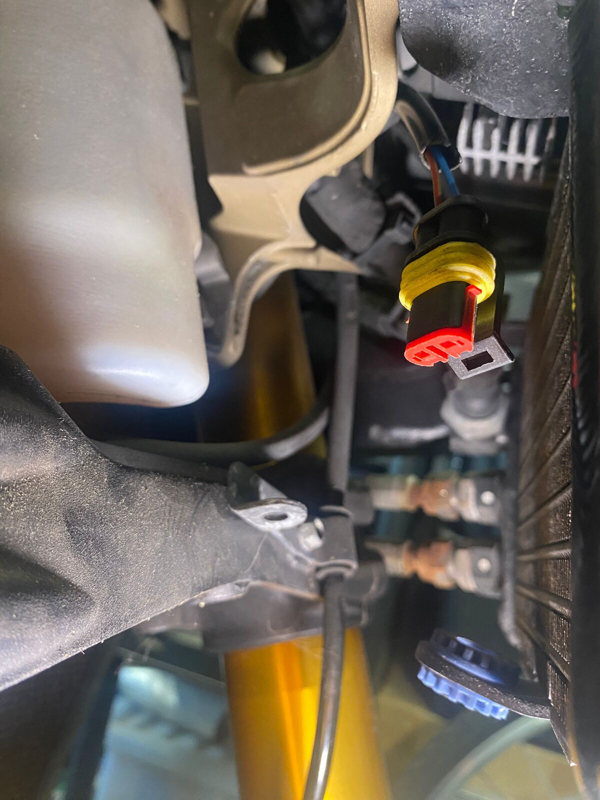

  12. I’m currently in the Picos, had the traction control come on & off for no apparent reason (constant throttle, not loose ground) then DTC off….. I’m guessing I need to hunt the break when I get home!
  13. 10 year old post, but still relevant in 2023. :) My MY11 currently has this exact problem while I'm on a 3 day trip. Will have a look when I'll be back home...
