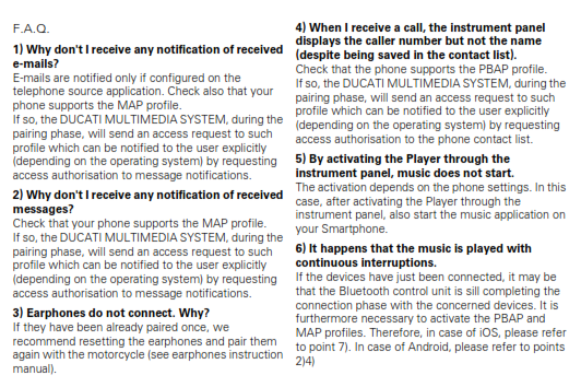

    The F.A.Q. section in the owner's manual:
    I haven't found out where on Android to explicitly confirm that PBAP (Phone Book Access Profile) and MAP (Message Access Profile) are both enabled however I assume they refer to Contact Sharing and Message Access which are shown as enabled on the Bluetooth connection on the phone.
